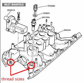

Wanted to post a message and then saw a bolt size tread already here...
Do any of you know the thread sizes of these two?
I want to blank these off but need to know which sizes so I can buy the bolts.
Thanks !
Posts: 4067
Gauge temperature sensor will probably be an odd thread. 3/8" NPT or BSP or something
I think the other ecu temp sender is M12x1.5
