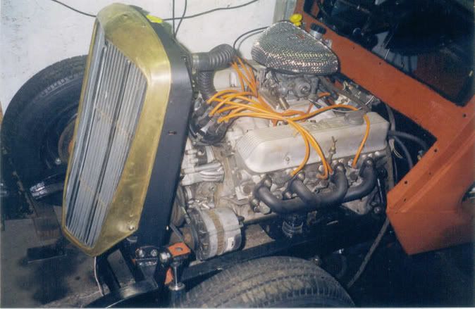

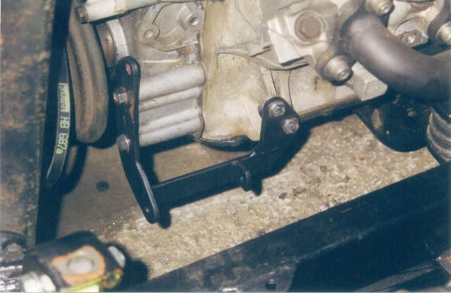

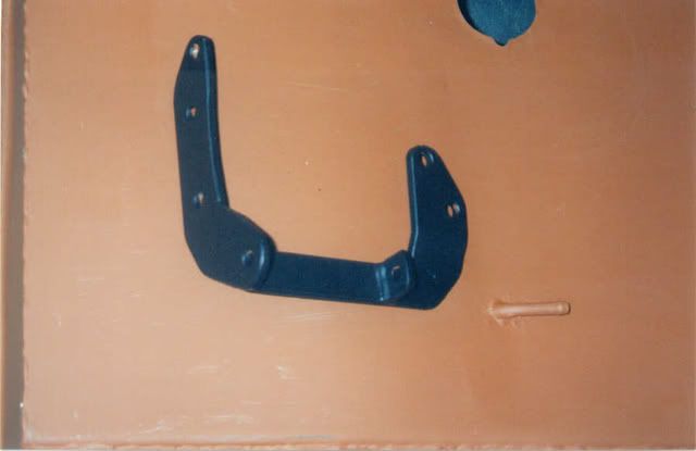

Here's the one I made, to fit a Fiesta alternator, but if you can buy a suitable one for £18 I'd not waste a whole day fabbing something up.chodjinn wrote:yeah that's the sort of thing, but I've found a guy that'll do them for £18 so half the price of pop browns!
