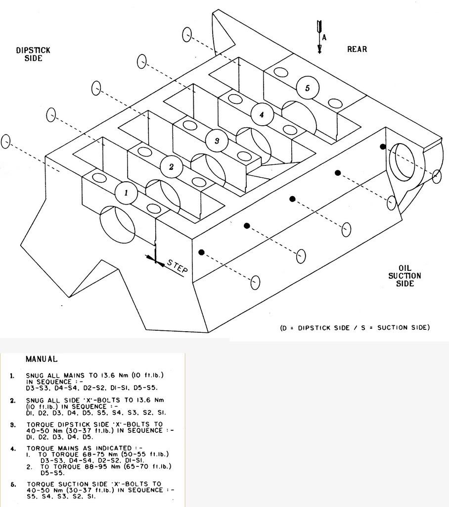

Hi do you do the X-bolts 1st then the end caps of the other way.
Also what the correct torques for a large journal X-bolted block.

Thank you,
but can you post a slightly bigger version.
