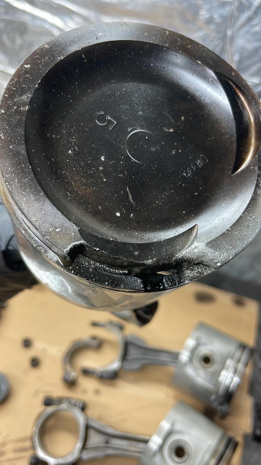

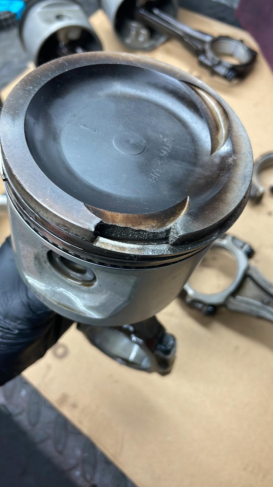

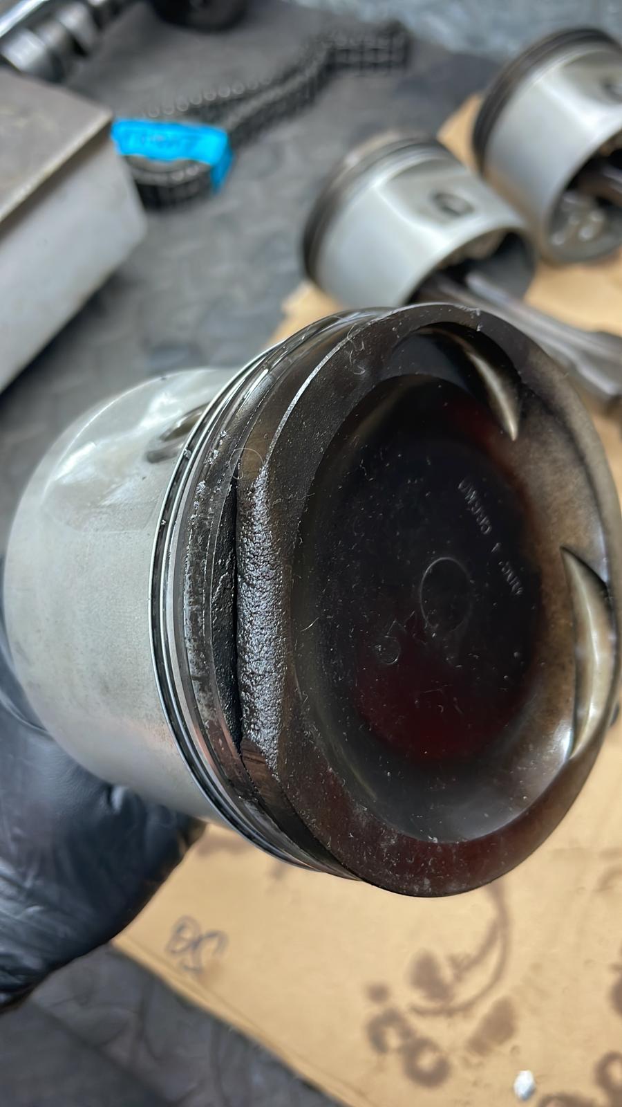

Re: Forged pistons and rods
Here’s some pictures of the pistons.
I'd say just detonation.
Lean melting I'd usually more associate the sides of the piston melted too. But again, under what circumstances did it happen ? normal on load ? low rpm ? high rpm ? or on a rev limiter ?
As you say rods are also bent ? Cast pistons even if a pretty good design, are more fragile when it comes to detonation.
Also high/low is relative. I doubt I'd do any boosted engine much under 9.0:1 these days unless it was either very high boost or limited to poor fuel.
I don't think I'd ever do anything down around 8.0 or very low 8's. If using good fuel like ethanol or race fuel, you'd easily be well into the 9's or even 10's
I'd always try and find off the shelf solutions though. If you ever need to replace parts in the future, it can be a PITA when everything is custom.
The top pic he shared looked rather melted at the side to me?stevieturbo wrote: ↑Sat Dec 24, 2022 10:45 am I'd say just detonation.
Fuel system/lean AFR? maybe?
Still only the top ring land area.SuperV8 wrote: ↑Wed Jan 25, 2023 8:43 amThe top pic he shared looked rather melted at the side to me?stevieturbo wrote: ↑Sat Dec 24, 2022 10:45 am I'd say just detonation.
Either way, it needs tuned properly.
