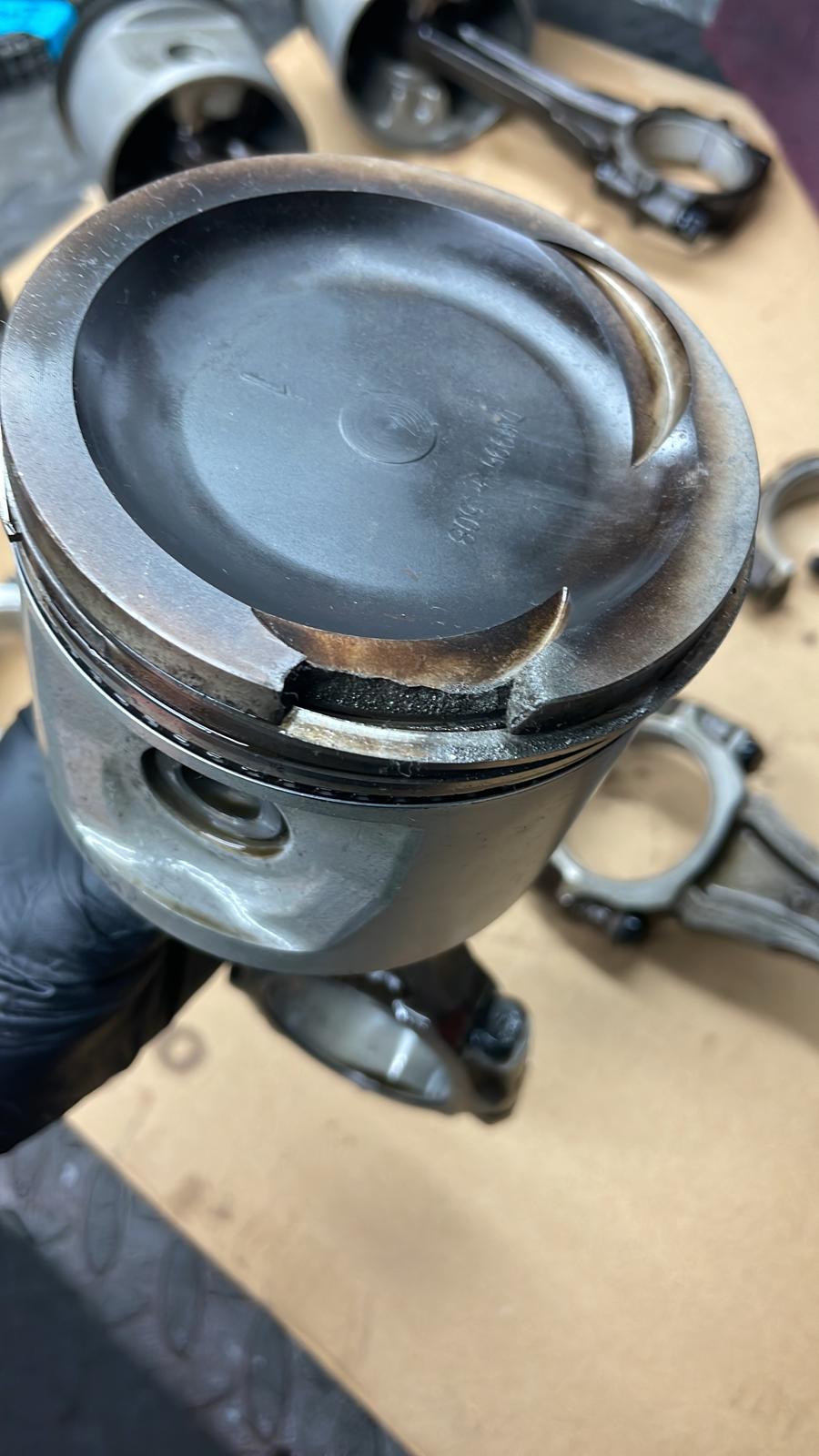

I’m looking at building a 4.6/4.8 top hatted block for a super charged engine.
The current 3.9 has bent rods and melted pistons.
I’m looking for forged pistons and rods. Really struggling to find anything.

I think out piston issues were cause by incorrect fuelling, the rods, unsure of reason.
Previous engine was a 3.9, 8.13 pistons and 36cc heads.

post a picture of damage.
detonation can bend rods and destroy pistons, although usually pistons let go first.
Also depends under what circumstances it happened. Some rev limiters can also be harsh on rods.

Here’s some pictures of the pistons.
Real steel don’t offer the stroker kit, but this would have been high compression.

I'd say just detonation.
Lean melting I'd usually more associate the sides of the piston melted too. But again, under what circumstances did it happen ? normal on load ? low rpm ? high rpm ? or on a rev limiter ?
As you say rods are also bent ? Cast pistons even if a pretty good design, are more fragile when it comes to detonation.
Also high/low is relative. I doubt I'd do any boosted engine much under 9.0:1 these days unless it was either very high boost or limited to poor fuel.
I don't think I'd ever do anything down around 8.0 or very low 8's. If using good fuel like ethanol or race fuel, you'd easily be well into the 9's or even 10's

stevieturbo wrote: Sat Dec 24, 2022 10:45 am I'd say just detonation.
The top pic he shared looked rather melted at the side to me?
Fuel system/lean AFR? maybe?

Posts: 4076
Re: Forged pistons and rods
SuperV8 wrote: Wed Jan 25, 2023 8:43 am
Still only the top ring land area.
Either way, it needs tuned properly.
