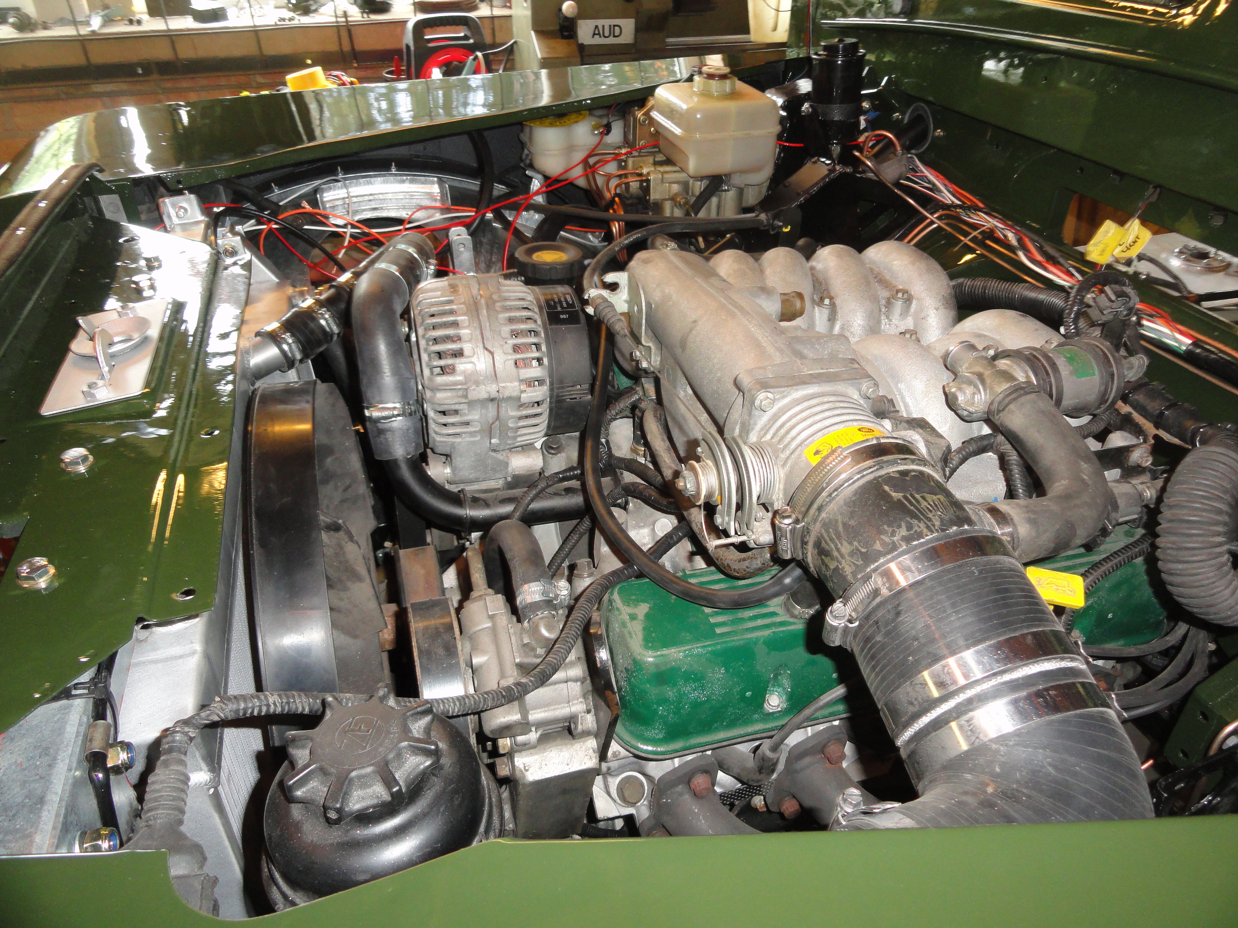

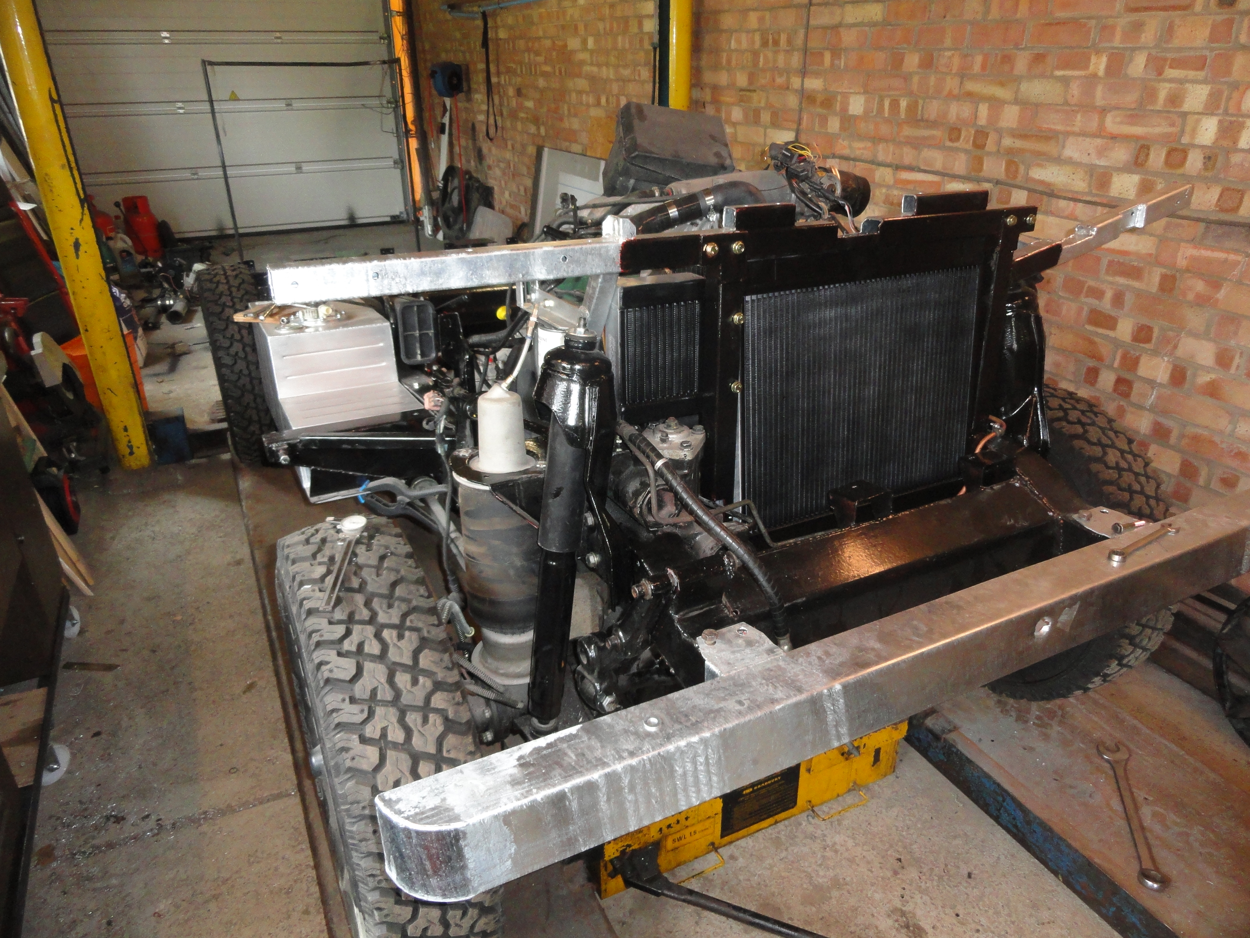

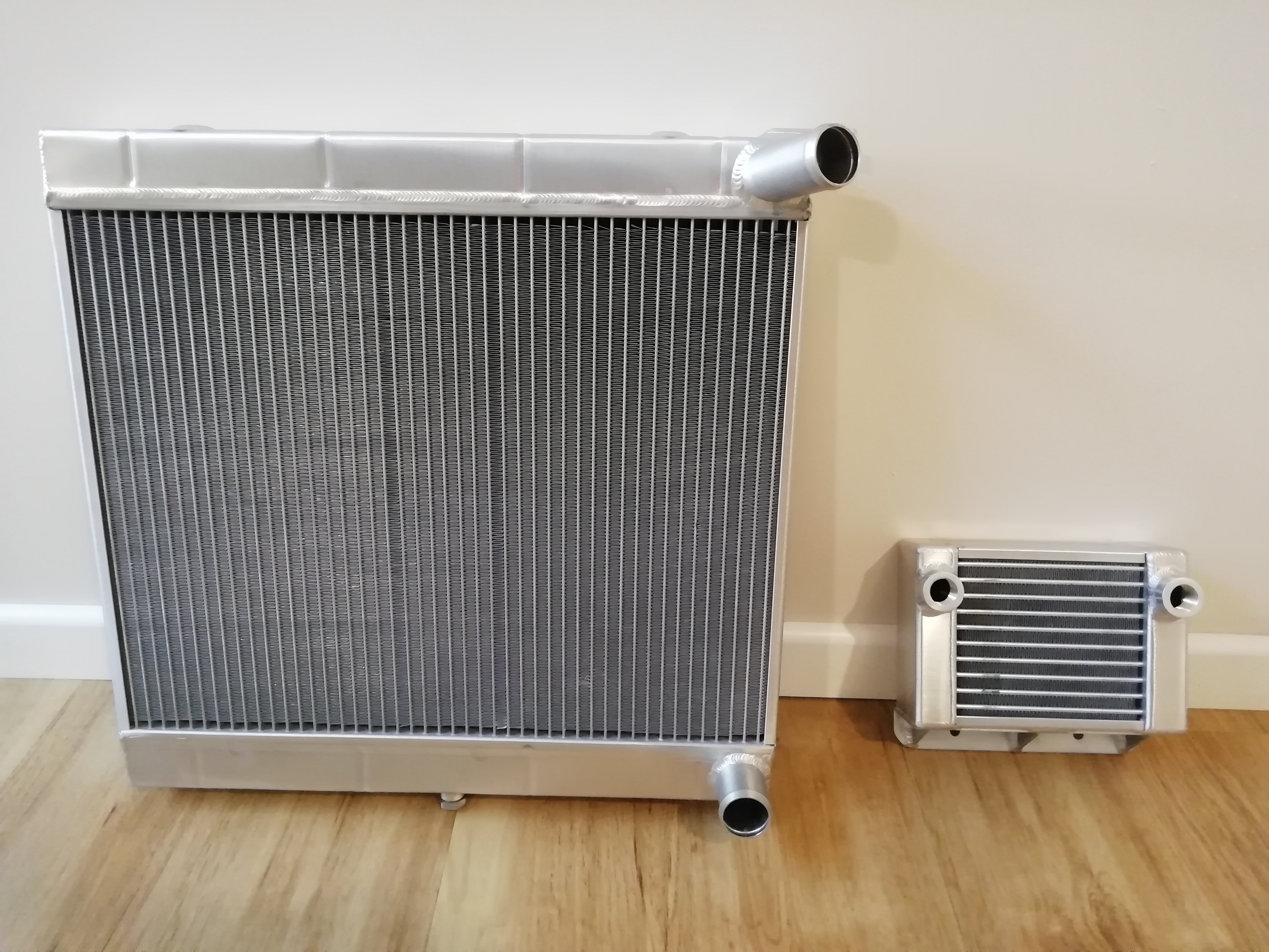

I think I would rewind a bit and ask the silly questions!
1. Do electric pumps flow more than conventional pumps? If so, how much more?
2. Under normal conditions, the cooling shouldn't be marginal - it ought to have bags of spare capacity for those hot days / mountain climbs / towing caravans etc.
3. My Landie (4.6) has a radiator that is only marginally bigger than the 17" Range Rover cooling fan (the black one with the ring connecting the end of the blades). The cooling circuit is copied exactly from a P38 Range Rover. The cooling is fine.
4. Do you have an airflow problem instead?, i.e. for whatever reason not enough air goes through the rad?
Some pics attached of what I have.
