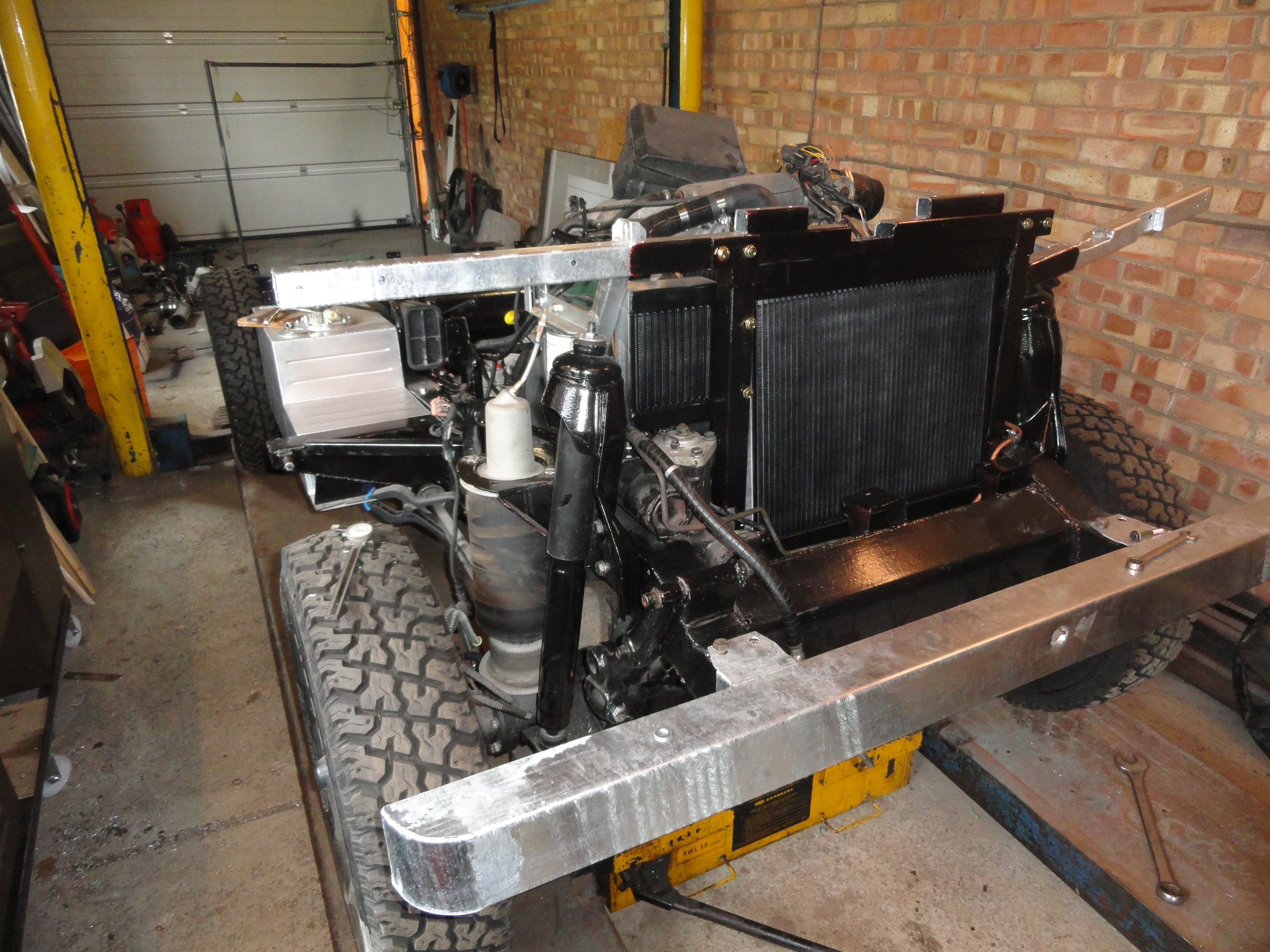

3. My Landie (4.6) has a radiator that is only marginally bigger than the 17" Range Rover cooling fan (the black one with the ring connecting the end of the blades). The cooling circuit is copied exactly from a P38 Range Rover. The cooling is fine.
4. Do you have an airflow problem instead?, i.e. for whatever reason not enough air goes through the rad?
Some pics attached of what I have.
