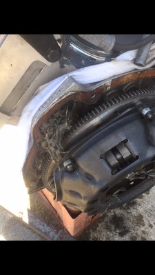

I had the 10.5 Mcleod clutch for years on mine,BUT ,there's a limit,I found that,and now gone to a ceramic clutch,
Organic are good to about 400lb IMHO

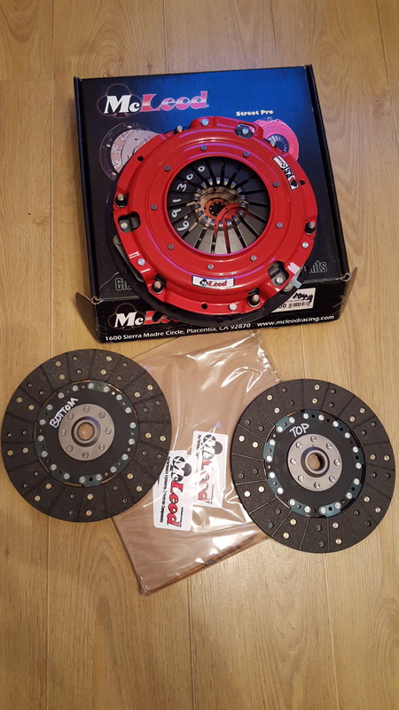

Running Mcleod RST twin plate set up in mine,
nice on the road to use just like standard clutch,
The attachment c8.jpg is no longer available
The attachment c3.jpg is no longer available

The remains of my double clutch !
