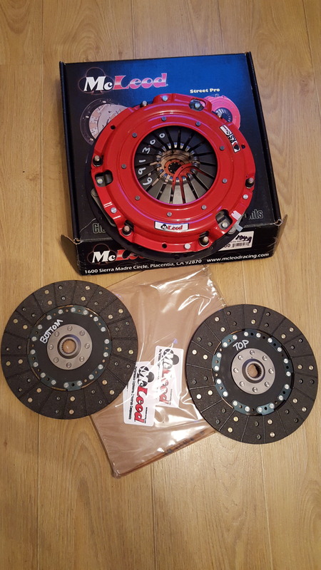

Running Mcleod RST twin plate set up in mine,
nice on the road to use just like standard clutch,

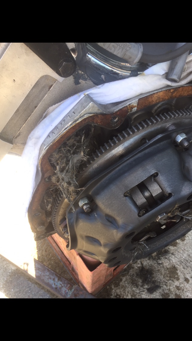

The remains of my double clutch !
