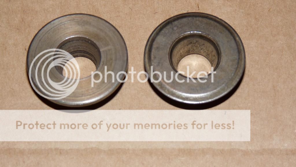

In one of the RV8 tuning books it states that early SD1 valve spring retainers are better than those used in later models, is there a way to ID these ? I have a pair of early SD1 heads to take them off to fit to my 4.6 heads, here is a pic with the SD1 on the left and the 4.6 retainers on the right, the 4.6 has a lower area on the outside of the top, the SD1 ones are 20 grams and the 4.6 19 grams.

I think that the one with the ridge around the edge is made using sintered metal, (I think!). The other is machined out of a solid lump which makes it stronger. You can also see the machining marks on the solid one. I use the older ones in my 4.6. They also seem to suit some of the double valve springs better because the inner spring will sit on a flat seat. I have seen some inner springs that are a fraction too small to sit on the retainer properly.

Yep the ones on the right are what TVR fitted to their double sprung RV8's a right bodgesidecar wrote:I think that the one with the ridge around the edge is made using sintered metal, (I think!). The other is machined out of a solid lump which makes it stronger. You can also see the machining marks on the solid one. I use the older ones in my 4.6. They also seem to suit some of the double valve springs better because the inner spring will sit on a flat seat. I have seen some inner springs that are a fraction too small to sit on the retainer properly.
When you say "use them" which ones do you mean?Devonrod wrote:Thanks for the replies, I think I will use them then, I only have single valve springs, a set of Real Steel DW060 that ive had for years, I don't think they sell them anymore. Its only a mild engine anyway, I was looking for strength rather than breaking at high revs !
I will use the SD1 ones, my very good friend Devonman on here donated a set of good heads to my project after I repaired mine only to find them warped !sidecar wrote:When you say "use them" which ones do you mean?Devonrod wrote:Thanks for the replies, I think I will use them then, I only have single valve springs, a set of Real Steel DW060 that ive had for years, I don't think they sell them anymore. Its only a mild engine anyway, I was looking for strength rather than breaking at high revs !

For what it's worth, yes, the retainers with the step are sintered and I wouldn't use them if you want to rev the engine. The Crane Chrome Moly we have had a few breakages with these, they split straight across the middle. Touch Wood, since we went to the SD1 type we have had zero issues and the engine has seen in excess of 8000 rpm at times. Unless I find something really good in the aftermarket I will continue to use the earlier Rover retainers. Regarding using with a dual spring we did see some slight interference with the inner spring but were able to touch these up on the lathe for s snug fit. Beware though the material is VERY hard!
