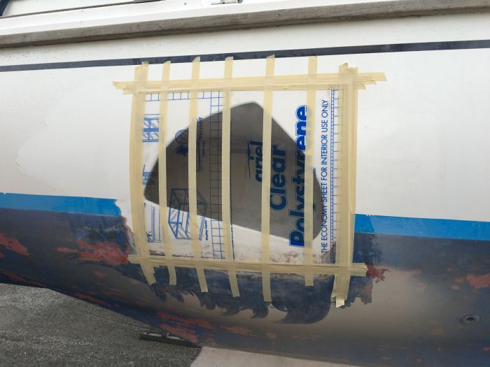

If I am out on site and need to cut a hole or trim something I use a Fein Multi Master as these are fantastic and versatile bits of kit and now not that expensive but glass does tend to bugger the blades fairly quickly.
Used a MM on this very recently
And used masking tape to hold the former in place!
A slightly bigger gel repair for this yacht :lol:

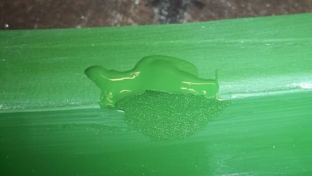

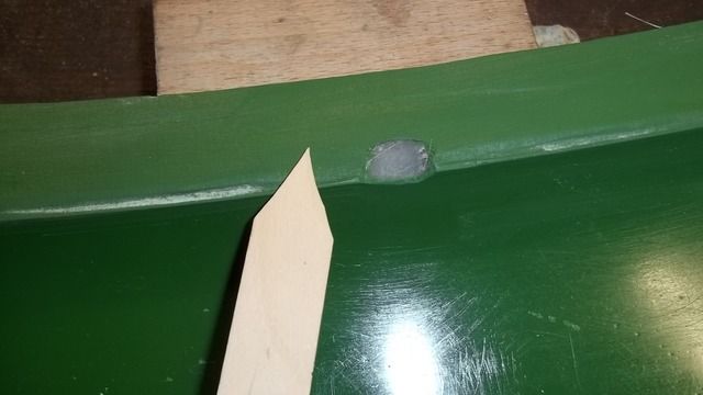

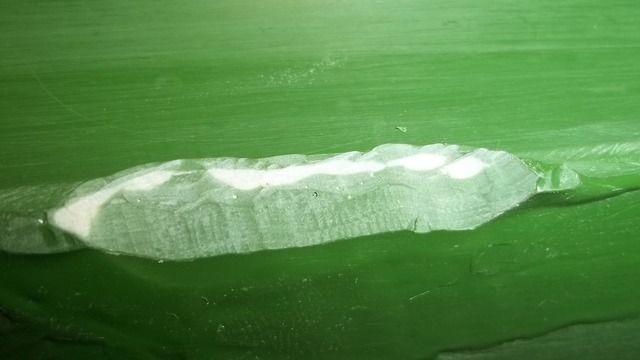

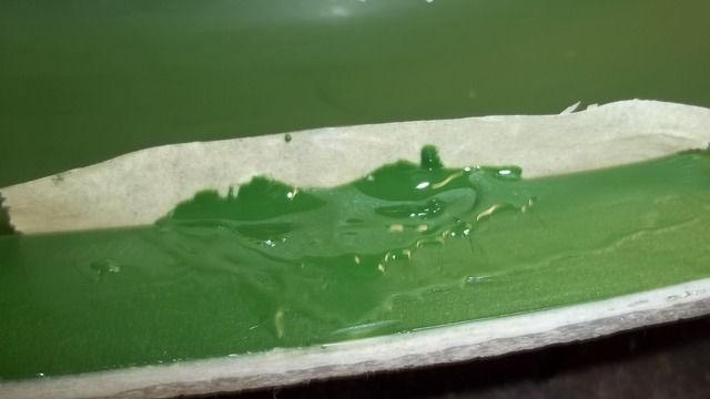

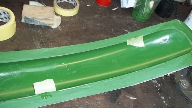

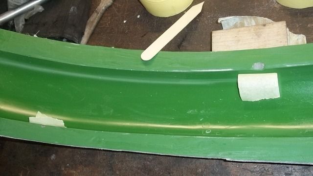

Every day is a school day and I made a couple of mistakes. The main repairs on the mould above worked out okay - this was the worst of the errors - I did not make sure the whole area was covered and I set the masking tape down to firm - the texture should sand out and the inclusion is very very small.
However - I thought while I had a bit of gel still in the pot I would "improve" a couple of area's on the other mould - Rushing, the application of the masking tape was even worse on this mould and again - only worse - I did not make sure a had covered all of the repair area with gel - The masking tape created a bridge and so prevented the gel from covering the lower part of the repair. This actually made matters worse than before I tried the repair.
So out with the die grinder to scuff it out and apply some more gel - a blob mixed up on a filled pad. with a single drop of catalyst.
This time I made sure that the entire repair area was covered in gel before I set the tape in place and I also made sure that the tape had a bulge over the repair. Having to spend a few extra minutes sanding is infinitely preferable to having to chop out, mix apply and wait another day.
We will find out tomorrow if I got it right this time around.

Out of curiosity - how thick is the gel coat and the laminate on something like that?

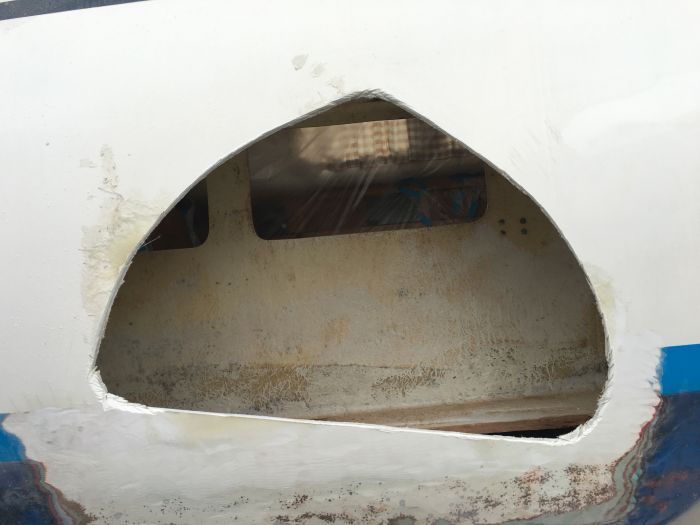

Paul, how much and how far back do you need to cut back behind that hole for the laminates to adequately build up and allow for adhesion?
gelmonkey
Sergeant Monkey Face
Posts: 1307
Location: plymouth
Post by gelmonkey »
The hole in the yacht was a bit of a challenge as the only access available was through the locker holes that you can see in the first picture.
Laminate and gel thickness on this an old Westerly was approximately 7mm so not massively thick.
With regard to how much and how far back do you grind the general rule of thumb is two thirds bigger than the breach where possible.
This allows for a techinque called back grinding which in simple terms means that you have to chamfer grind from a very thin edge around the breach back to almost no material removed at the outer edges.
In this instance the floor of the locker was cut out so that the laminates could be feathered out over the ground back area and then the floor was reinstated.
Thank fully there was just enough room to go upwards to just underneath the deckhead and all was good in the end.
Without question this was a structural repair and it was imperative that the Lloyds register specs were followed as closely as possible so that the craft was returned to a safe and strong condition.
Hope this answers your questions guys?

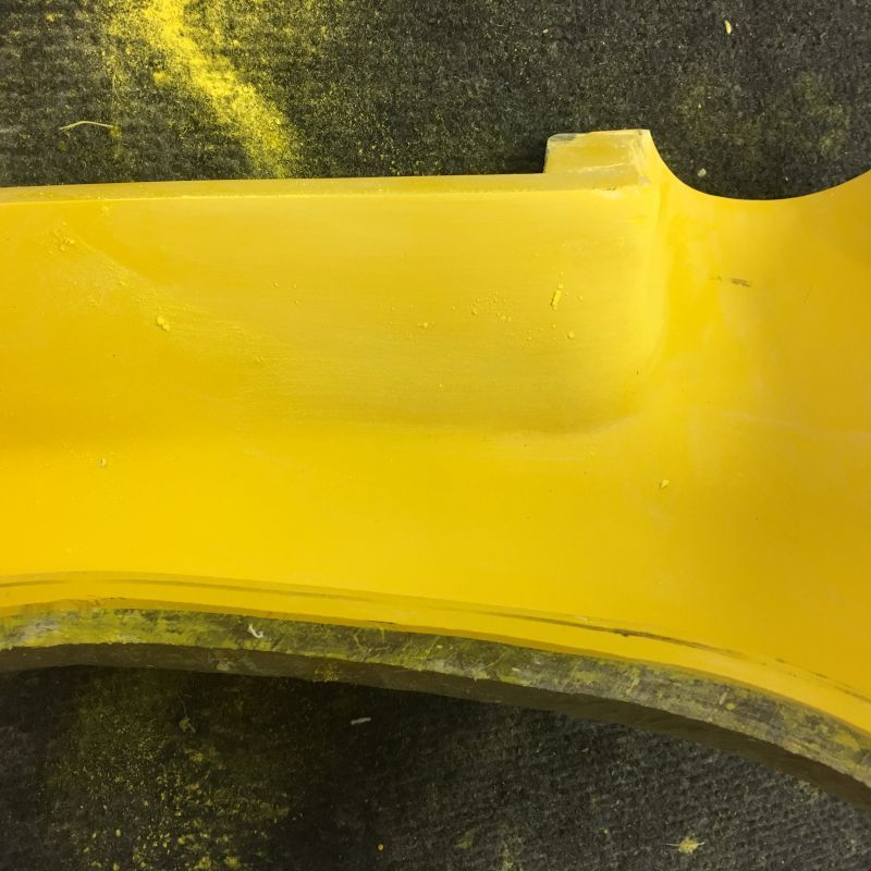

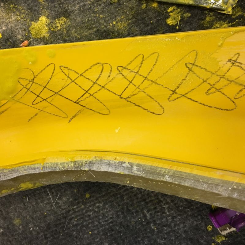

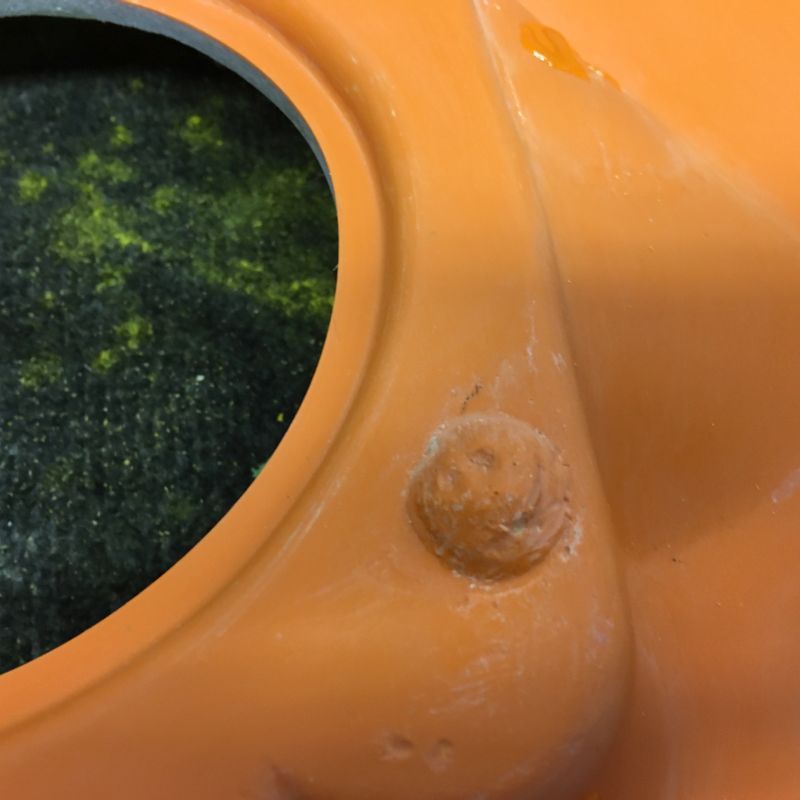

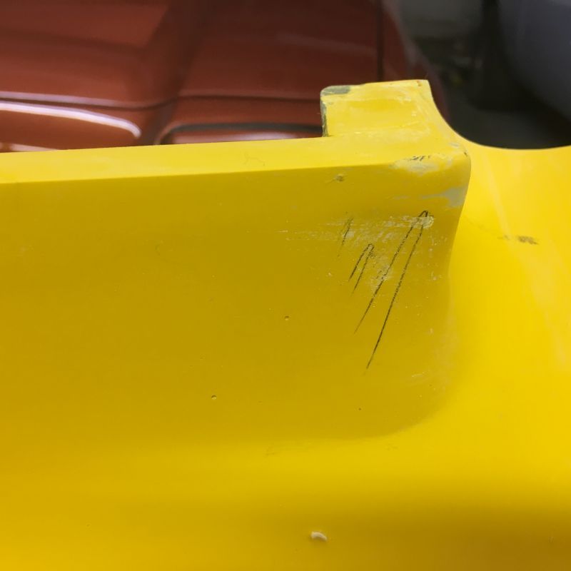

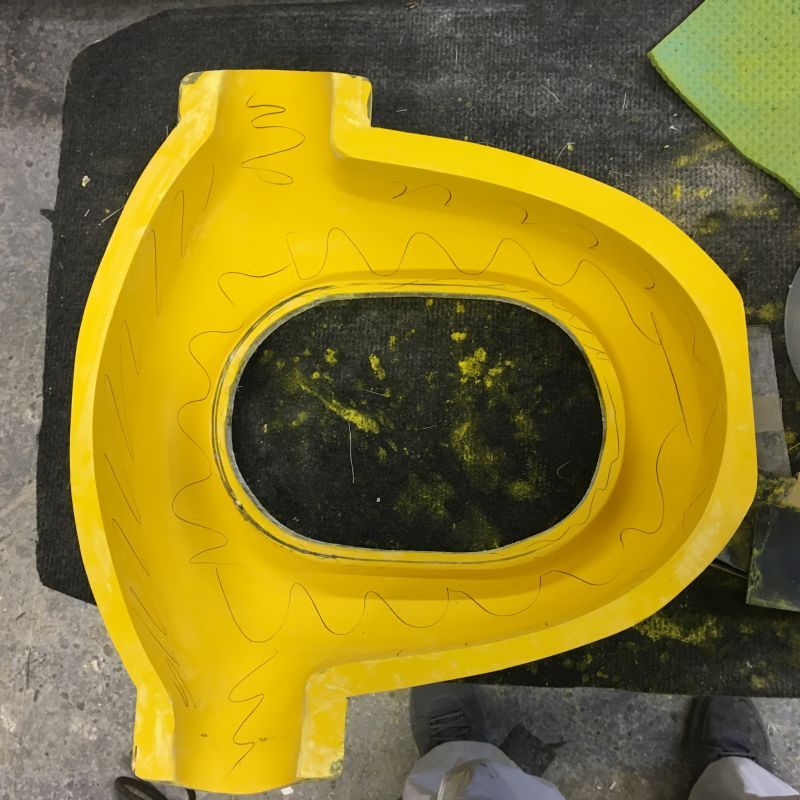

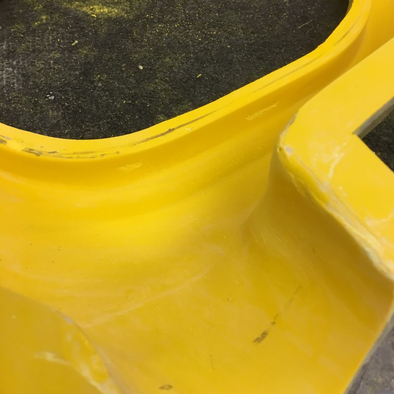

As the plug was never final finished because I was impatient to get the moulding started I knew I was going to have some flatting back to sort out once the mould was released.
So scribbling around the internal faces of the mould with my black pencil it could clearly be seen where attention was required (it all needed a flat back but some areas more so )
The original sanding marks can be seen easily here so a couple of hours were spent flatting back with 400 and 1200 to get a really nice surface finish and then as explained the other day a final scribble with the pencil to double check that all was good .

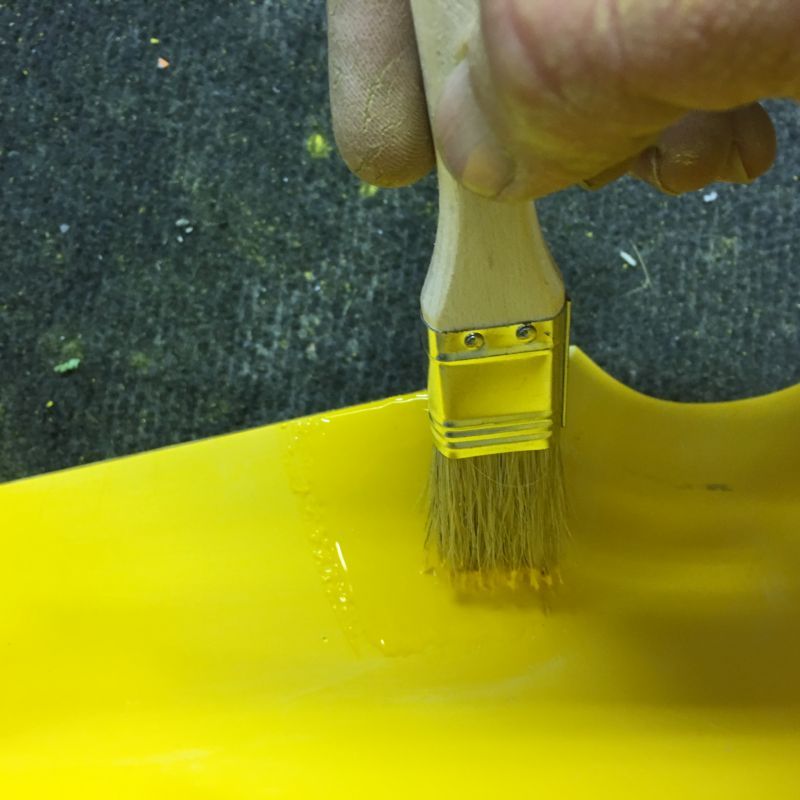

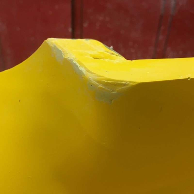

Since it will be impossible to glass this whole lot in one go I have to make sure that the important release areas are perfect so with that in mind these areas shown below could potentially cause a problem.

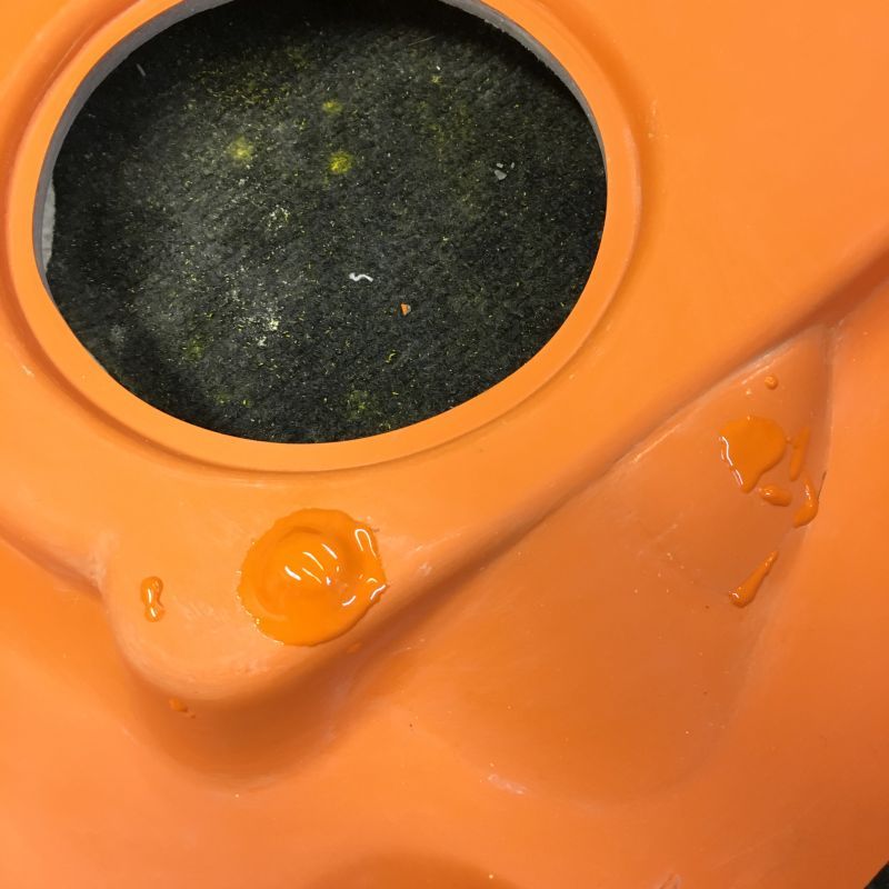

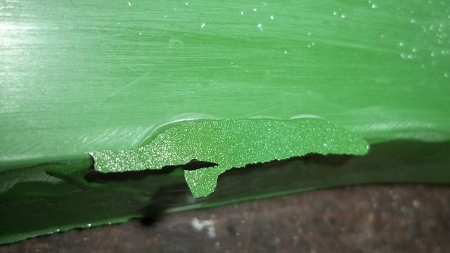

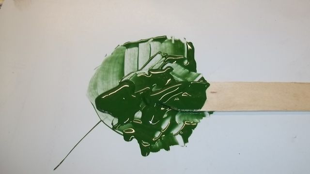

To get around these little issues I needed to make them good with more gel so I keyed up with 60 grit and then painted gel onto the surfaces.
With any 'paint in ' it is vital that the keyed area is much bigger than the repair site itself as the gel need to be flowed out to almost the keyed edge and with at least two coats being applied.
Reason being is that when flatting back you need to have the all important throw on your sanding block and also to fill up the hollow or imperfection or whatever it is you are repairing.

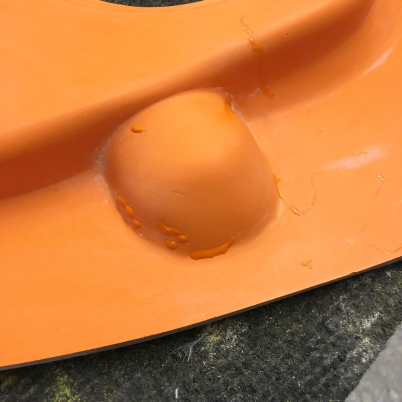

A few smaller other defects had to be dealt with including the small lip at the bottom of the mould which caused me the initial release problems.
Most of it sanded out but these two areas where just a little bit too deep to sand back and yet still keep a uniform shape.

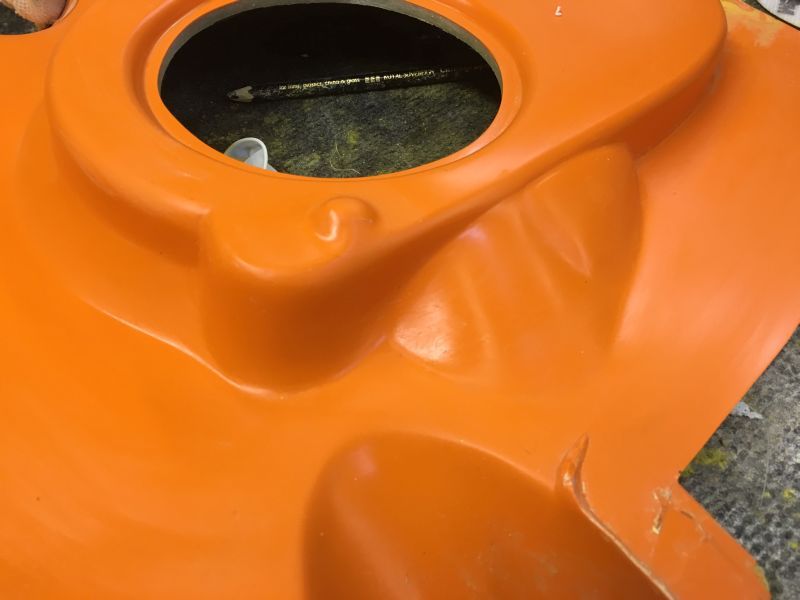

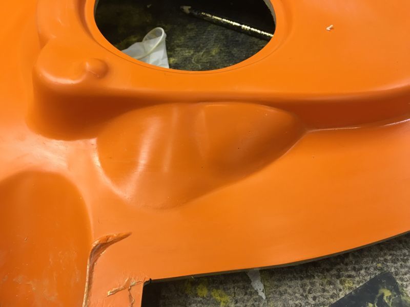

After thrashing my son to within an inch of his life for taking the orange pigment ( he said he needed it for a proper job and not my p*ssing about in the garage crap ) ( how rude :shock: ) I finally got to repair the small bits on the base section mould.
The indent for the accelerator pump was hideous looking once released so the easy way to deal with this was to key it with a Dremel and then just simply blob the gel on top and let it flow down over the shape so that when it comes to sanding back all I should have to do is lose the edges.
Like it?
Work smart not hard :D
The other small bits simply needed a few minutes attention.

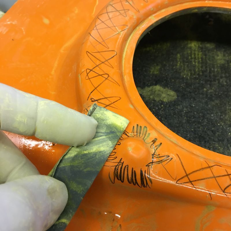

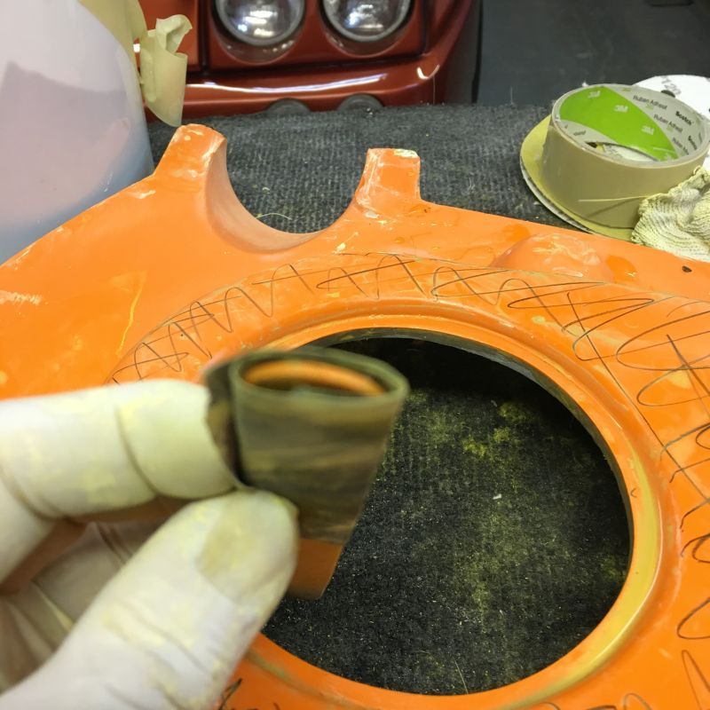

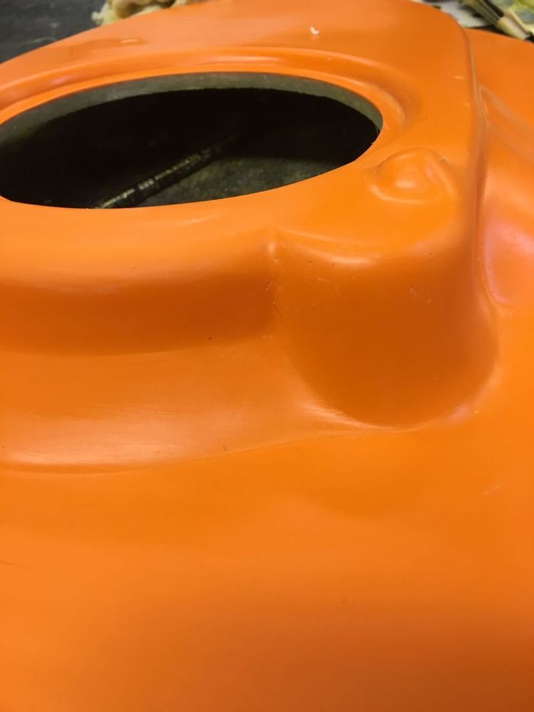

Having gelled the repairs on the base section it was time to flat them back.

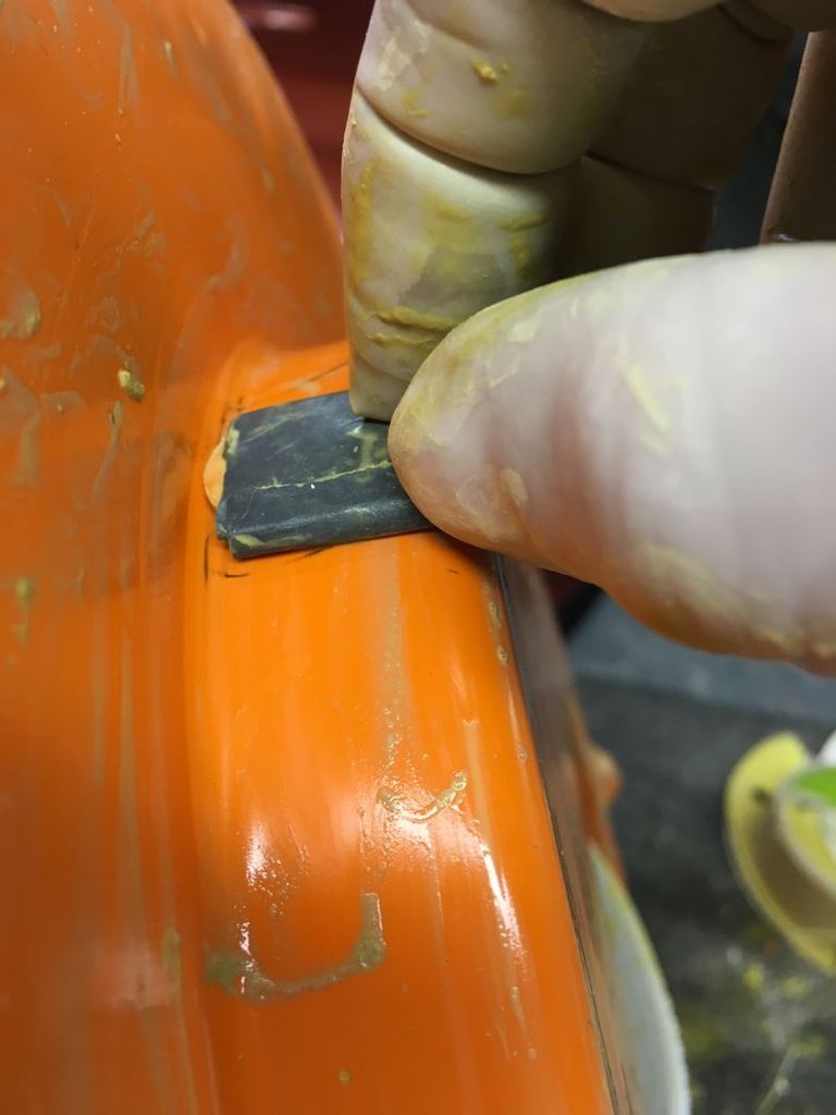

The question is how to rub these down but not make finger tracks or alter the shape by rubbing too hard and struggling to get a block in to the corners .
The radii are also of concern.
There are some tricky areas here but they can be sorted no problem
This is how I tackle the issues.

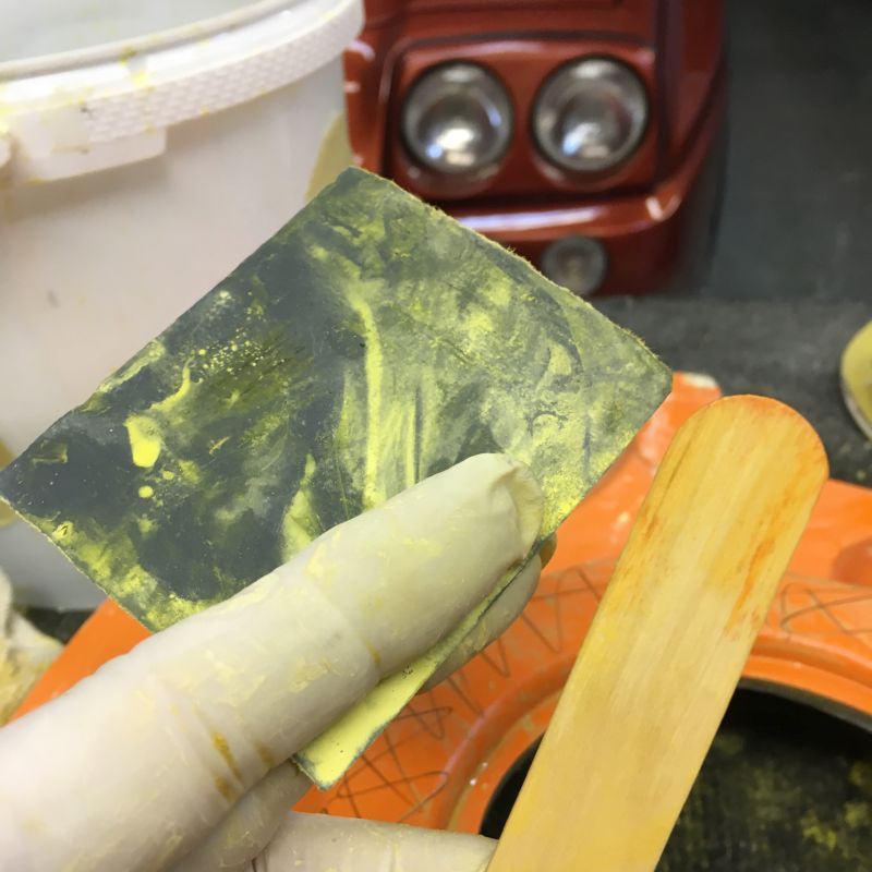

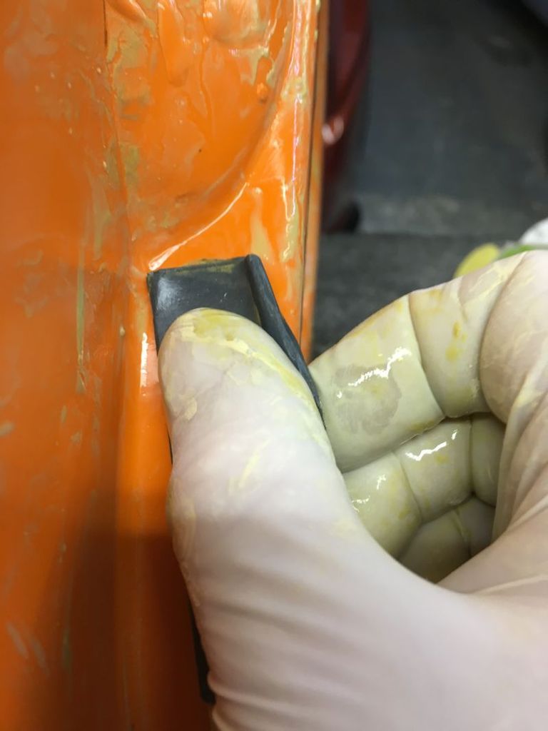

1 Take a section of paper and a wooden bat.
2 Wrap it tightly around the bat and then get it wet.
3 With the repair site marked up it was just a case of working away with the bat and as it is so small and thin it can be worked into the awkward areas with ease.
In the last picture you can see that the bat is slightly lower than the paper and there is a reason for this.
As I had spent some time getting the radius right at the base I did not want to mess these areas up so by extending the bat through the paper you create a stop so all you are rubbing down is the flat face and not cutting a groove with the paper on the radius.
Using this method also allows for you to get right into the corners whilst allowing you to see where you are working.
Working away methodically and with lots of water you eventually end up with great looking repairs and all corners radii and flats exactly as they should be.
I just have a small amount left on the base plate to do now so all is looking good .
