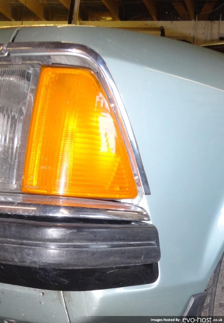

Although would probably add....because the wings bolt on etc, and I've just taken a direct external mould of the shape.
In order to achieve any decent fit from that, certainly around the mounting areas the new composite panel would need to be almost as thin as the original steel panel, otherwise it will make fitting more difficult.

How does it contour into tricky shapes ? ie part of my mould includes the shape of a chrome trim
ie I want to mould the wing with this chrome trim intact ( and likewise if I make a new bonnet will do same )
Mainly as these chrome parts are no longer available, so at least if shape is integral to the new panel, I can stick some chrome tape over the top to replicate the piece
