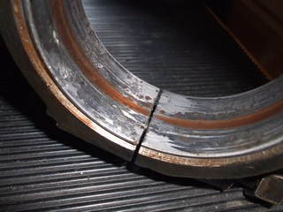

Redders wrote:ok, another update, took all the NGK spark plugs out and re gapped them 0.80 mm, they were all wet and smelling of petrol, I still dont think its a fuel issue. applied the taco strobe and adjusted the timing 10 degrees BTDC with VAC pipe on and done it again with it off... still no different.
What I have noted, that the sump appears to have increased in level, smells like petrol mixed in with the oil. :cry:
With all that cranking and pouring fuel down the carb - i suspect you have indeed got petrol into the oil - especially if you were cranking it long enough to burn the starter out.
I would *Strongly* suggest you change the oil immediately otherwise you risk wrecking the bearings.
Also check your float levels to make sure the carb isn't simply dumping into the engine - and only give it a pump or two on start up, no need to keep repeatidly stabbing the throttle, it squirts a fair amount of fuel in each time.
Here's the bearings from a 440 big block that someone had spent weeks trying to start, filling the sump up with fuel:
The oil came out like water.
