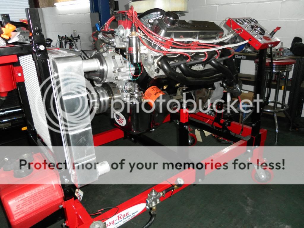

I build Ford V8 engines every day of the week, I have 13 here at the mo from stock rebuilds to wild strokers.
This is a 408 stroker ready for it's first fire up.
This was a mild 347 stroker.
And this is a fairly wild 347.
