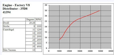

I built up an ignition table based on some figures I had for the DLM v8 distributor as a starting point which put the advance at 20° at idle (not wanting to simulate ported vacuum). This ran OK but did give some issues with stalling. This was also evident with distributor but not quite as bad.

The figure you are using is around the standard value used with a distributor when using ported vacuum, if you used manifold vacuum it would be higher BUT as it is the standard value the engine should be happy enough with it, should run fine and the idle systems (bypass and stepper) should work. In may case none of these work properly until I have the higher value. Even when I had 20° at idle it was not happy.
I'm wondering if the cam may make a difference to my setup as that's the main thing which is different on my engine, unfortunately it's a bit of an unknown quantity as I bought the engine with this in place.
Thanks for the tip on adding photo's, thought I'd been able to do it previously.
This is the information I used for the timing curve

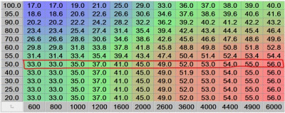

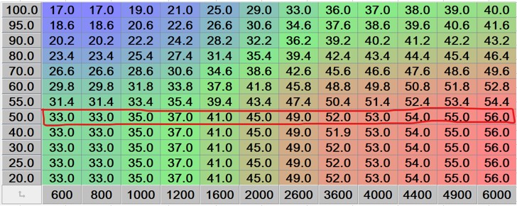

And this is the table I'm currently using. The red highlight indicates the kPa row which is being accessed at idle.

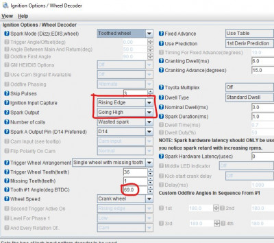

The MS picks up from a 36-1 toothed wheel as you suggest, the gap is placed circa 70° (actually 69) ahead of top dead centre. This is the value I have in the settings for Tooth #1 Angle BTDC as you can see in the graphic below.
The actual location of the missing tooth should not matter within reason as this value acts as an offset. I suppose it may need to be at least as far ahead of TDC as the maximum advance (plus a bit for processing time) which it is.
I think the other options you are describing are the "Ignition Input Capture" and possibly "Spark Output". I did believe this was related to whether it was triggering on the leading or trailing edge of the teeth but not absolutely sure. In any case I believe these settings are as per when the unit was delivered.
However this shouldn't really make any difference as I'm not simply measuring the physical location of the missing tooth with respect to TDC I have checked the point which the spark actually occurs with a strobe. This is initially done by setting "Fixed Advance" setting to "Fixed timing" which triggers at whatever setting is entered in "Timing For Fixed Advance". For setup I put this at 10° so that I could read it off against the timing mark I have on my crank pulley from using the distributor, this was reading spot on. When I re-enabled the table I could see that the timing was indeed triggering at 30°. I don't have a mark on the pulley for this but could see it was around 3x as far as the 10° mark and the teeth on the 36-1 also verified this (at least to a degree or two)
I'm thinking more along the lines of whether there is something specific about my engine configuration which actually requires, or "likes" this advanced timing.

The area I've highlighted in the graphic above at 50kPa is where I am at idle, this effectively light load, the only way I can see of getting a lower kPa is on overrun when I'm not really concerned about the timing as it won't even be firing at higher RPM due to fuel cut-off and at lower RPM it is unlikely to get thre, this is why I've left the advance the same as it is at 50kPa.
The advance 'curve' at the 50kPa uses the same increments as the data I have for the distributor advance curve (I don't know how reliable this is and I don't even know where it came from!), again in the graphic above, but starting at the 35° value as established. In fact I've dialled it down a bit with higher RPM, the range for the distributor works out at 27° I've dialled it down to 21.
At atmospheric pressure, which would be encountered at WoT, the timing values are obviously lower. Again this curve follows the same increments but dialled down by 16°. the data between has a pro-rata decrease in timing to give a smooth transition between closed and wide open throttle.
So not on a dyno but hopefully a little better than 'best guess', let's say "best educated guess"!
The table should give very close to what the distributor would give (albeit I don't know the provenance of the data I've used) although dialled up by around 10° in general but tapering off at higher RPM by 5° - I hope that makes sense, I'll try and qualify it.
The distributor data shows 35° maximum as RPM increases, at WoT this would be the only advance in place, there would be little or no vacuum. In this condition the table I've created would be giving 40° - Not massively different.
At idle the distributor would be running at 24° - 8°initial plus 16° Vacuum - if we remove the ported "bodge", I'm running at 35°. Given that the 8° value seems a little conservative (I was using around 12° with the distributor) I don't think I'm massively different here either.
So really my "issue" and reason for the question is related to why my setup doesn't run well below this figure at idle and why it may need more advance. The only thing I can think of is cam profile as this is the only area where my engine differens from standard.
Unfortunately I don't know what the MAP is like at any other RPM value as I'm currenlty not setup to measure/log this.stevieturbo wrote: ↑Thu Jul 24, 2025 8:50 am At those load sites, what is manifold vacuum like ? Often intake vac is a better representation than TPS, at least in this regard of diagnosing, as 50% throttle opening really doesn't tell much
Bear in mind the row values on the table are kPa not %age TPS, that is not 50%
That 50kPa value is what I'm getting at idle (possibly a little lower) which would represent light load, during normal driving I don't see how the engine can get to any lower rows on the table so this is the 'worst case scenario' for advance numbers, I also don't see how I'd get to the higher RPM columns on this row.stevieturbo wrote: ↑Thu Jul 24, 2025 8:50 am I have run engines in the 40-50 range, but literally only at light cruise, never under any real load.
As the load increases the timing will also dial down due to running higher kPa so I think we're working along the same lines there.
