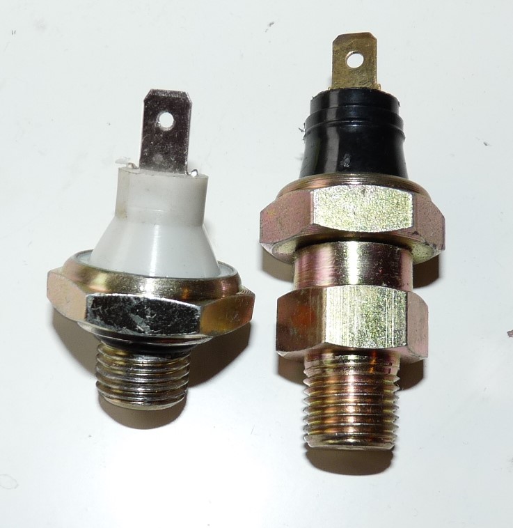

I mean the oil pressure warning light switch, one I had started to flicker at hot tickover, although had oil pressure on the dash gauge also I have a gauge on the oil pump and that was ok pressure, tried two second hand switches but they were also faulty, most of the ones on line seem to have a very short thread compared to the factory ones, in fact the picture of a genuine one at £45.55 ! on rimmers site is the spitting image of the Britpart one, I emailed them and they are insintent its the right part picture even though its nothing like the three factory switches I have !!!

any how went to an autojumble yesterday and got a decent new boxed switch for £2 ! so I am sorted hopefully.
Britpart on the left new one on the right in the photo.

Assuming the thread is the same, I doubt it being shorter makes any practical difference. You'd be best to check the oil pressure with a known accurate gauge. The light flickering at idle with a hot engine - especially with some modern oils - may not be anything to worry about.

One on the right just looks like someone has screwed some sort of adapter/extension on to another switch.

I am having a similar issue with the oil pressure sender, DRC2479, making an adapter to fit the sender and switch together as I did on the 3.9 and wondered why I was having clearance problems. When I looked at the sender on the 3.9 it is a plastic housing not the big steel can of the new one. Google shows both types under the same number. Thinking I will reuse the one from the 3.9 as I know it worked with the guage previously rather than an unknown part.
