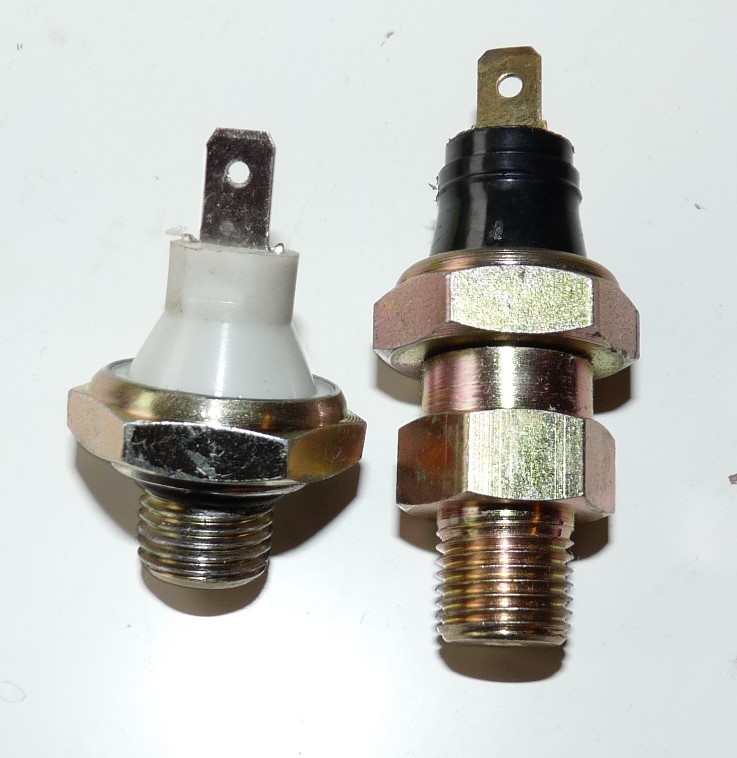

Thanks Stevie, I have a oil pressure gauge on the oil pump and also one on the dash, both show oil pressure when the oil light is flickering.
engine is a top hat 4.6 Turner Engineering short block with 2000 miles on it
as for google search, been searching the net for days, I dont just come on here expecting my problems sorting without even trying, I only ask when I am stumped and cant find the answer on the net or asking friends.
any how went to an autojumble yesterday and got a decent new boxed switch for £2 ! so I am sorted hopefully.
Britpart on the left new one on the right in the photo.

Assuming the thread is the same, I doubt it being shorter makes any practical difference. You'd be best to check the oil pressure with a known accurate gauge. The light flickering at idle with a hot engine - especially with some modern oils - may not be anything to worry about.

One on the right just looks like someone has screwed some sort of adapter/extension on to another switch.
And saying your gauges show oil pressure is vague and meaningless. How much oil pressure is what matters....vs what the switch operates at.
