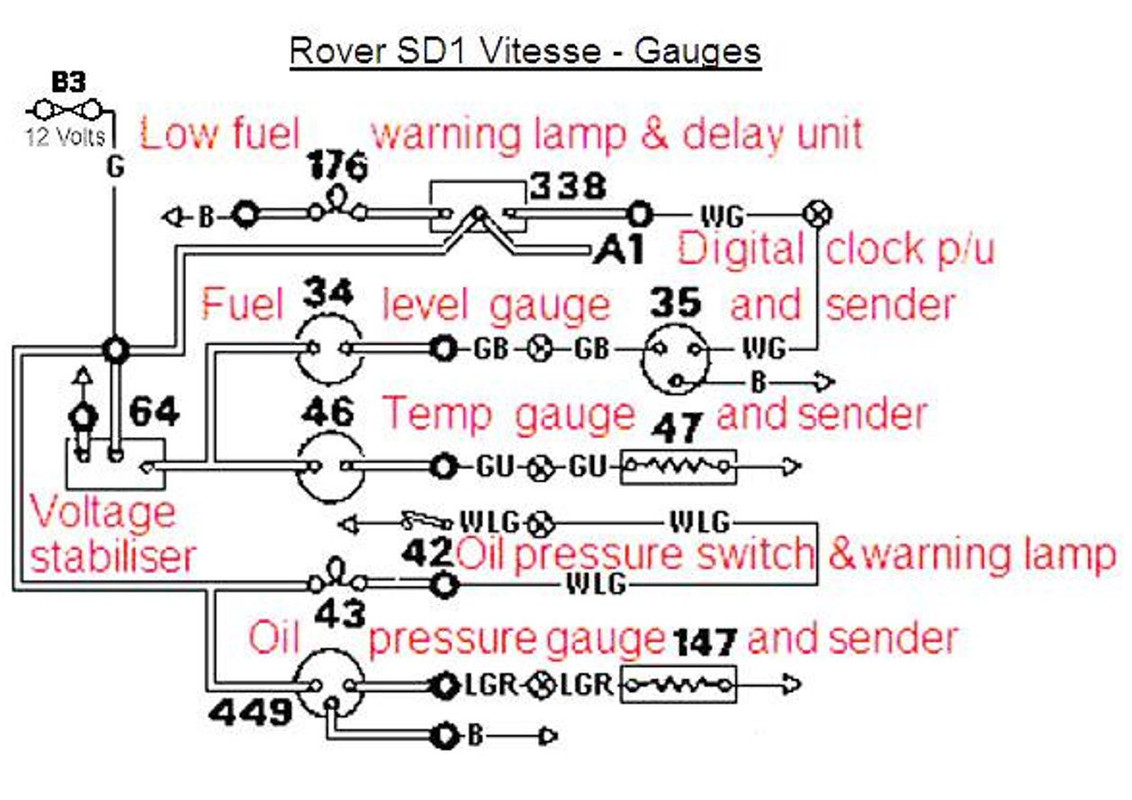

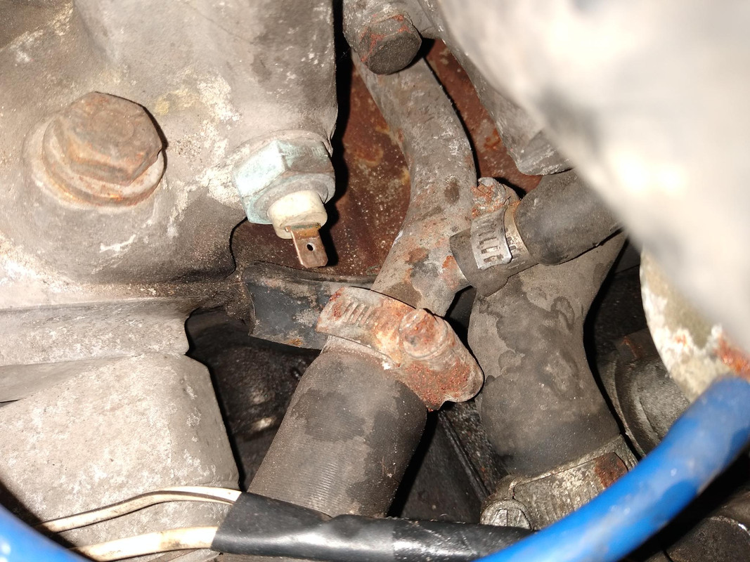

I'm waking up my TVR 350i (RV8 with flapper) after a long rest, the temperature gauge isn't working but the fuel gauge is (both VDO gauges). The single wire to the temperature gauge sensor in the block measures as 7v when disconnected from the sensor (this isn't the temperature sensor for the ECU or the temperature sensor for the 9th injector). If I ground the wire the gauge doesn't move
What is the stabilised voltage for instruments on a TVR 350i? My guess is 10v.
I'm using this useful diagram as posted elsewhere on this forum:
Re: 1985 TVR 350i, stabilised voltage for instruments?
Did you ground the sensor for some time? Hotwire gauges move slowly.
BTW, I've redrawn the Vitesse wiring diagram in colour, which makes it easier to follow a circuit. If you'd like it PM me with an email address and I'll send the PDF.

">Did you ground the sensor for some time? Hotwire gauges move slowly. <"
Probably grounded for a couple of minutes, so I'll re-visit that.
Thanks for the offer of the revised drawing, PM on the way to you

To update this, the wire from the gauge to the sensor must be damaged, I've grounded the output terminal from the gauge and seen full scale deflection, I've also temporarily run a wire from the output terminal of the gauge over the windscreen and connected to the sensor, the gauge works although appears to be reading a bit high.
