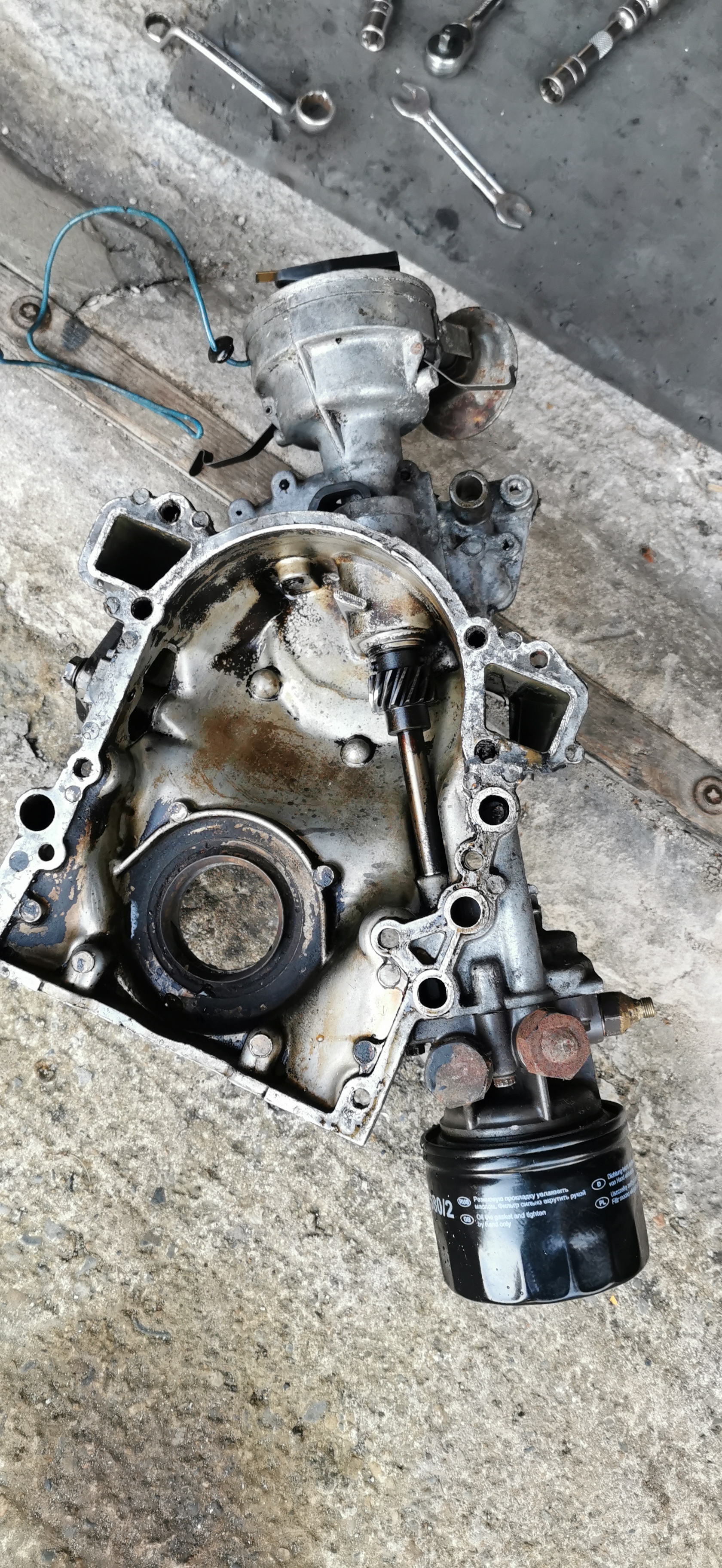

It's difficult to tell from the photo how the oil pump connects to the distributor.
On the SD1 electronic dizzy it there is a female slot in the gear on the dizzy and coresponding male 'tounge' on the oil pump drive. I thought P6 was the opposite way but I'm working from memories nearly 25 years old.
Just an observation. That oil filter's very short, about half as long as the one I have.
If you want to measure your cover from rear mount face to w'pump mount face I can compare to mine if that would help.
