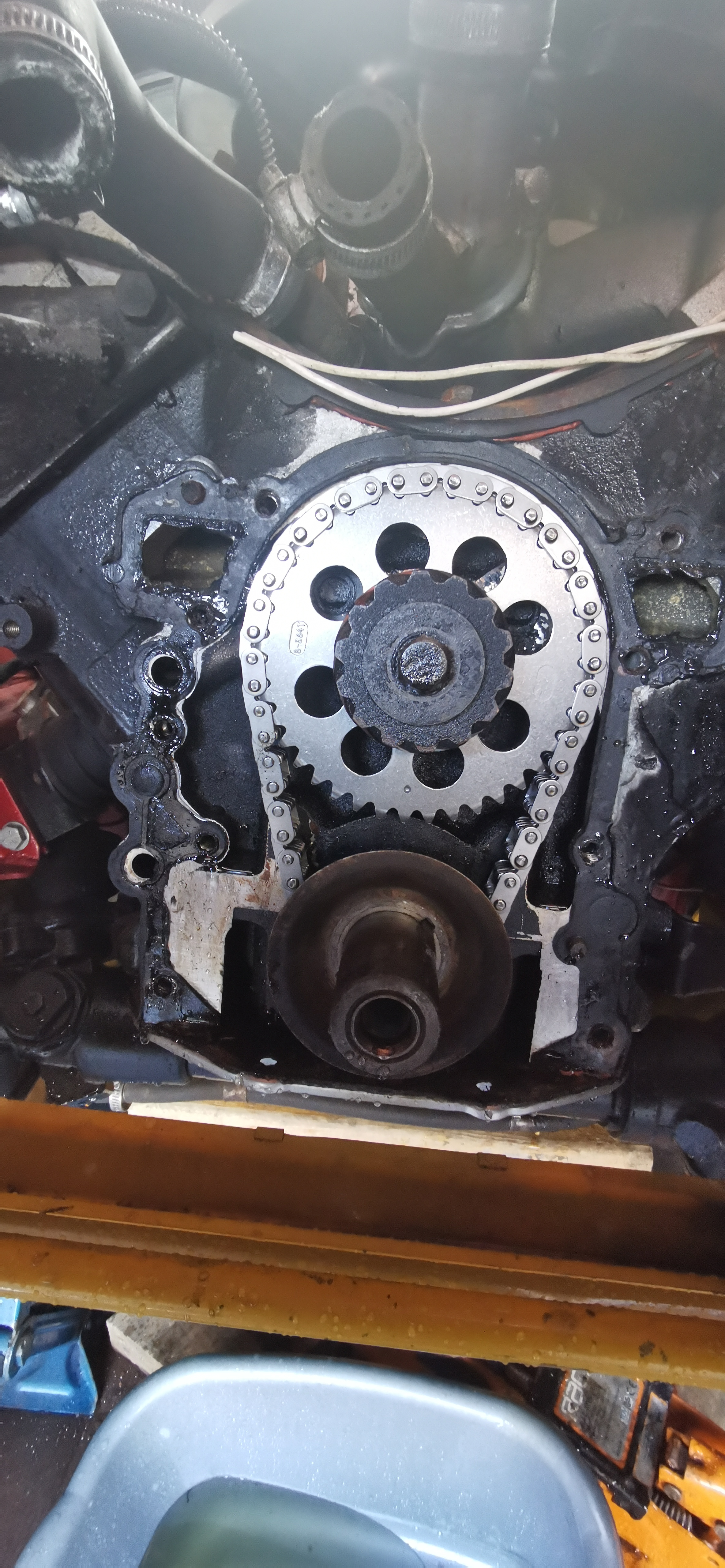

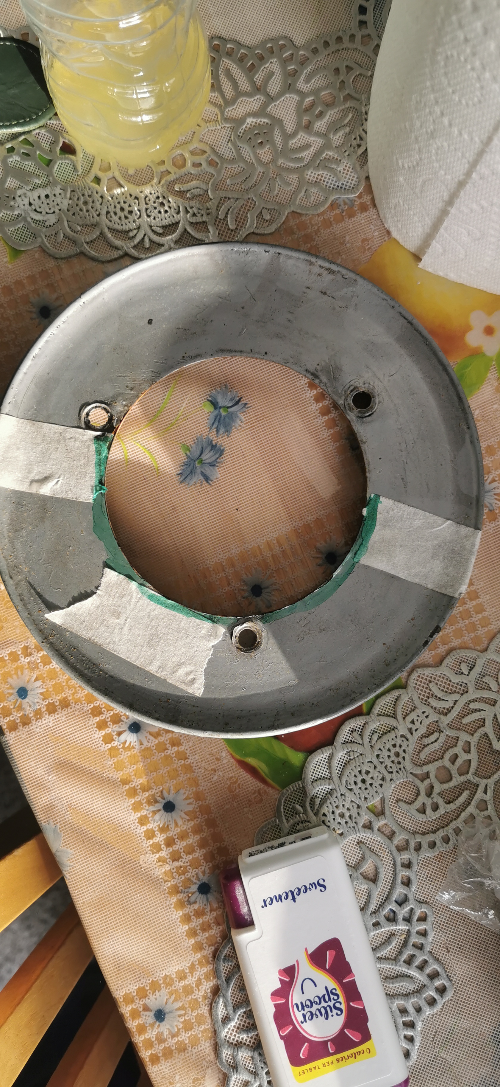

Ive put some meaningless pics up to test if it will work. I'll get some pics of the crank pulley up tomorrow. I decided to paint a few things while off the engine, a little bright but different.

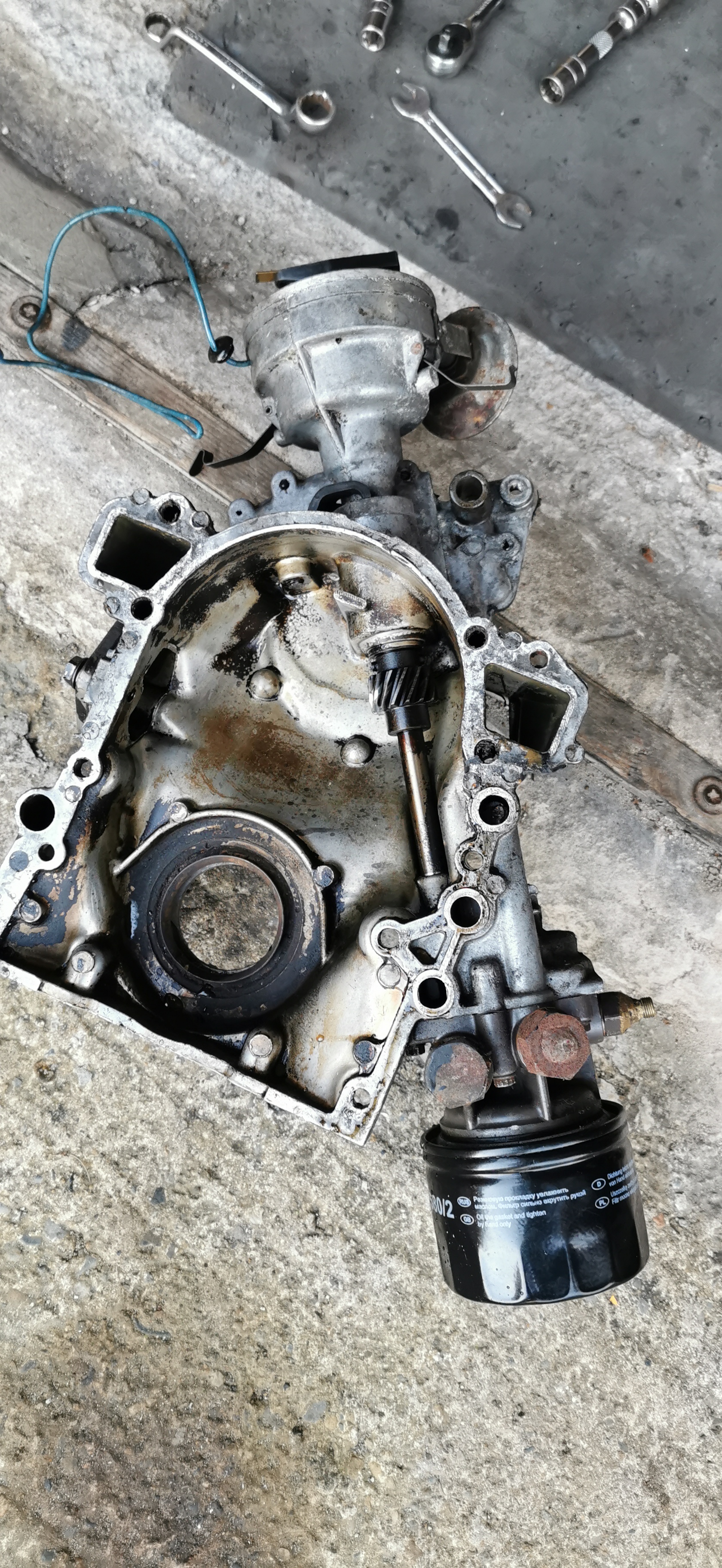

It's difficult to tell from the photo how the oil pump connects to the distributor.
On the SD1 electronic dizzy it there is a female slot in the gear on the dizzy and coresponding male 'tounge' on the oil pump drive. I thought P6 was the opposite way but I'm working from memories nearly 25 years old.
Just an observation. That oil filter's very short, about half as long as the one I have.
If you want to measure your cover from rear mount face to w'pump mount face I can compare to mine if that would help.

ISTR on my P6, the oil pump drive on the dizzy was hinged on the shaft to allow some movement to line things up? But I'm talking of near 40 years ago. :D
harvey
Posts: 452
Re: Timing Cover Swap
Post by harvey »
DaveEFI wrote: Thu Apr 08, 2021 12:21 pm ISTR on my P6, the oil pump drive on the dizzy was hinged on the shaft to allow some movement to line things up? But I'm talking of near 40 years ago. :D
That was on the SD1, P6B had the bottom of the dizzy shaft driving the oil pump directly
