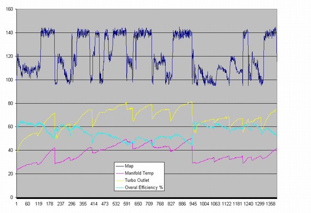

SuperV8 wrote:Do you really need an intercooler if your planning on just 6psi with an efficient suppercharger?
I would say yes, here's a graph from my turbo setup. I had temp probes on the turbo outlet and of course manifold inlet and ambient temp
At 13' ambient:
You can see that the turbo outlet was between 60-80'c (Yellow Line) and temps after the cooler between 35-45.(purple).
The top blue line is absolute pressure, which at 140kpa is indeed around 6PSI.
With 10.5:1 compression, you dont want to be force feeding hot air into the engine.
Hopefully phils supercharger should be inherently cooler, but my advise is to do something rather than nothing.
