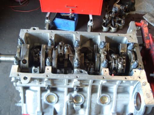

softdash3.9
Posts: 310
Joined: Sun Nov 19, 2006 9:42 am
Location: Near Darlington
Post by softdash3.9 »
Here's a photo of my 3.9 Serp (38A ser No)
Std main caps not crossbolt (I fitted ARP main stud kit)
Regards
Royston
