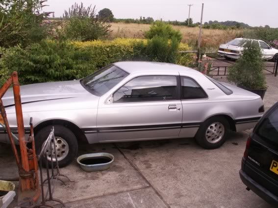

Donor car bought for £300 in the small ads

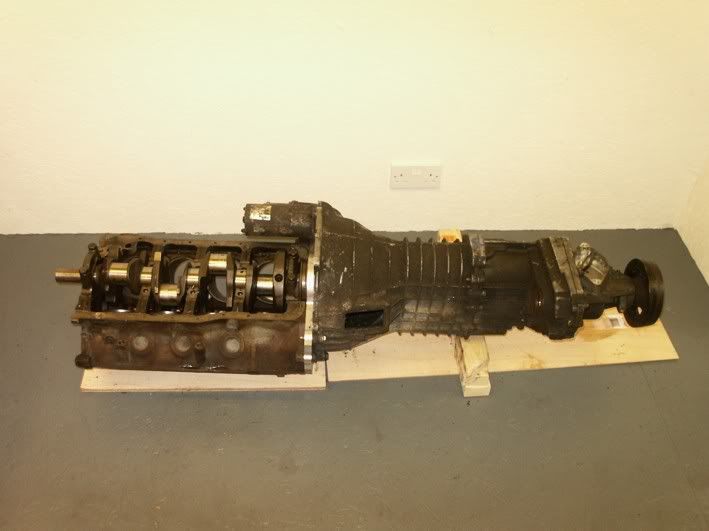

I had a bit of spare time and have trial fitted the engine and gearbox together, gearbox is a scrap one I bought for measurements so excuse the oil and muck.
Sump to do next when time and spare cash allows.

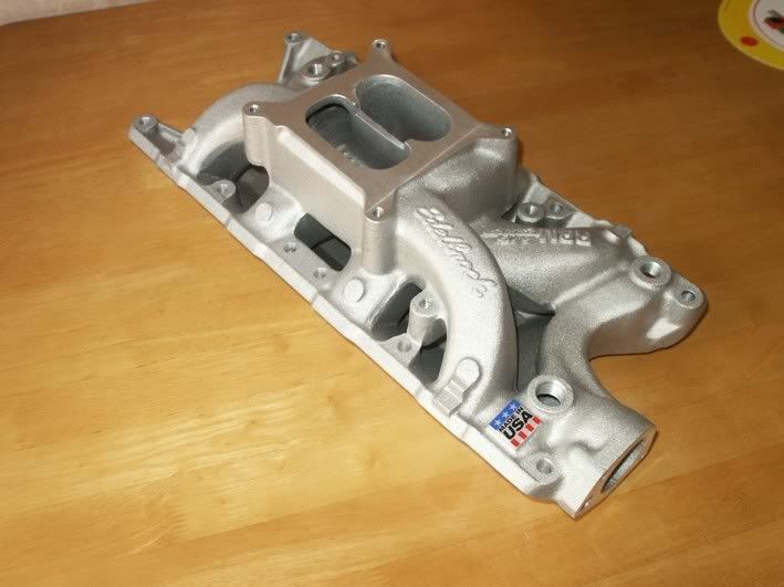

I'm waiting on a set of injectors from US ebay ten I can machine the manifold to suit.

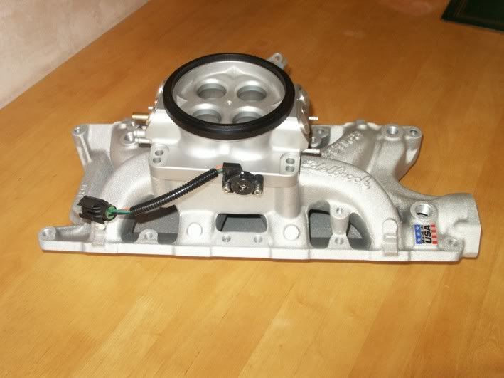

I've converted a manifold to injection - fairly straightforward. Use the Ross Machine Racing fuel rail stock. Adrian at americanv8engines.com stocks it.

I think I'm running -6 on a turbo'd 350 sbc with 60lb injectors - which seems to be working fine at 9-10lbs of boost, but I could do with much bigger rails TBH. So use the -8's
Here's my conversion:
http://www.mez.co.uk/ms4.html
http://www.mez.co.uk/ms5.html
http://www.mez.co.uk/ms8.html
Sit down with a cuppa and your injectors to make sure you clear everything, especially the throttle linkage.
(my rails were from Jenvey - which was all I could get at the time, not as nice as the ross stuff)

Thanks for that, I had not considered the difference in height of the runners with the performer rpm. It might be worth spacing the top of the injector down keeping the injectors closer to the runner ?
