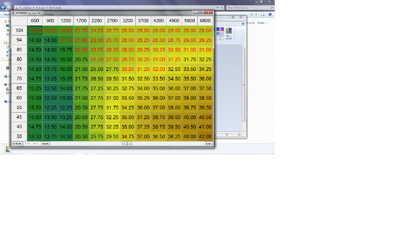

Anyone help me out here with one for a 4.6 RV8,
for some reason the ignition map on my ecu has gone screwy and not liek it should be,
I also do not have a copy of it to redo,
at 3000rpm at WOT im only getting 20 degrees i swear it was set at 28 :cry:
but i think the whole table maybe suspect now,

It wouldnt be unreasonable to have 28deg of timing at full throttle though
at 6.8k mine was only saying 26 degrees,
looks like im well down on power at present as the ignition table is well screwed
have come up with this so far, not sure if its right or not.
Looks reasonable. There must be tons of 4.6 megasquirt maps out there to compare to.
have trial run the car up the road seems to pull a lot stronger, have lost the bog as you pull away, (lowered the throttle enrichment).

Here's mine Tone, but it's a 3.9 I do have a 4.6 somewhere but it's not that different.
This one is JED 5.2
and this might be P.R's but I'm not sure
