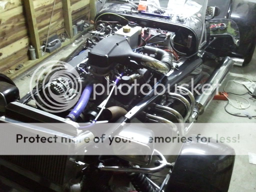

I don't really have a current breather system. The photo shows where it would be going
i don't know what size pipes should be used? Would standard dia be enough? One or two flame traps? Would just using a catch tank be enough?

Just route as many breathers as possible into a properly designed oil/air separator ( catch can ) which will have adequate venting ability.
If this is designed right, this air can then be vented into the intake tract before the blower, as the air will be pretty clean.
Ideally this catch can will return to the sump, below the level of oil.
I'd say a 1" breather from each rocker cover would be a good start. Kind of hard to source breather take offs anywhere else on a rover. Flame traps arent required with a proper catch can.
In fact I think they are more for old carb systems in case of backfires etc.
You can try and add PCV etc, but it just adds complication.
A proper catch can simply needs to have adequate volume inside. And to be baffled in such a manner than any liquids or deposits find it impossible to escape out the vent, yet air can still pass through relatively easy.
Then any fluids caught can either be drained off the bottom, or returned to the sump.
