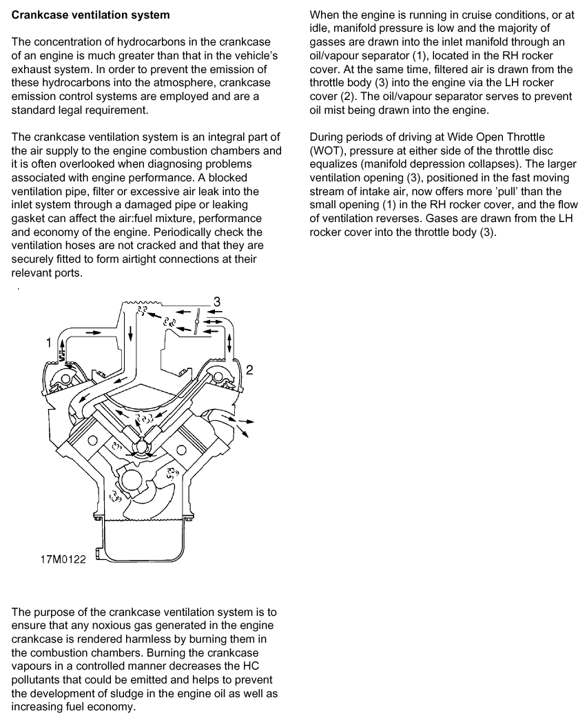

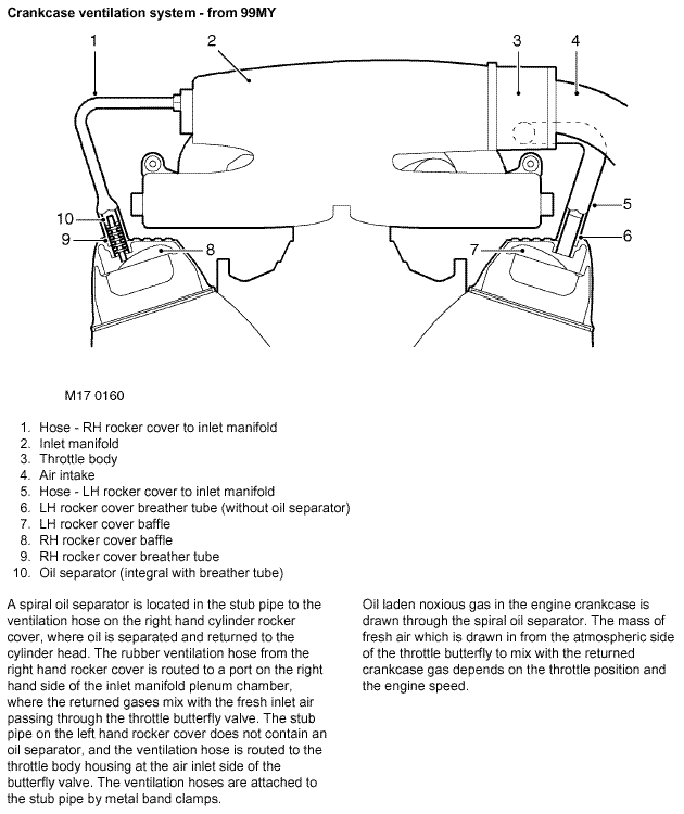

Does anyone know if the Banana Plenum throttle body has a PCV built in or do you need a separate one.
Also does anyone know what flame trap is used.
I'm only using the throttle body and rocker covers with a custom plenum, so never had all the bits.
Also does it matter if you put the rockers on opposite sides, as I need the oil filler at the back due to clearance.

I cant help with the banana plenum. But you can fit the rocker covers any way round you want.

Thanks Chris,
you would not have one for the slightly earlier square plenum, as I'm using a mix of both.
