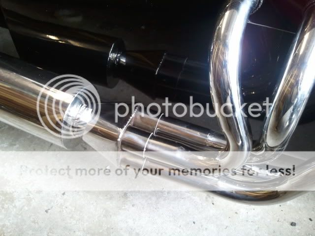

What would anyone recommend for sealing my collector to my primaries?
Tried using a regular exhaust paste but that wouldn't let me fit the collector. After 2 hours of tapping the primaries there was still an 25 mm to go!
I though of using a high temp grease like copper slip. Anyone use this with success?

Last night I thought i'd measure the diameters of the collector and the primaries to see how much clearance I had then I would pick a sealing method to suit.
Well the ID for the 4x collector inlet measured about 41.5mm, 3 of the primaries measured 41.4mm OD which is great, nice fit BUT one measured 41.8mm so no wonder I could only get it on about 5mm. Don't know how this happened, It used to fit, pre-new engine. I had the primaries pollished but I can't see how they would have 'squashed' the end of one? maybe they 'nipped' it in a vice?
First off - a question - does the collector fit on the output of the primaries without any paste? Of course it does - slapped wrist for me!
Thanks Ramon, seems things aren't always as you left them!! :oops:
Anyway tonight i will 'nip' it in the oposite direction to make it round then have ago at re-fitting the exhaust. I'll be sure to measure the other side before I spend 2 hours sweating trying to fit it
