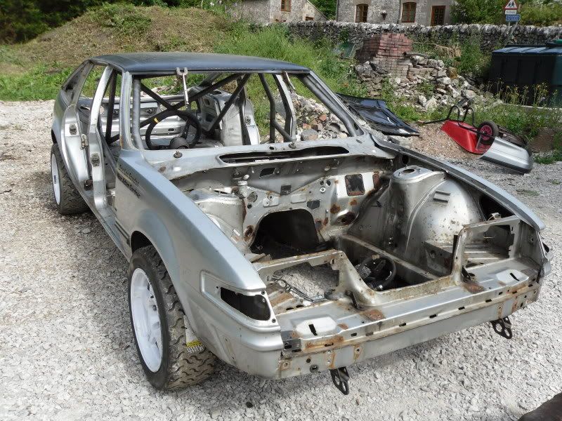

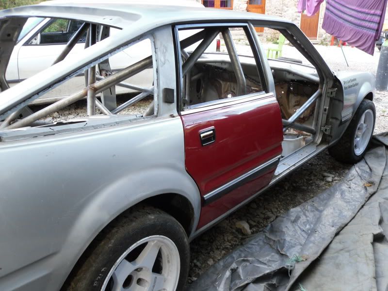

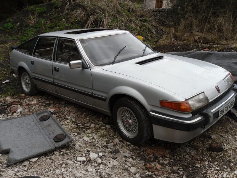

Wjhile I am on, may as well show you what the engine will be eventually destined for...................
As she was when I bought her.............
Now.................
