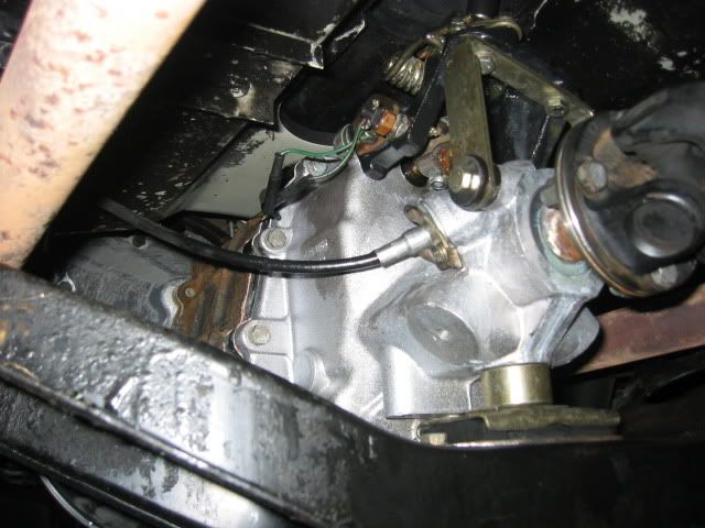

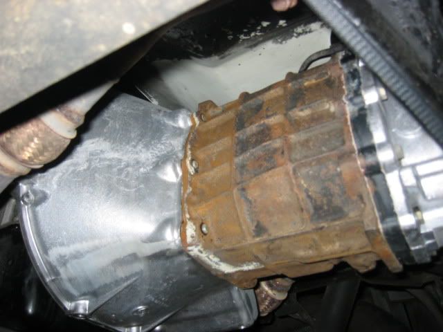

Here is a updated extract from a PDF on my website. The lubricant in mine has been doin' its stuff for over a decade with never a sign of the original problems.
Radical Cure for a Nasty 5 Speed Manual Gearbox
• Here is a radical solution to an unfriendly 5-speed gearbox. My Vitesse used to have a truly nasty gearbox. It baulked at will and was notchy to a fault. In fact it was very, very hard work. This was my last resort.
• During a routine gearbox oil level check, I noticed how dirty the lubricant had become so it was obvious it had to be flushed and changed. It had the recommended ATF which Rover had been forced to specify, because the gearbox was unreliable when filled with conventional lubricant.
• By coincidence, I had been told by an Ex-Mobil employee that Mobil 1 or Castrol RS at 0W40 or 5W40 viscosity were considered by the trade to be a better replacement than ATF in the Rover 5 speed box and gave a much improved performance.
• With the car on axle stands and the back wheels off the ground I drained the box and re-filled it with a flushing mixture of 2:1 white spirit and ATF (I did say radical and it was a last resort!).
• With the engine running at idle speed only, I put the car through all the gears and let the drive train run off-load for 5 to 10 minutes.
• Upon draining the flushing mixture I was amazed at the filthy color and state of the drained fluid. It was as black as ebony with lots of sediment!
• I repeated the above with a clean batch of mixture to flush out the residues. One can imagine the washing machine action inside the box allowed the solvent component to reach into every recess.
• The box was then refilled with 5W40 "Castrol RS" (0W40 "Mobil 1" is virtually the same and I have subsequently used both with no discernable difference).
• I then added a recommended dose of Molyslip Gearbox Treatment. This stuff comes in a tube-like applicator and is available from Halfords, etc.
• The transformation was miraculous. It has run for over 14 years without any of the original symptoms and is a total pleasure to use.
• The oil has been replaced four times in that period with Mobil 1 or Castrol RS and the same Molyslip gearbox additive each time.
