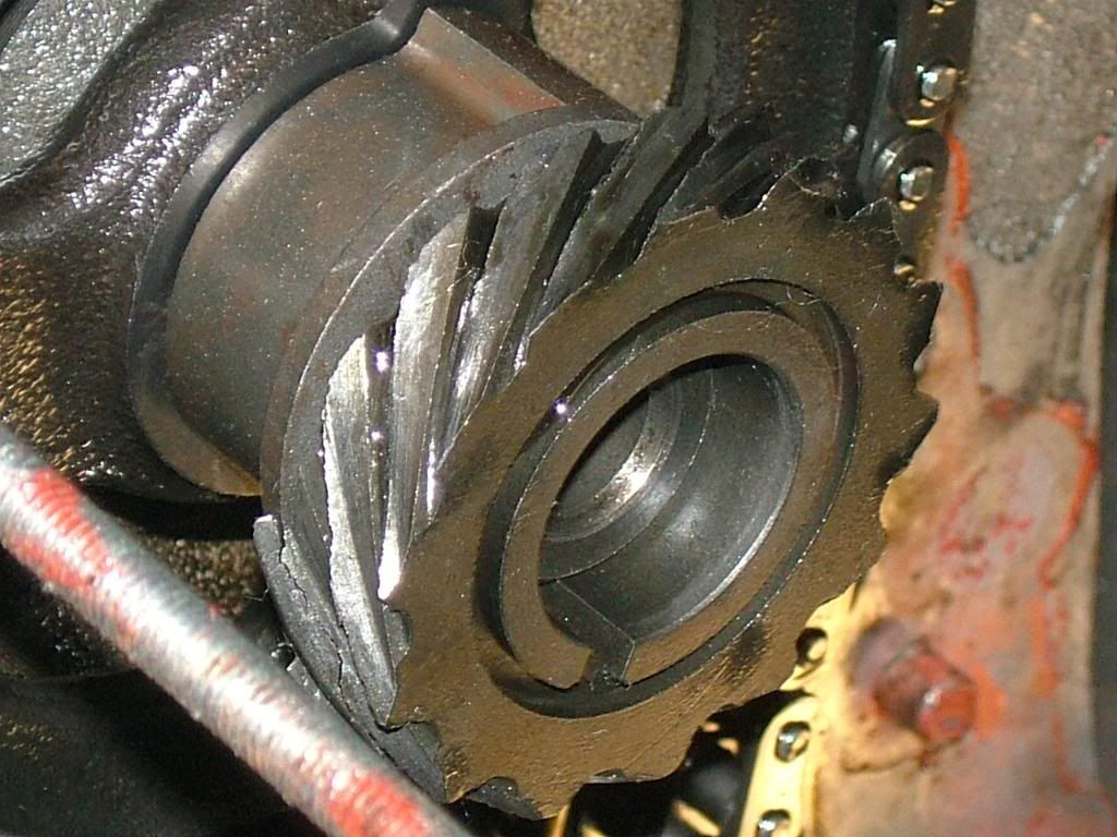

I fitted one of these high pressure pump kits to mine with the stronger spring etc.
This was when I was a RV8 virgin. I thought the 70-80 psi was cool :)
Then the car started misfiring after 4 runs on the 1/4mile. It took me a while to decide to take the dissy cap off and crank it over. The rotor arm ran for 3/4 of a turn then stopped. Then it would pick up again and go another 3/4 turn??
The aftermath was this....

yeah it was the COOL factor that had got me looking for another 1 but think i may be steering clear after your pic and everyone's advice.
