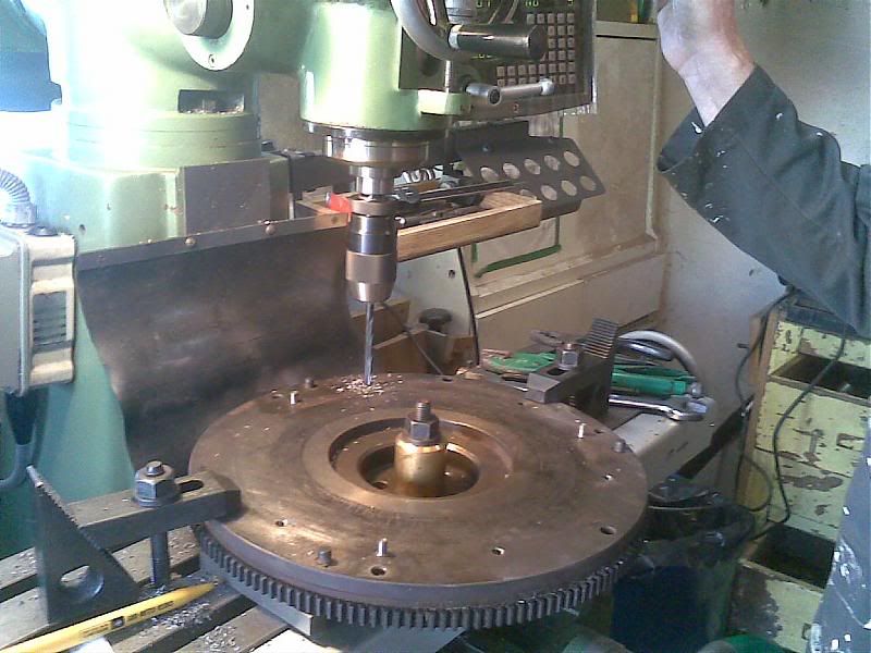

I had to get My flywheel drilled for a series clutch to fit on. I couldn't use a car flywheel as unit was considerably lighter and thinner.
Anyhow thankfully my dad was able to help out and just happens to have a CNC milling machine in his garage (as you do). He made a bush for the centre of the flywheel and bolted it to the table. This meant that when he moved the wheel around it would remain true.
He then drilled and tapped the new holes for the bolts which was fairly straight forward. For the pegs he drilled some further holes in the relevent places and used bolts, with the end turned down to a dowel and loctited them in place.. I will get some pics up on photo bucket shortly and post.
Don't know if its worked yet as I haven't driven the motor but the engine runs fine with no vibration :)

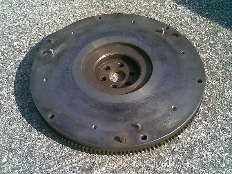

Pics

That looks like you'll have a knackered flywheel. Better had it refaced before you had the dowels glued in.
Its pretty common that SD1 flywheels will crack. It took me ages to find a good one.
Did you have it balanced after the modifications?
