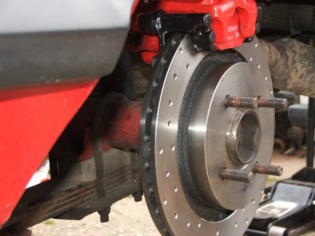

anyone have any experience with these? (see link)
im running a front brake setup ont he rear so probly gonna use these.
my only other option is to put a set of rear calipers ont he car off a difference vihical but the trouble thne is i can only run single disks, there as the spot caliper would allow vented.
my only worry is they will not be very powerful, i should never need to but its nice to think the handbrake can lock the rear wheels.

A couple of GT40s used these or the same thing from Willwoods - one passed and the other failed as they reconed it did not have enough grip for the weight of the car.
I ised the calipers of the Saab 2000 (I think) front calipers on this car have the handbrake built in Works on vented discs
i have herd nothign but bad about wilwood, tho they are cheaper. also the wilwood does not have a cable retainign thing?
would be good to hear from someone who has used one??
trouble is saab bits will be hard to find, shitron BX's had front hand brakes but donno if they had vented disks or if they are exchangable as thye had the weird braking/suspention/steering system.

a few of us capri guys, note i said a few before i get shot down,
have had problems with the wilwood calipers flexing under heavy braking.
so i dont like them, they may of overcome this problem now, but i doubt i will use them again.
have you thought about 4x4 sierra or granada, they use vented discs ot the rear and also cable handbrake
Granada vented rear discs and caliper on the back of my capri,

From quite alot of reading around and talking to those who have used them, willwood are good value for light weight cars, sevens and smaller kits, as you get to heavier cars with bigger tyre contact patches they get less popular. In the US they get slated, seem to be used on Nascar but from what appears or Ebay they get changed every race.
the trouble is....
std caliper runs in front of the disk, if i replace it with a rear caliper (with handbrake) the handbrake cable tends to go in a stupid direction, either stright back in tot he cv joint (because ont he rear there is usually no drive) or in towards the center of the car which means it hits the engine.
there it little room to mounts a big caliper on the back of the disk as i have a track rod there, top and bottom would clash with the ball joints.
so the spot caliper would make sense as i can run the good caliper matching the front on the back, and the spot would probly fit in and clear the trackrod etc.
any feed back on the HiSpec spot calipers at all?
Ralph

Thinking out the box now
What does the front have on it and could you put the handbrake on the front wheels?
