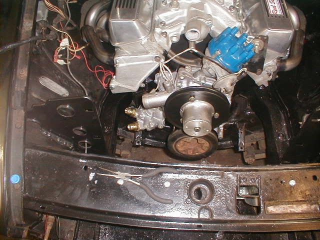

Water pump fits to the front cover so that is the important item to match the pump to - presumably you have a 1990 or earlier cover rather than one of the later versions with the concentre oil pump.
If the pump is like the one on Katanaman's sig then I think it is a P6 or SD1 version - both have the same pump to timing cover gasket but the pulley style is different, SD1 puts the drive belt far forward compared to the P6.
Range rover style front covers place the pump higher above the crank centre line.
