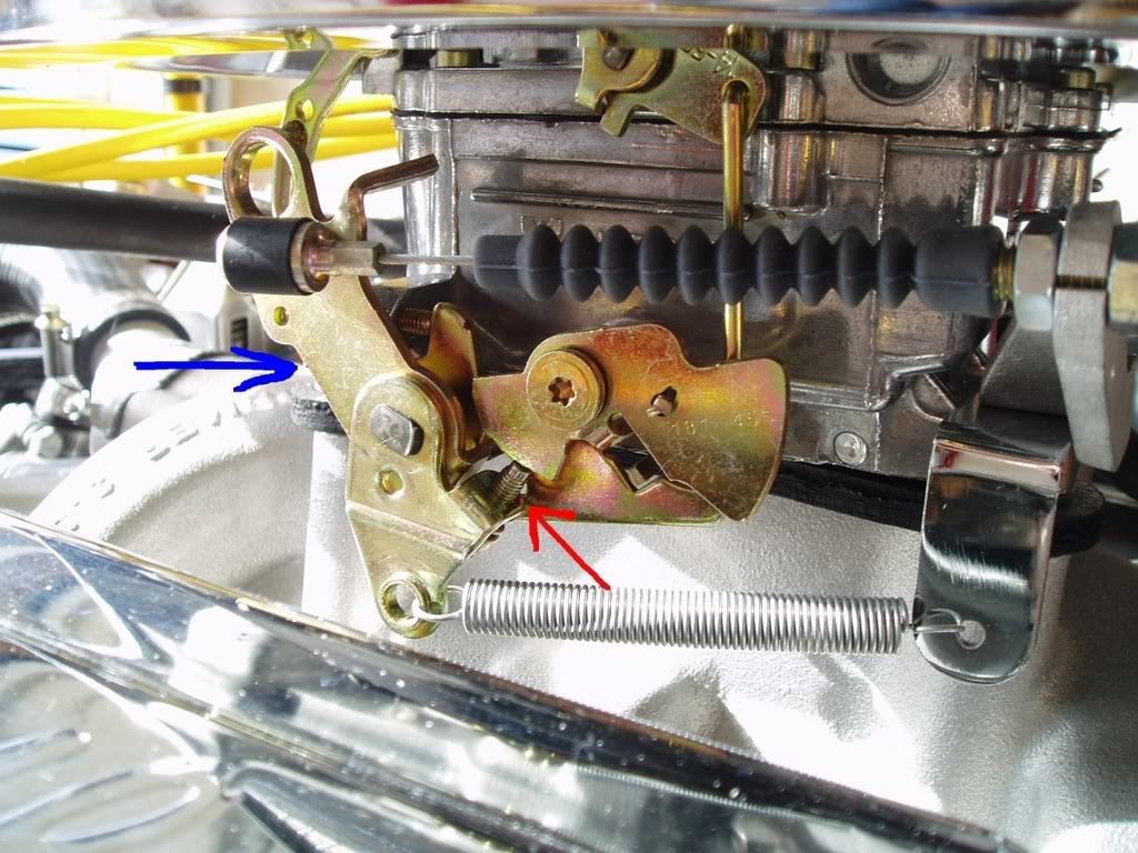

Fitted an Edelbrock 500CFM carb with electric choke. On cold start the idle speed is 3,000 rpm, so I want to reduce this. Which is the correct screw to use ? I think it's the one just above the left hand of the throttle spring with a red arrow in the pic below.
The blue arrow points to where the idle speed screw is which you can't see, but I know that's the right screw and have set the idle speed when warmed up to about 900rpm which is fine.
Just want to be sure before I play around. What should the idle speed on the choke be and I guess 'undoing' the screw reduces the speed ???

You are correct, the red arrow screw is the fast idle screw, I'd try to get it to run at around 1000-1100 rpm but that's just my opinion. (Screwing it out slows down the fast idle).
The blue arrow screw is the main idle screw, set this at round 800-900 rpm...this will depend on the size of your engine and the cam fitted. Basically you can see and hear when you've gone too low.
By the way the edelbrock badly overfuels even a tuned RV8 to the point where you will start to damage the bores if you leave it on the standard settings. Changing the needles for 67-55 will get you in the right ball park.
