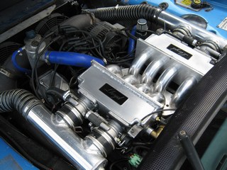

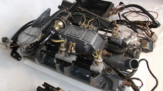

Got some interesting photos for a very early brico electronic injection manifold:
http://www.mez.co.uk/ms12.html#brico
and a prototype from Lloyd specialist developments:
