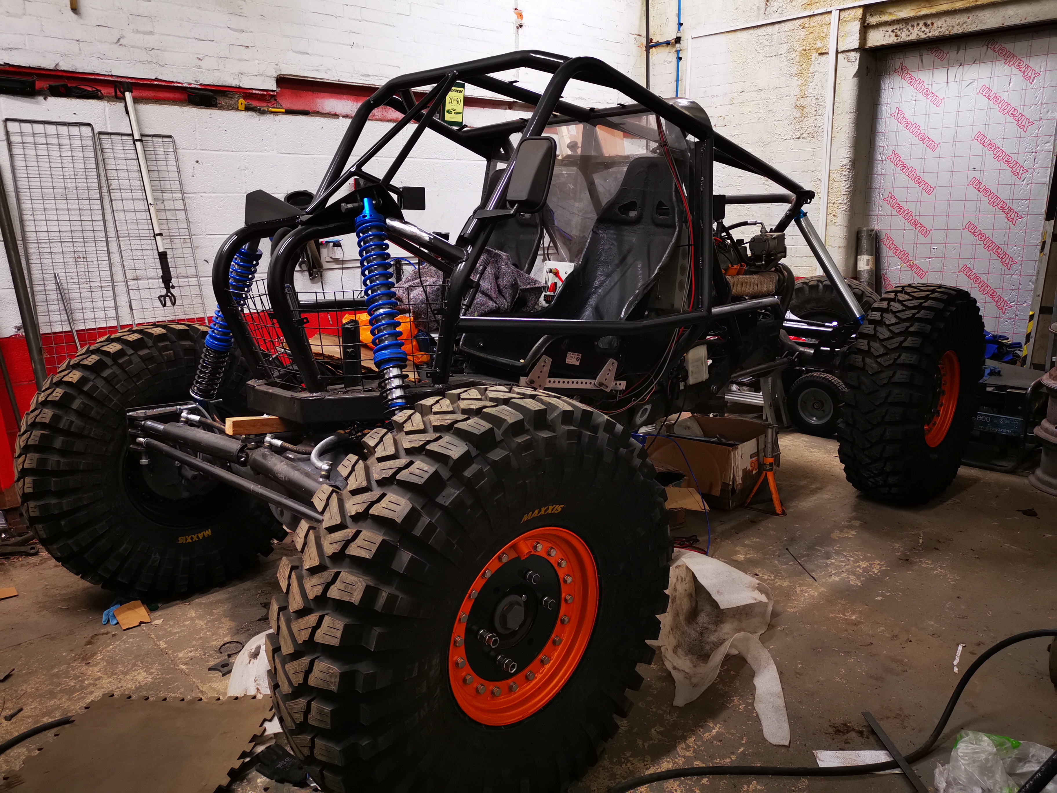

Good afternoon,
New to the forum, I came across this post hunting for info in the DPR conversions, myself and a mate have a running example of the 3.5 conversion. I’m interested to find more details of the particulars of the builds. The lower half of the inlet has been swapped for a Hotwire setup, and it’s currently running on a 3.9 map. Were now going to aftermarket to make the most of it.
Our engine is mounted in the rear of a unimog axled off-road buggy. Were running the forward facing the headers, which are now rear facing with the engine rotated.

ChrisJC wrote: Thu Aug 13, 2020 8:18 pm Looks interesting - wouldn't mind seeing some more pictures of the buggy!
Here you go Chris
Re: how do i go about supercharging??
Looks amazing - what actually is it?
JonGridley
Posts: 3
Joined: Thu Aug 13, 2020 2:50 pm
Post by JonGridley »
It’s a completely custom build, built for 5 gate euro type trialling. She’s running 42” tyres on unimog 404 axles, 4 wheel steer and several other tricks
Posts: 2457
That looks like heaps of fun,😀
