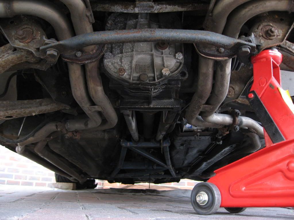

Hola chaps, I'm looking at places to fit my Innovative LC-1 WBo2 sensor and the only practical place I've been able to find is towards the back of the exhaust about level with the rear wheel (but before the only silencer). Is this an OK place to put it or will it not get hot enough?

I'm planning on fitting mine on one of the downpipes from the turbos. Can't you fit it any closer to the front of the engine - like the y-pipe or collector?

Not really, the manifolds are very tight and exit through the wheel arches and then run down the sills as four seperate pipes and only meet finally at the back where they go into the silencer. The problem is that the part of the exhaust that I fit the sensor into will need to be removed from the car in order to have the bung welded in and I'm not crazy about removing one of the manifolds.
I am planning cylinder head changes at some point in the (far) future so can put the bung in a better place then.
It's self-heating, so it can go in free-air if you like! It might be however that at the rear of the exhaust the gasses have cooled enough to be able to overcome the heater and force it to operate out of spec.
P.S. Why is the exhaust like that?

Chris, the exhaust is like that because theres not much room to do anything else. The blue subframe type thing in the middle is the gearbox mount and helps locate the rear diff which means theres no room to bring the exhaust down the transmission tunnel, and two thinner pipes per side were considered to be a better idea than one fat one per side when it comes to ground clearance. I bought the car like this and whilst it would be nice to have the exhaust up out of the way with a nice X-pipe it'll have to stay as is for now, especially as it cost the guy who built it a hell of a lot of money to have made!
I've had a hunt around for clues, but what car is this a picture of the underside of? it is 4 wheel drive (if that is a front diff) and I suspect has a rover in it but the rest?
kiwicar wrote:Hi
thats the view from the rear of the car. Thats a ford diff in the back.

'Tis a MX-5 :lol:
I can't claim responsibility though, it was like that when I found it. The chap who did build it (on his driveway :shock:) kept a build diary which is HERE.
