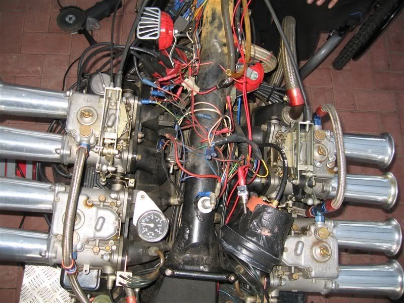

kiwicar wrote:The inlet manifold gasket will be a standard rover V8 jobby, it also forms the vally cover. There are two types for the 3.5, one is a simple piece of embossed ally, good if the heads and block are pretty standard and line up properly, there is a later composite version that seals up a block after a skim or two, however it can stick to the gasket surfaces and be a pain.
I think someone on here has that manifold on a stag, I think it may have been designed for the stag with a rover in it, not sure though. Nice looking piece of kit though.
