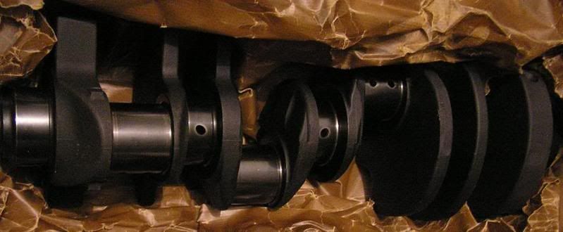

The 4.2 crank is in some ways the strongest factory crank on paper but it is also technically the most brittle. I think the key to using one in a tuned application is getting your clearances and balancing spot on. If you do then I think the crank will be very strong. There are stories of early tuned 4.2's self-destructing but I think that probably had something to do with the offset piston design of the 4.2 that is not really ideal for a racing engine. I bought one last year NOS from a guy who took some stock off a Land Rover main dealer branch that closed. It appears to be nitrided and crossdrilled from the factory! Does anyone know if this was done to all 4.2 cranks?

Thats an intresting perspective, I think the Icebergs did get a bad press, were the cranks not made for the still born Diesel engine, and one of the reason they were dropped was the breakage of the cranks, but a Diesel has far more compression loads imparted upon it. I could quite easilly see a quick spin up on the lateh to reduce the rotating mass a bit and possibly a bit of Knife edging as well,HairbearTE wrote:The 4.2 crank is in some ways the strongest factory crank on paper but it is also technically the most brittle. I think the key to using one in a tuned application is getting your clearances and balancing spot on. If you do then I think the crank will be very strong. There are stories of early tuned 4.2's self-destructing but I think that probably had something to do with the offset piston design of the 4.2 that is not really ideal for a racing engine. I bought one last year NOS from a guy who took some stock off a Land Rover main dealer branch that closed. It appears to be nitrided and crossdrilled from the factory! Does anyone know if this was done to all 4.2 cranks?

For interest I shall weigh it vs a 3.9 crank. If I start weighing cranks on the bathroom scales on xmas day then there is a good chance that i will be booted out the house so i'll wait for a quiet moment and report back! My one concern for Kevin would be if they were all nitrided from the factory then the .010" undersize will have affected that.

If I remember from my apprenticeship days the surface treatment is only a few thou thick, Between 0.0025" and 0,004" and the 10 thou regrind I am fairly sure will have removed it from the journals, The only advantage that Nitriding/Tuffriding does is create a hard surface, it does nothing to stregthen the metal, other than stopping grooves, scuffs and scratches which in turn may prevent problems due to stress risers at these points.
I remember on some of our MOD and LLoyds jobs that all the stressed corners had generous Radii and were rolled under extreme pressure with a steel roller to consolidate the grain and pollish in that area, not my favorate job.
