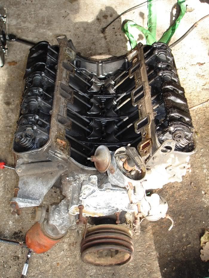

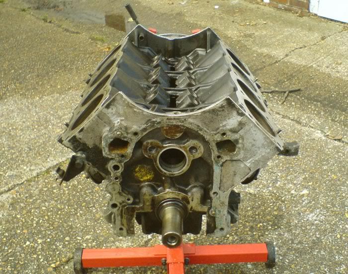

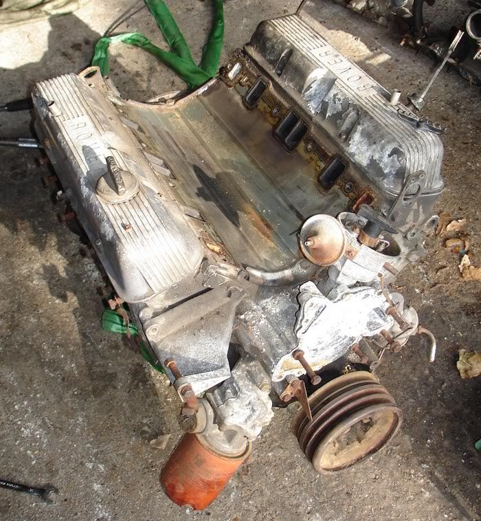

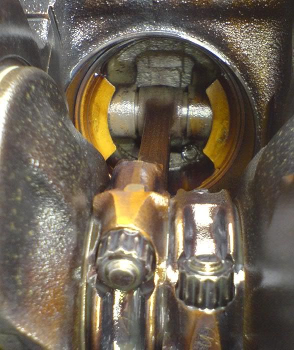

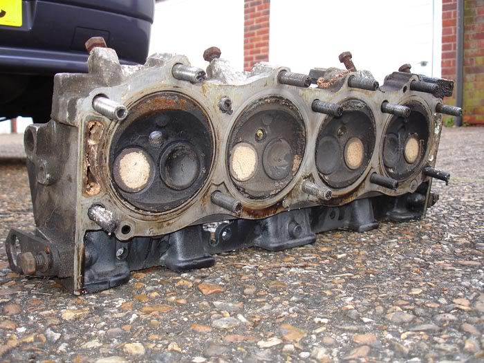

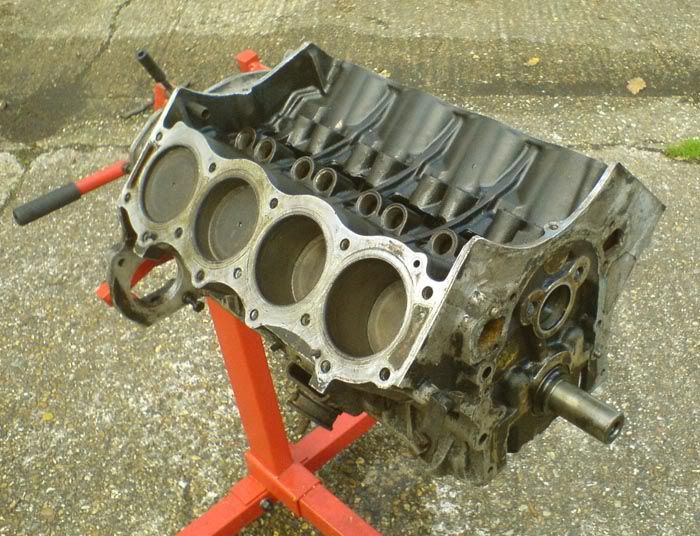

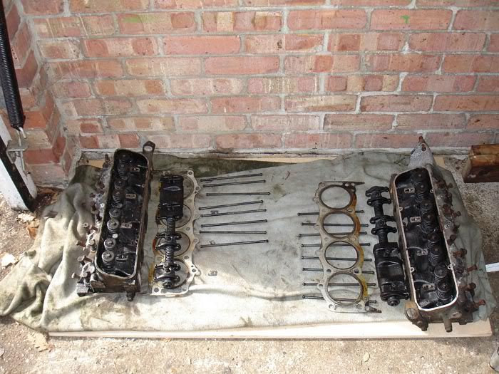

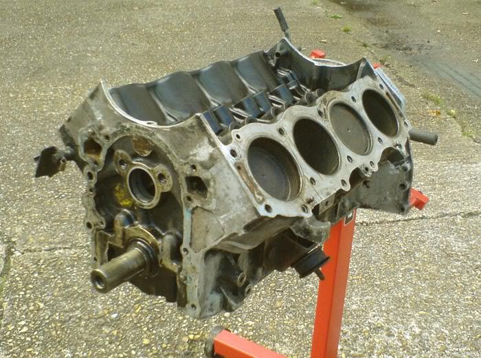

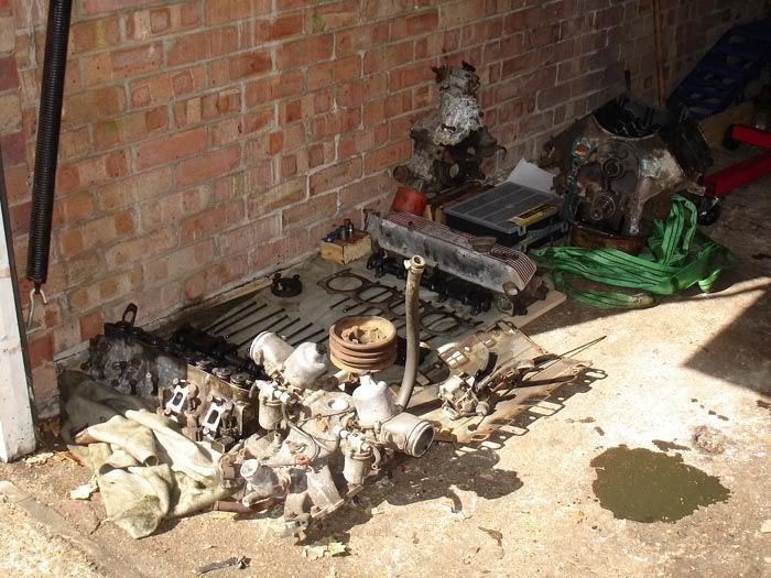

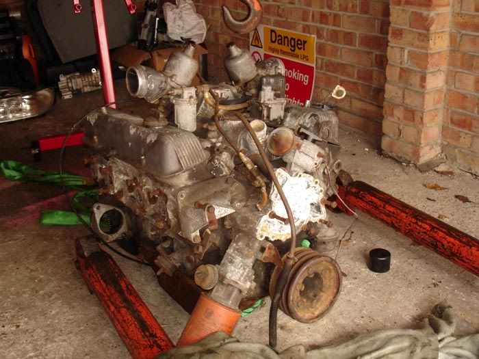

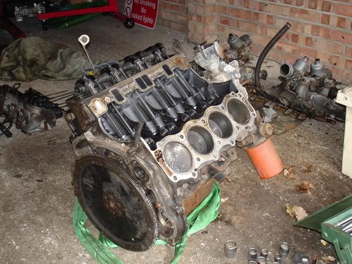

Hello, i'm new to this site and to the RV8.
I bourght a RV8 3.5 off ebay for very cheaply with the prospect of fitting it into an Opel Manta. :)
Looking through this forum for my engine code I found that it's in a different place (next to bellhousing) so makes it an early engine (840).
So I have an old 1967 Rover P5B engine with the high compresion pistons (10.5:1) but small valve heads.
I have taken it allmost to bits and found that the cam shaft is nackerd but the followers are not and were easly removed. The bores arn't scored and have a very minimal rim on the tops and havn't sunken.
Is it wise that I source the later heads with larger valves and hardend seats?
Here are some pics of my progress.

there are a few things you can do to improve this engine.
1. Change the heads to newer ones which is probably the cheapest and easiest way to get power you will ever get.
2. Change the front cover to a later SD1 cover. This will give you a better oil pump and let you fit the next step plus you get a better front crank seal.
3. Fit the later electronic dizzy. can only be done if you fit a newer front cover or will will have to use a mallory or something like that.
4. You can also change the pistons for later 9.75:1 pistons. They are stronger and the lower compression makes it easier to run on pump fuel. This can cost a bit and really isn't a must do just an idea.
In short 1 and 2 are really good things to do 3 and 4 are good ideas but you dont have to .
