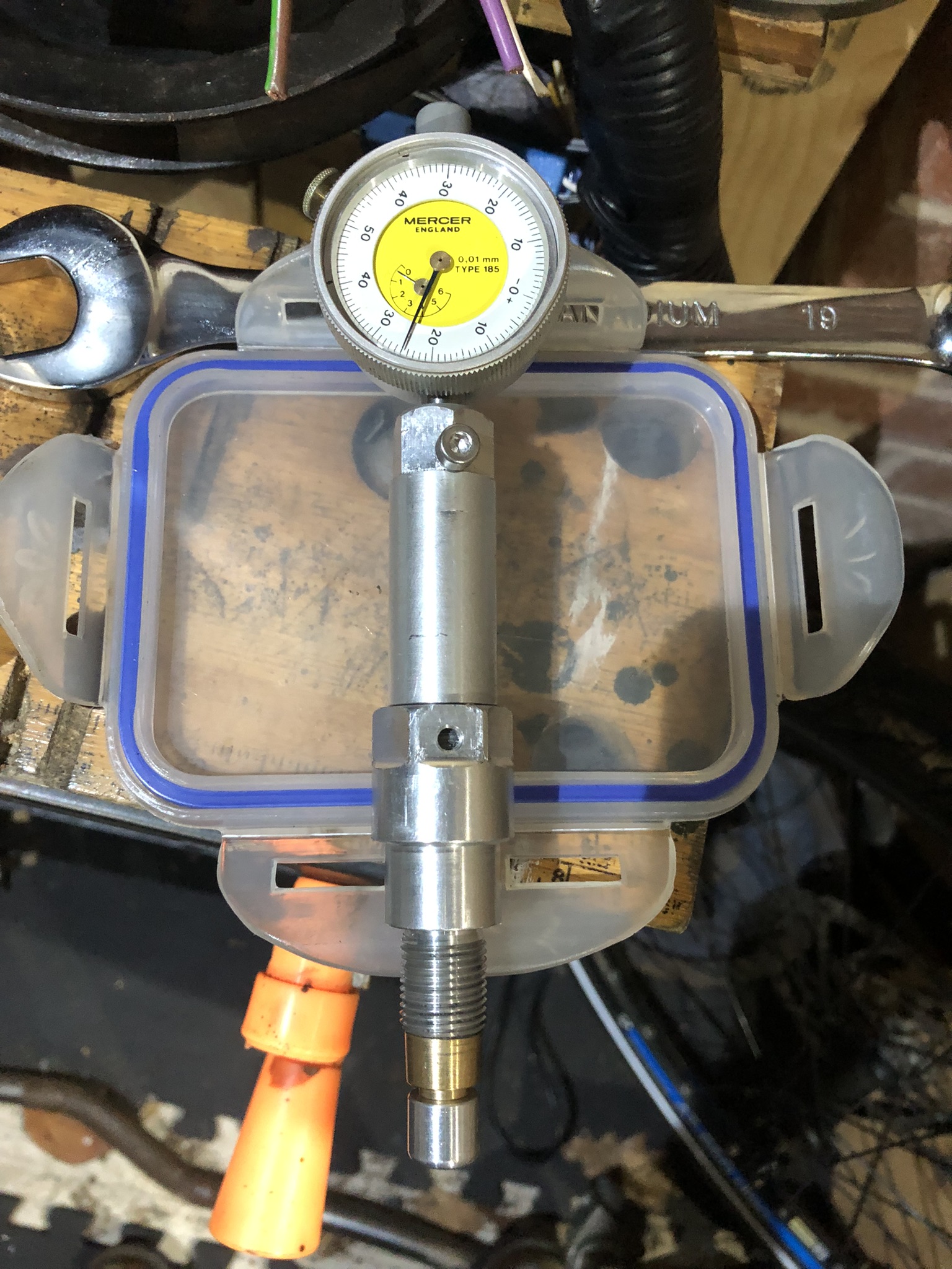

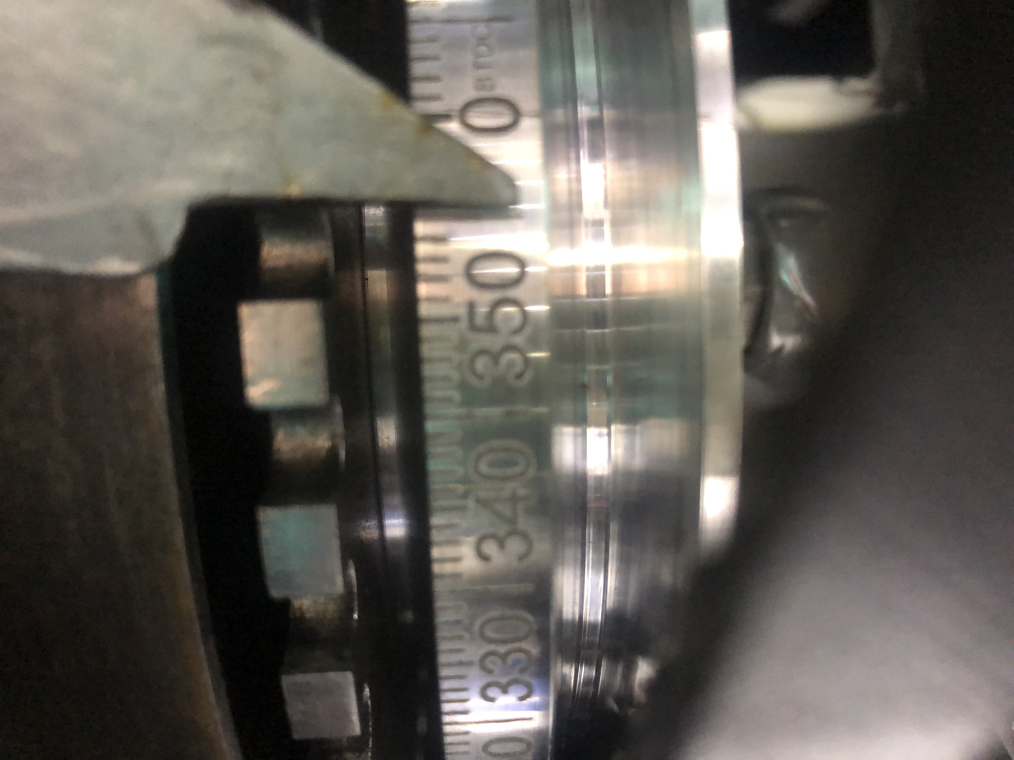

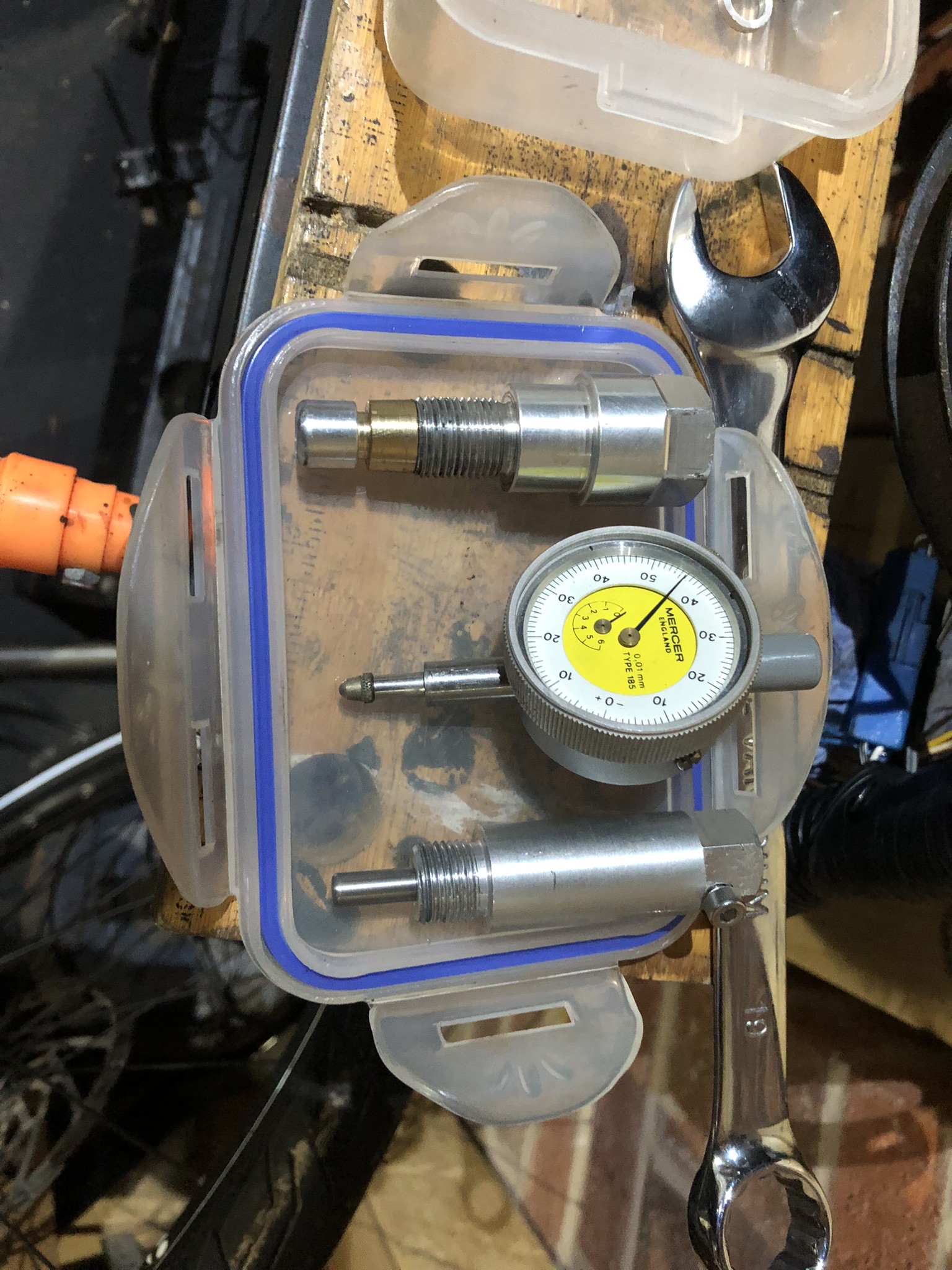

Firstly I've made up a crank pulley with degree markings on it. Then I made up a spark plug holder for a DTI to check that TDC on my timing pointer is at true TDC

This verified that TDC is correct on the pointer.

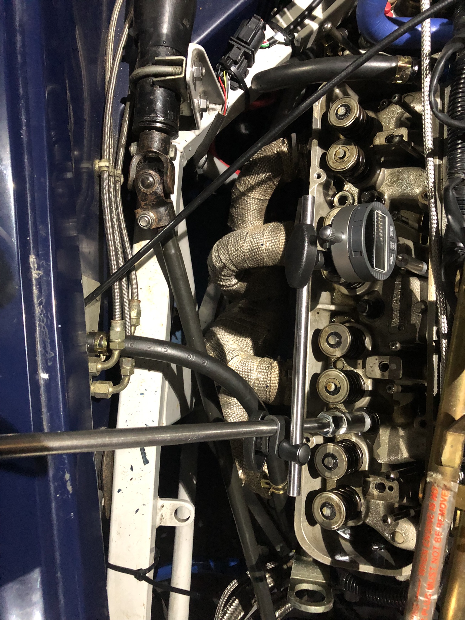

I've than created a setup to hold a DTI against a pushrod which is bearing against the lifter. I've setup an endoscope to make it easy to see the engine position and the lifter position at the same time.
Re: Camshaft: Trying to identify and check
So now I simply rotate the engine and read off the lift values

I've initially started taking lift reading as soon as a movement appears on the DTI and plotted these based on 0.01mm movements at first then with increasing lift up to about 1mm then taking readings at 5° increments up to around the peak where I've dropped back to taking readings based on the lift values.
