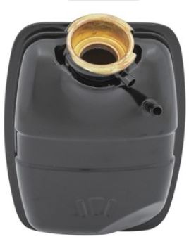

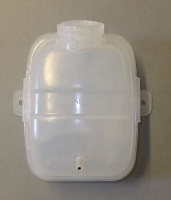

Not sure your pressure cap would fit on the first plastic tank, the second looks like a standard cap fitting

Must say in a Landy runnng slow I would add some bonnet vents to let hot air escape…..the more heat that escapes the better!

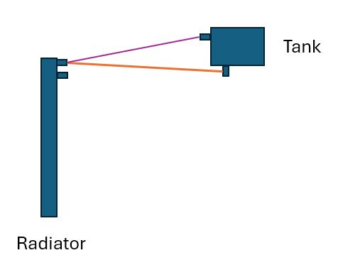

If I connected the top radiator overflow to the bottom of the tank, it wouldnt be going up hill. But it would be going uphill if I connected the top overflow from the radiator to the top of the header tank.
I've done a very basic drawing below......the orange line shows how it would run if I connected it to the bottom connector on the tank. The purple line shows how it would flow on the top tank connector ?
The manifold pipe would stay connected to the second overflow outlet on the rad.

I think your design won't work correctly.
As we all know, water expands when it gets hot. But when it gets cold, it contracts again. We also know that water begins to boil at 100°C. It's important to note that this only happens at typical atmospheric pressure.
In the context of cooling systems, it's also important to know that air bubbles rise to the top...if nothing else prevents them from doing so.
You write:
This is because the water pump pushes the water through the engine and from there through the radiator. The inlet from the radiator to the water pump is probably located at the bottom of the plenum chamber, below the small hose connections. The water pump therefore draws water not far from the small connection.
Therefore, there is significantly less pressure at the small connection than in the carburetor dome. This results in water, and if present, air, being constantly drawn from the carburetor dome to the radiator.
This ensures that the air initially collects in the radiator.
It also ensures that the intake manifold warms up quickly. This ensures a shorter warm-up phase.
So. Now the air is in the radiator.
As the coolant heats up, it expands. The pressure in the system increases. There is no outlet for the volume other than the second small hose to the expansion tank.
So the volume pushes there.
Since there may be air in the radiator, and this is located directly in front of the hose connection, the air from the radiator is first forced into the expansion tank.
It is better if the expansion tank is positioned as high as possible, but the pressure differences that also exist here also push the air downhill into the tank.
The hose is inserted into the lower connection of the expansion tank.
Functionally, the plastic and metal tanks are the same. In both cases, the lower connection opens at the very bottom, although it looks different on the metal tank. If you look inside, you can see that the connecting pipe extends almost to the bottom.
So now the air is in the expansion tank.
This must(!) have a special pressure equalization cap. I've been using the original cap with the 15-PSI imprint on my V8 for years.
Two valves are integrated into the cap.
"A pressure relief valve": If the engine expands because the water, and therefore the engine, gets hot, the pressure relief valve maintains the pressure up to a certain level. This increases the boiling point, and the water only boils at 105-110°C. This is very important for the engine. Even if the gauge shows 90°C, there can be hot spots in the engine that are significantly higher. If the water starts to boil there, the cooling effect is reduced.
If the pressure rises above the intended limit due to expansion, the cap releases the pressure. First, the air that was once in the engine flows out.
The excess pressure ends up in the small space between the cover and the valve. This is also where the second pipe connection opens. A hose leads down to the outside.
Another valve, a vacuum valve, must be integrated into the cover: When the engine cools down, the volume of the coolant changes again. This causes the vacuum valve to open and let air into the expansion tank. But! The connection to the radiator is at the bottom of the expansion tank. This means that only water flows to the radiator. It's important that there's enough water in the expansion tank. Too much isn't a problem. It's pushed out during the first warm-up, and the level is correct when the engine cools down.
A few more words about the thermostat valve:
It makes sense to have the valve installed. It reduces the warm-up time and keeps the engine at the right temperature. A valve at 74°C is very cool. That's not particularly good if everything is OK. I would install one with 82°C. You can also remove the small check valve (plastic ball with a metal fork). This will ensure constant flow through the thermostat and react more quickly. However, the engine will only warm up slightly slower.
All in all, I think the system was properly connected before. I would reinstall it.
Check carefully to see if the expansion tank cap is properly positioned. Change the thermostat valve to 82°C.
Oh, and the temperature gauge sensors aren't very good either, and they're showing strange readings. Checking with an infrared thermometer helps enormously.
Best regards,
Frank

Thanks Frank, thats really informative.
So, in summary, you would suggest sticking to the way I have it plumbed now (bottom radiator hose plumbed into the base of the tank, with the inlet manifold small hose to the radiator and the other small hose to the tank). Since I plumbed it this way its been operating perfectly, other than the fact that the header tank gets hot.
The original owner had the top radiator main hose plumbed to the tank, the hose was almost horizontal to the ground. This was causing the over heating issues. As soon as you pointed the truck up hill the top radiator hose would fill the tank and it would over flow. After a few hours trialing, the water level had dropped significantly. As I have it now im not getting any of these issues.......thankfully. Temp is fine, no air bubbles, the water level rises and fall as it should when the engine heats ans cools.
I only thought about plumbing it like I showed in the pic to prevent the tank getting so hot......but I think you're right. If it ain't broke, don't fix it ! I also have the benefit of being able to top the system up from the tank this way, which is easier.
Thanks again.

Re: 3.5 RR classic cooling issue
The correct answer is:
# 1x Small hose from the carburetor dome to the radiator.
# 1x Small hose from the radiator to the lower expansion tank connection.
# 1x Overflow from the upper expansion tank connection to the outside.
What do you mean by:
Regards
Frank
Hi Frank,
Thanks for the reply......my system is currently set up slightly differently.
The main bottom hose (outlet) from the the radiator (the one that goes to the water pump). Has a 'T' in it, this 'T' goes to the bottom of the tank. As it is, everything is working perfectly, apart from the fact that the tank gets hotter than I'd like, I think it's not helped by the fact that the tank is aluminium.
I'd contemplated plumbing it like yours which would allow me to use a brass tank and hopefully resolve the tank heating up.
rob588 wrote: ↑Mon Aug 25, 2025 10:32 am The main bottom hose (outlet) from the the radiator (the one that goes to the water pump). Has a 'T' in it, this 'T' goes to the bottom of the tank. As it is, everything is working perfectly, apart from the fact that the tank gets hotter than I'd like, I think it's not helped by the fact that the tank is aluminium.
I'd contemplated plumbing it like yours which would allow me to use a brass tank and hopefully resolve the tank heating up. :
If you connect the lower hose leading to the water pump to the expansion tank via a T-piece, you've solved the expansion function. But! Air might collect at the top of the radiator. This isn't automatically vented to the outside. That's not good.
A hot tank isn't a problem as long as the temperature stays well below 500°C. Above that, there's a risk of the aluminum melting.
If there was a lot of air in the system during the first test drive, it's quite possible that the temperature fluctuated abruptly. As long as there's no water at the sensor, the sensor doesn't detect the water being hot.
If there was water in the expansion tank, the system vented itself, and the water "migrated" from the expansion tank to the radiator.
You mistakenly attributed this to the gradient. In reality, the water replaced the air.
With few exceptions, the designers put a lot of thought into how something should work. It takes good ideas to improve it.
Regards
