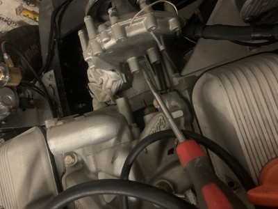

Hi all.
Wonder if someone can help. I’m finally putting my rover 3.5 back together and as I’ll be travelling up to the far north I’m installing a Webasto engine block heater that I want to plumb into the heater line. Challenge is I can’t work out which pipe on the water pump is the outlet and which is the inlet. As per the photo, both are next to each other.
Any thoughts?
Re: Heater connections rover 3.5 v8
Both inlets. One is the thermostat bypass, the other is the heater return.
The heater outlet is at the back of the inlet manifold.
