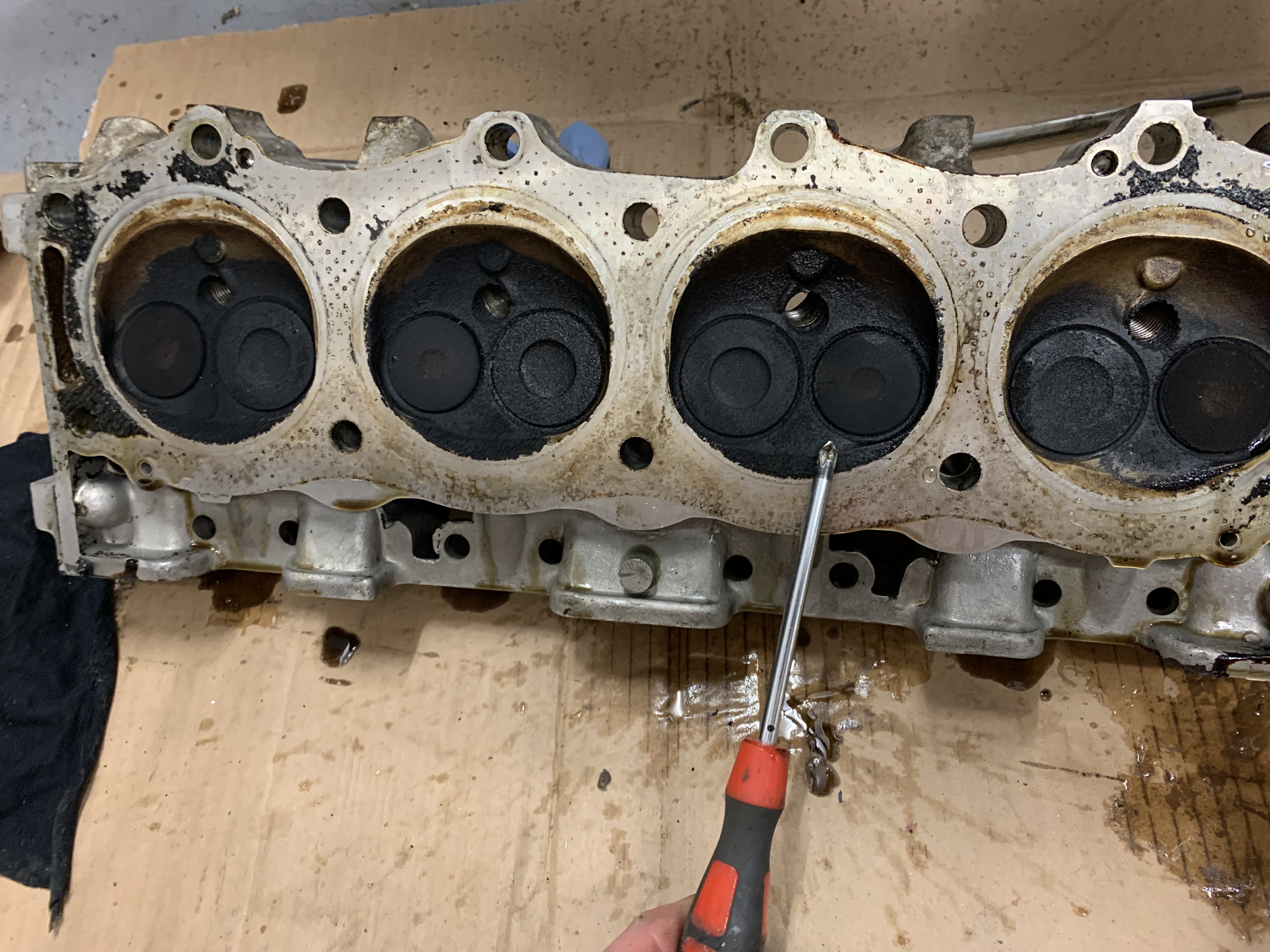

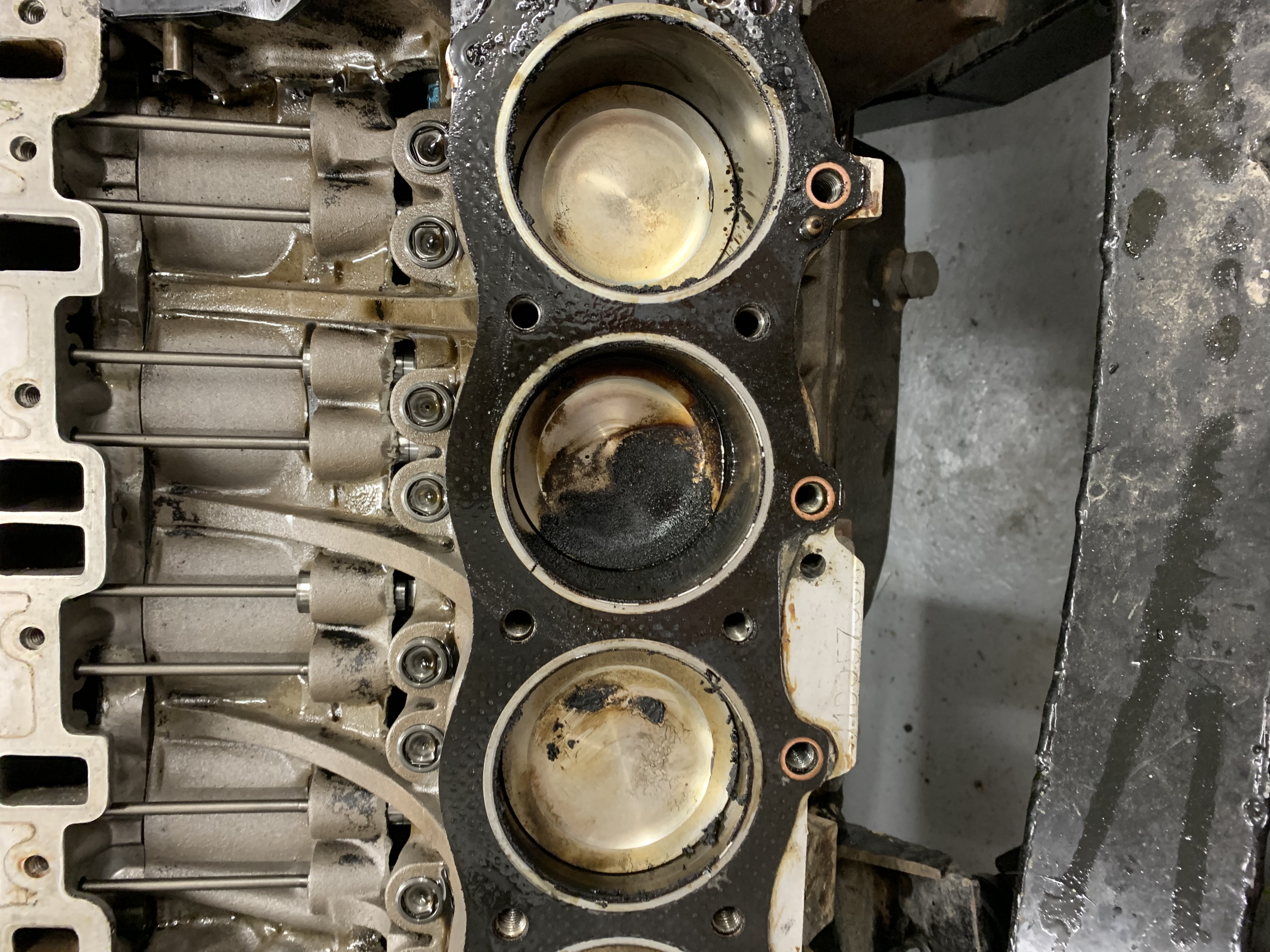

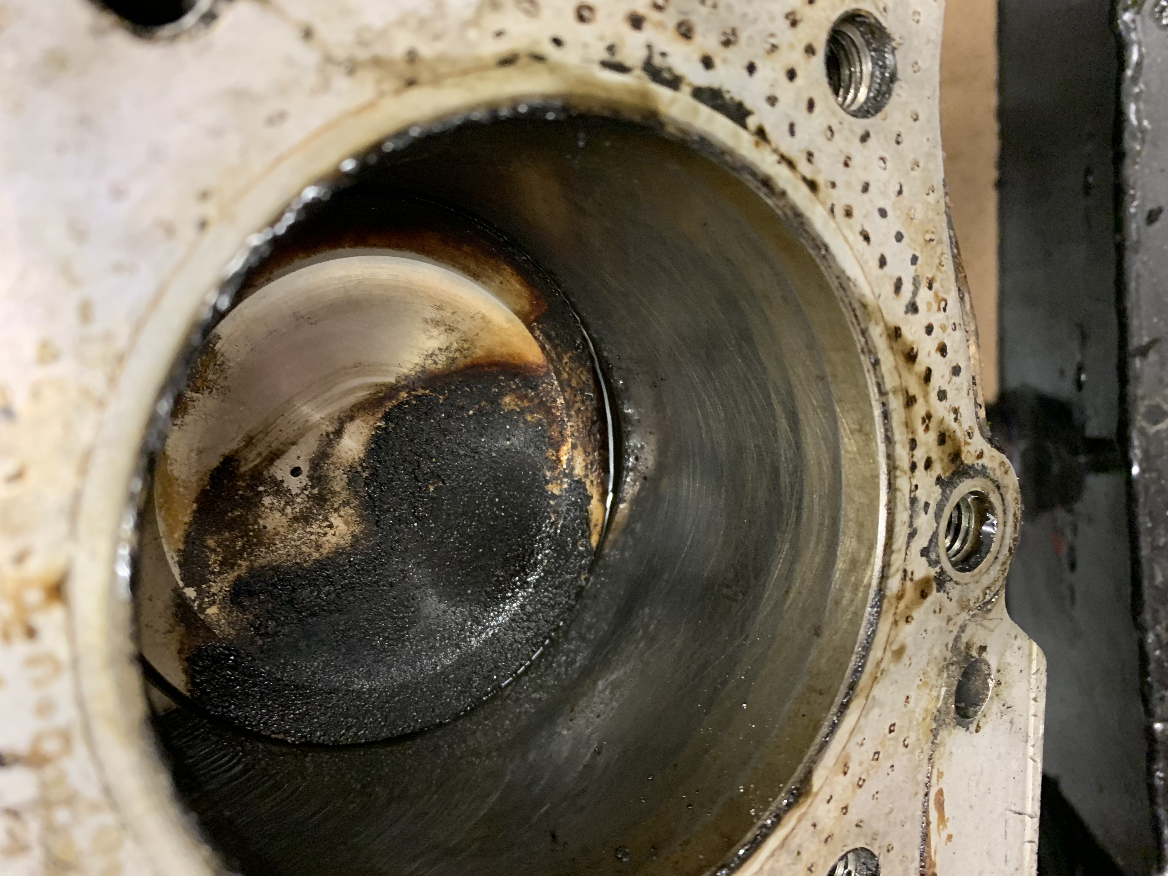

I’ve just pulled the head and as per photos there is significant carbon build up on piston on the inlet side. The chambers across all the heads look very black.

Thanks to all for the posts. I forgot to post the pics. Here we go

Lay the head on its back and fill the chamber with liquid. See if it drains out.

atkinsal wrote: Wed Oct 04, 2023 4:25 am Thanks to all for the posts. I forgot to post the pics. Here we go
Were the other 3 piston tops so clean when the head was removed or have they been cleaned?
Bit weird really, one seems too dirty but the others seem too clean particularly given the colour of the heads.
Looks a bit like the exhaust possibly leaking and letting burnt gass back into cylinder.
Has engine recently been rebuilt?
