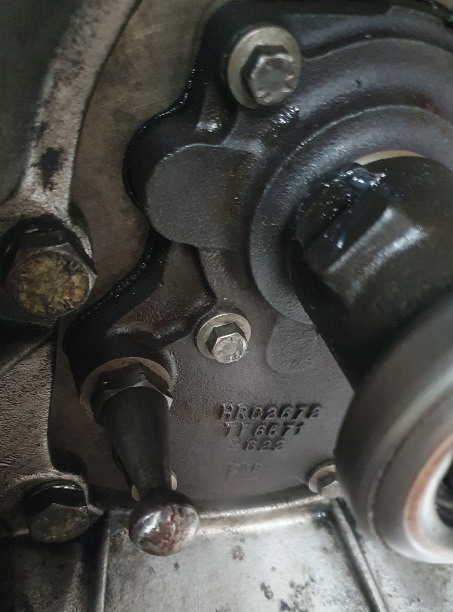

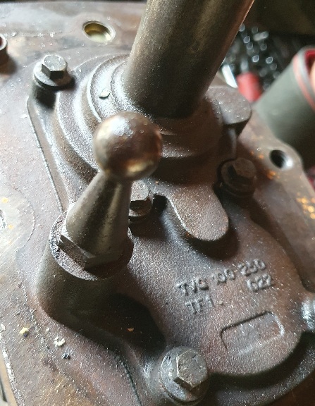

Sorry if I didn't explain it very well - these photos may show it better!
Old gearbox, with a taller pedestal which the pivot pin screws into: New gearbox with shorter pedestal, effectively moving the pivot point 20mm closer to the gearbox. I think I've probably had too long a pivot pin originally, hence having to use a short TD5 pushrod to get clutch operation. I've fitted the gearbox now, and certainly get clutch engagement and disengagement. Yet to try driving it as a fair bit of reassembly needed, but no sign of a problem yet...

I have swapped them, but the difference is in the pedestal which they screw into. But I *think* it's going to be OK with the 118mm pushrod.

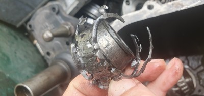

This whole thing has been a pain from start to finish! It started when the gearbox developed an oil leak which I traced to the rear output seal. So I changed that, and it no longer left a puddle when parked. Happy days, I thought, and didn't check the level again. 9 months later I'm driving down the M40, 150 miles from home and the gearbox suddenly seized up on me!. Locked the rear wheels and stalled the engine, which was rather exciting. So I dipped the clutch and coasted to the hard shoulder, to wait several hours for recovery. I hadn't eaten for 11 hours, but the only food I had was raw burgers,which I wasn't *quite* desperate enough for just yet. I did however have a disposable barbecue...
My fun was almost stopped by a Traffic Officer stopping, after a car on fire had been reported. So I hopped over the fence and once on the adjoining footpath there was nothing they could do
It turned out there was a second oil leak from the breather, which only blew out whilst moving and hence didn't leave a puddle, but was enough to run the box dry after 3k miles. The input shaft bearing had certainly seen better days, and it was clearly this which had seized!
The input and layshafts had been softened by running too hot, so effectively scrap. I then bought a bargain R380 box, which turned out to be for a diesel and hence the input shaft too long, fouling on the crank and locking solid. The transmission tunnel was never designed for the gearbox, so installation is tricky to say the least. 3rd time lucky with this one which I was hoping would be a straight swap! Still, looks to be a relatively minor issue, and may even be on the road this weekend.
