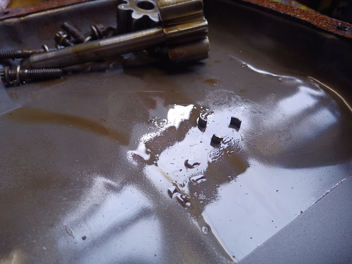

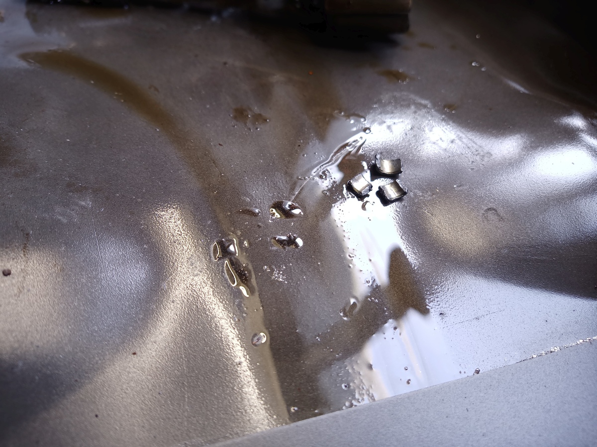

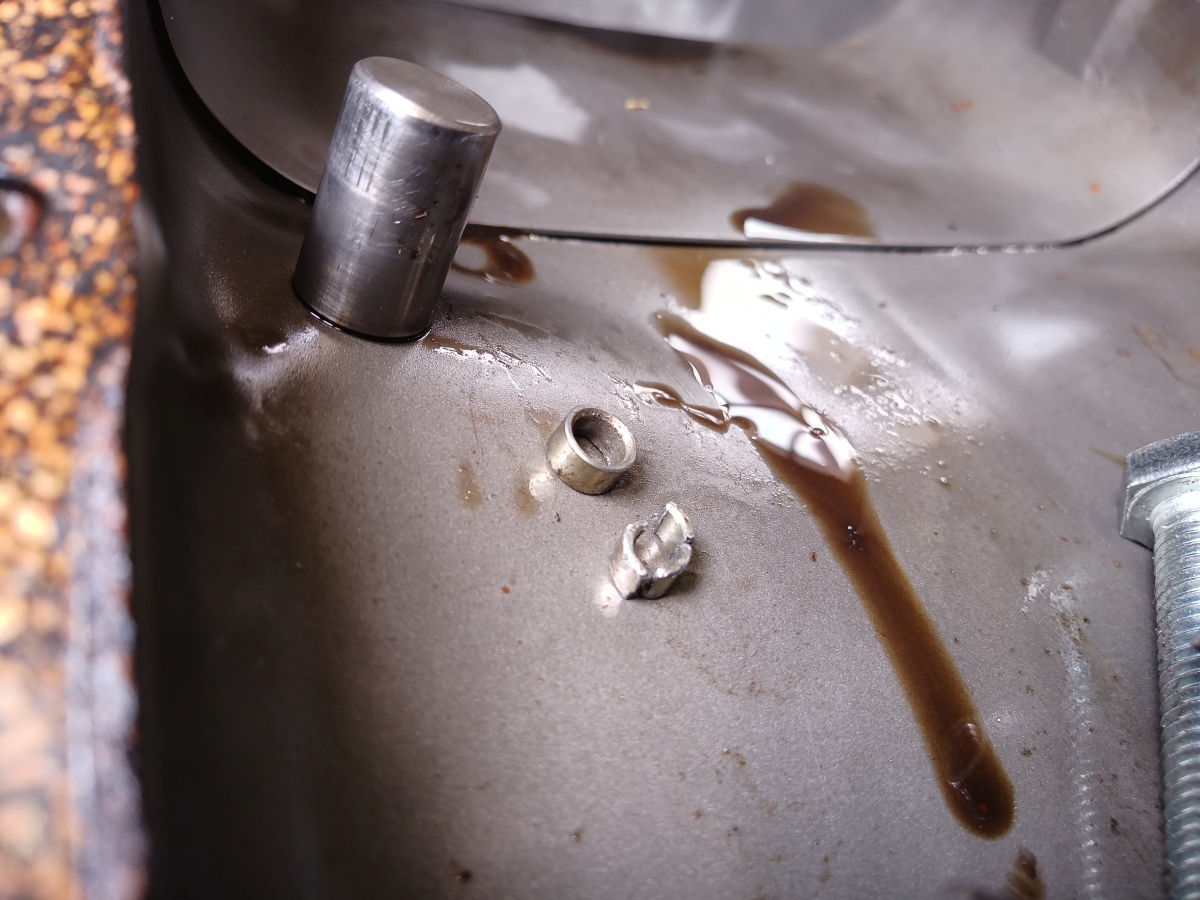

Hello friends,
happend again ...
short story:
Oil pump relive valve stuck,
big end bearing fault, crankshaft ok,
please have a look at the pictures,
I found a strange broken ring/sleeve,
the metal surface shines like galvanized brass color,
the outer diameter could be 8mm, I am not sure if these 3 pieces are the only ones?
see Attachement
does anyone have an idea where the sleeve came from?

It's a little like a valve collet, but it isn't
anything from the dizzy ? pump drive at the dizzy ?
can't think of too many small round parts
Re: big end bearing fault, found strange broken ring/sleeve
My first thought was a collett, but they are split into two, so as Stevie says, not a collett.
I can't think of anything else they could be!
Maybe ask the engine builder?

I also thought valve collet, possibly from more than one valve.
Any idea on material? Is it magnetic?
Based on the fact you've found "sand" in the engine previously it could also be something which doesn't belong in there which the un-professional engine builder allowed to migrate from elsewhere?
Any chance of a closer picture with the parts cleaned up?

Even looking through parts, not too many round cylinders
https://www.lrworkshop.com/diagrams/lan ... e/109in-v8
Core plug in end of rocker rails ? ( or other core plug ) but it doesn't look like a core plug.
part of dipstick tube ? seems unlikely.
locating dowel for something ? that clearly isn't where it should be ? can't think of any so small.

The metal sleeve on some rocker cover gaskets ?

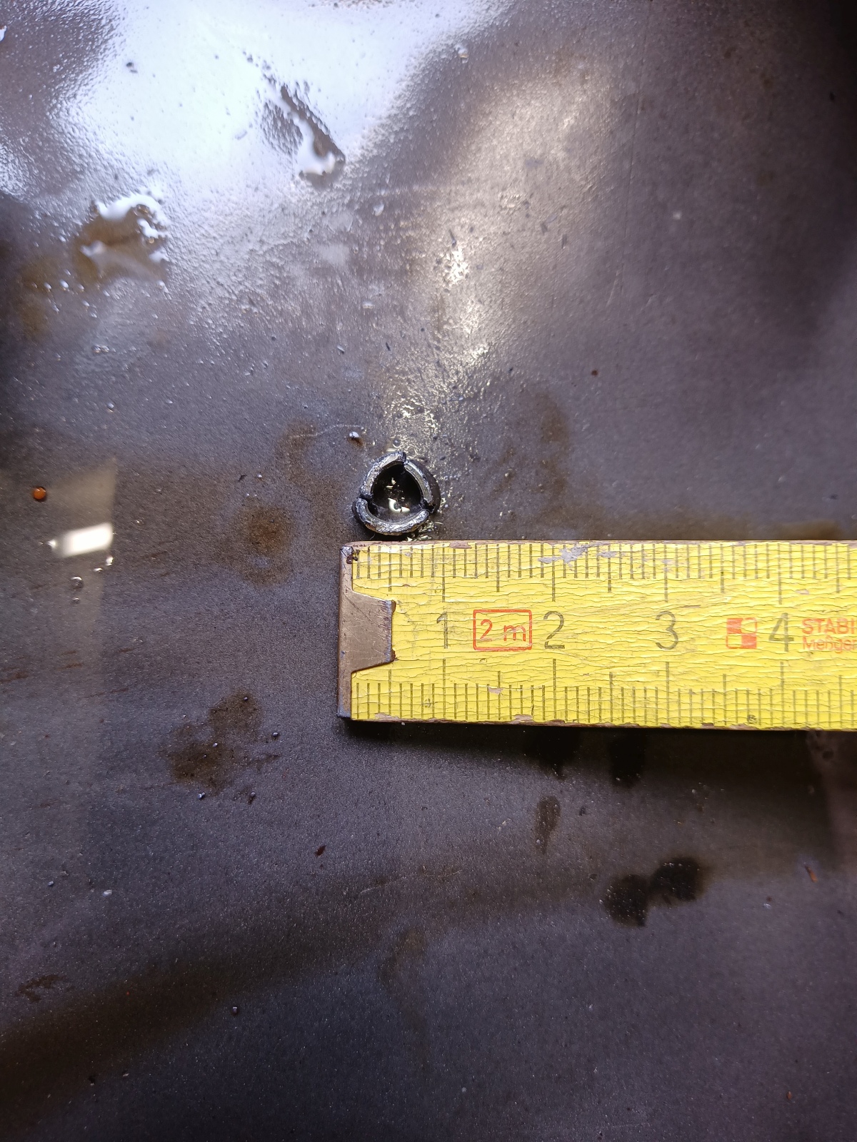

Hello Blown v8,
you are right!
it is the sleeve out of the rubber sealing of the valve cover!!!
many thanks!
hopefully my cam ist ok, I will check for,
Your Frank
