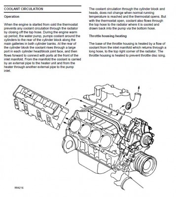

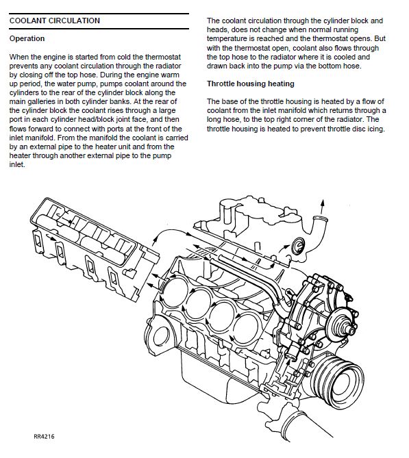

Posts: 982
Re: Water flow around cylinders and heads.
Think you got there in the end:
Posts: 5077
Yeah, you've got it.
If the rear ports on the heads were not blanked off, then the water would come up from the block straight into the inlet manifold, missing out the heads entirely!
Once in the inlet manifold, it either goes forward to the thermostat, or out of the rear to the heater (depending on manifold!)
