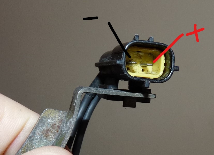

I am doing this, can you tell me what way round the wires go from the module into the plug on the dissy please, I have made up a screened cable with blue and red cables the same as the remote module end, with a three pin econoseal plug that end, I need to know which of the two black lead coming from the dissy pick up goes where ? see photo, thank you.

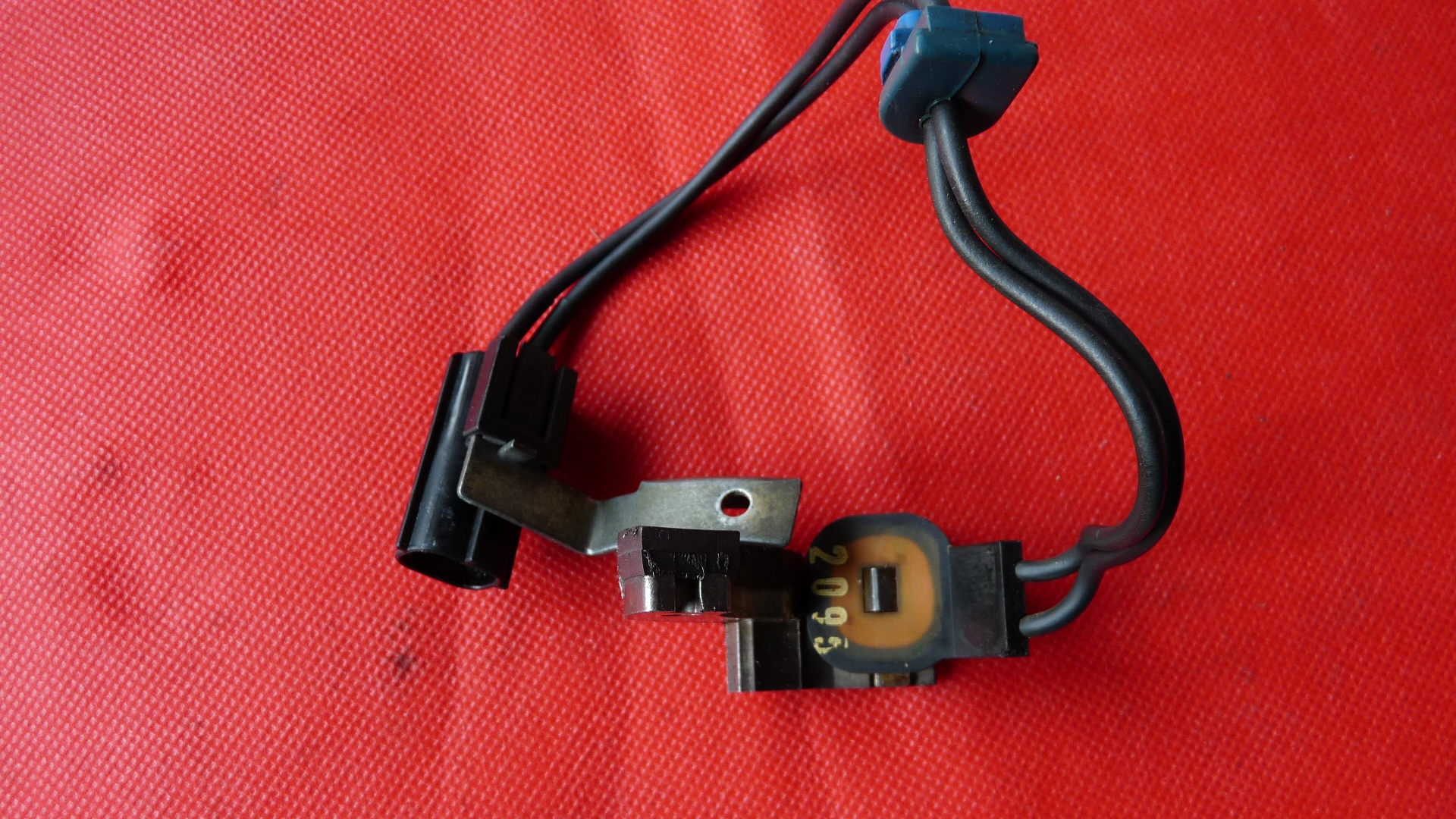

Thanks Dave and Quinten, solved the problem thanks to Denis Perrott ( " Devonman" on here ) he suggested I looked at a dissy with the module on the side and trace the wires, for everyones future reference see picture.
