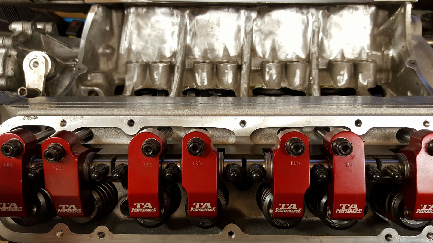

im running TA heads and rockers

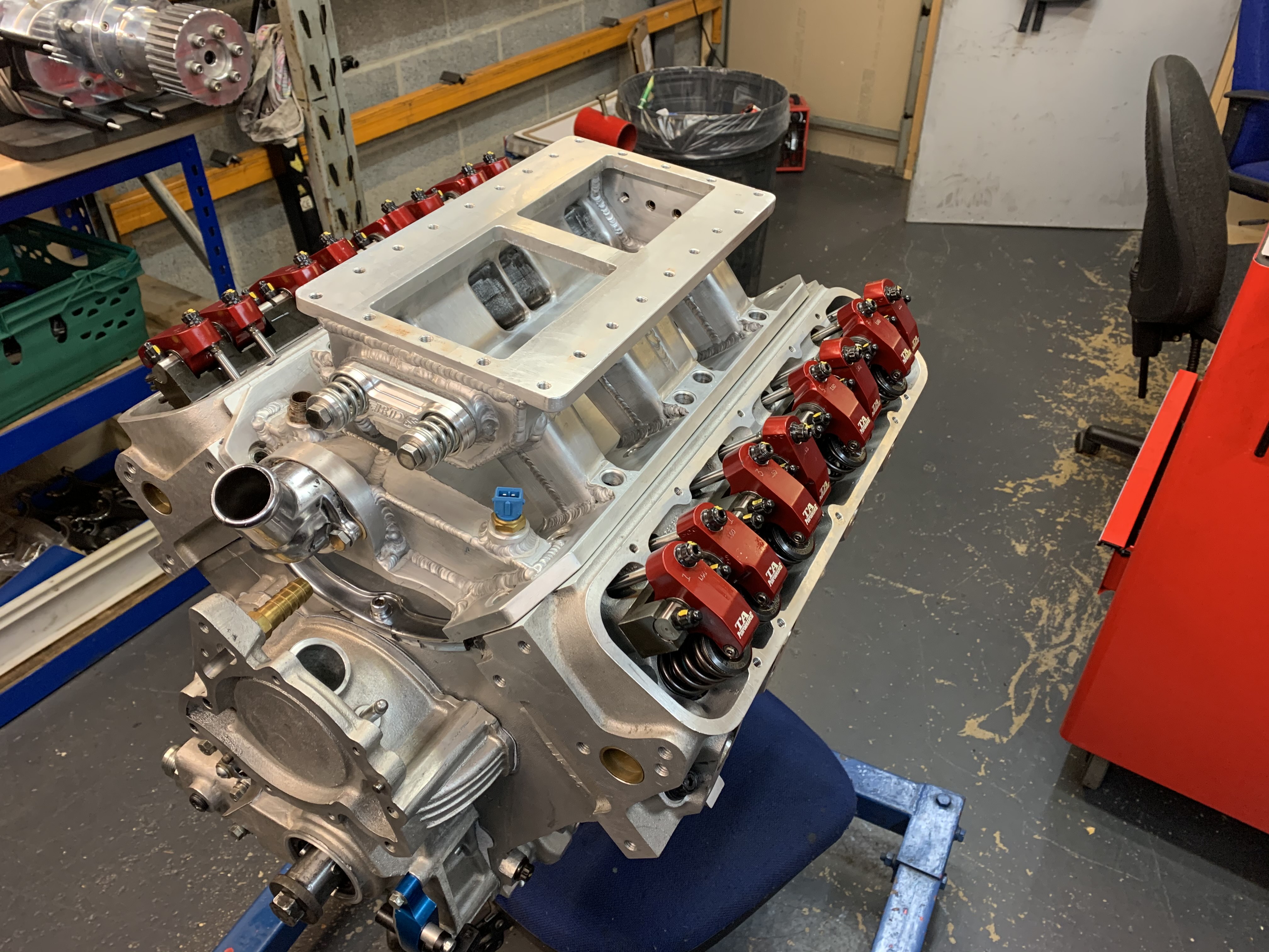

My current engine with Wildcats.

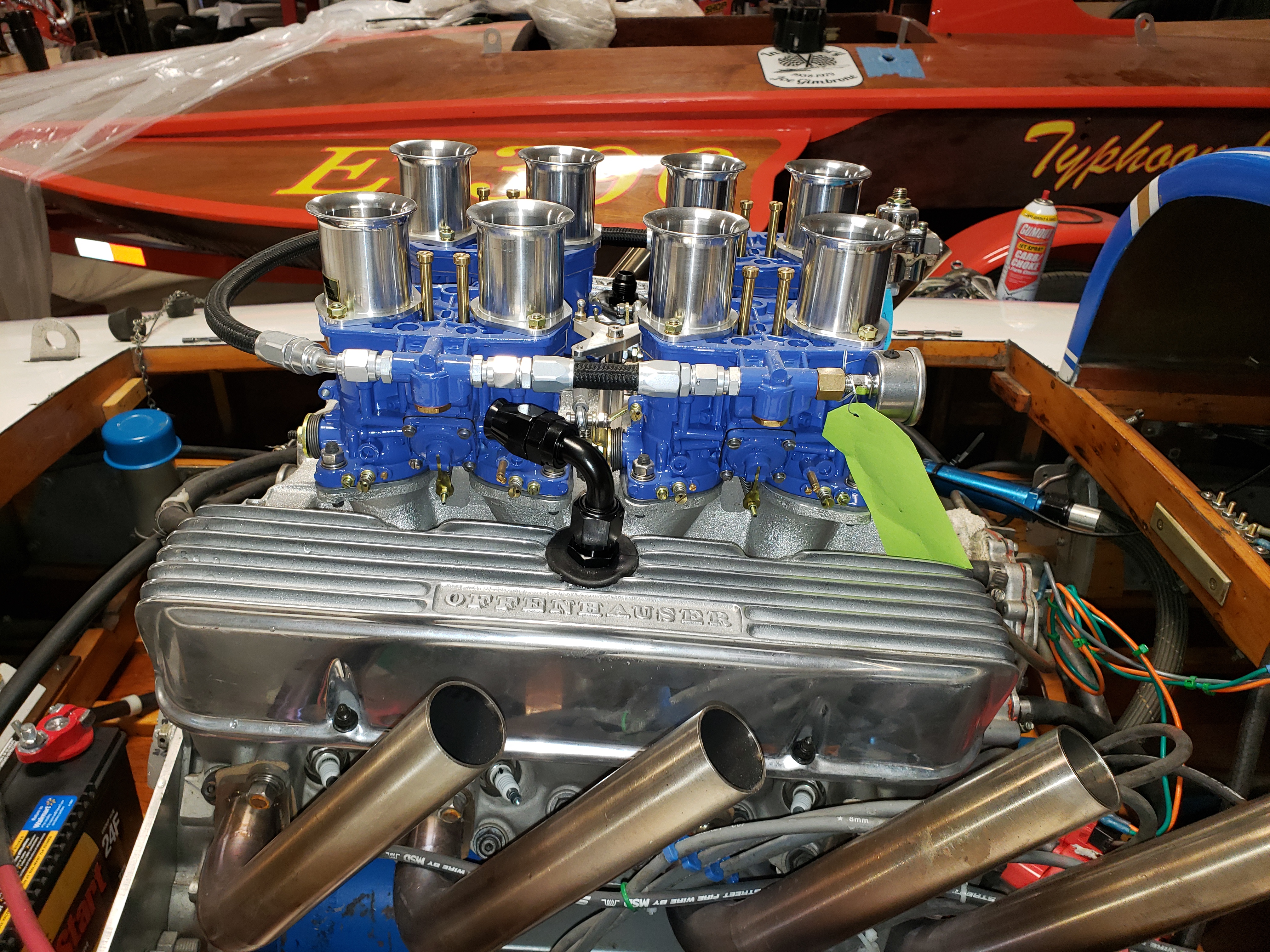

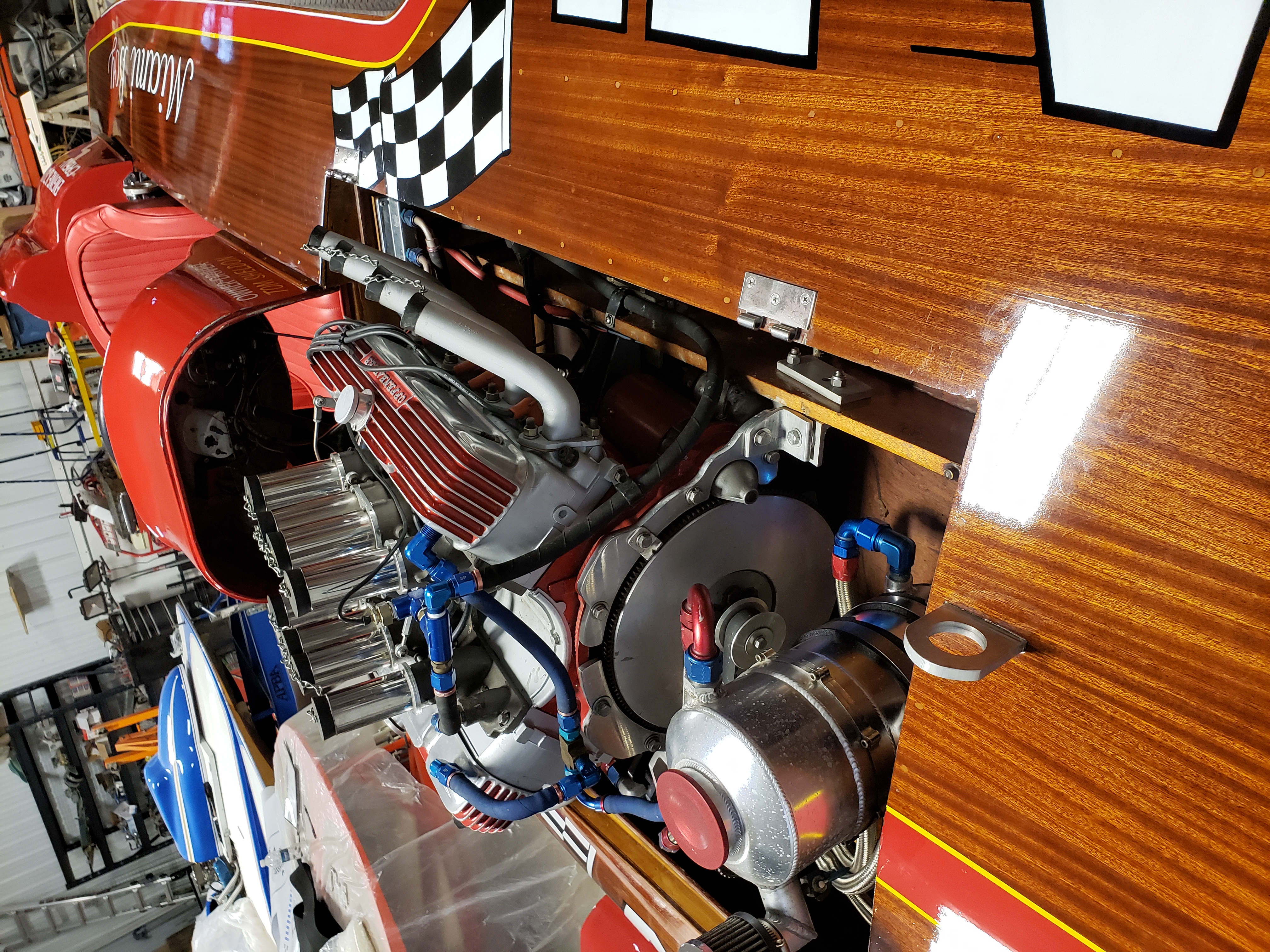

Here is a few of my hydros. All vintage. The blue is a Buick 215 with Inglese Webers just before the ignition upgrade. the red one has a vintage hillborn mech injection with a dry sump system and extensive head work done. That engine will probably be swapped with a Rover/ Wildcat

Posts: 567
Re: TA / Wildcat heads
Are you taking the drive from the front of the engine? It looks as if it is facing backwards.
gp56
Posts: 6
Joined: Wed Dec 07, 2022 1:41 am
Post by gp56 »
Yes on these boats we have a chain coupler off the front crank eliminating the damper. When you start the engine you are already turning the prop. Our larger GP boats have Casale Z Drive boxes off the flywheel that have a disconnect feature.

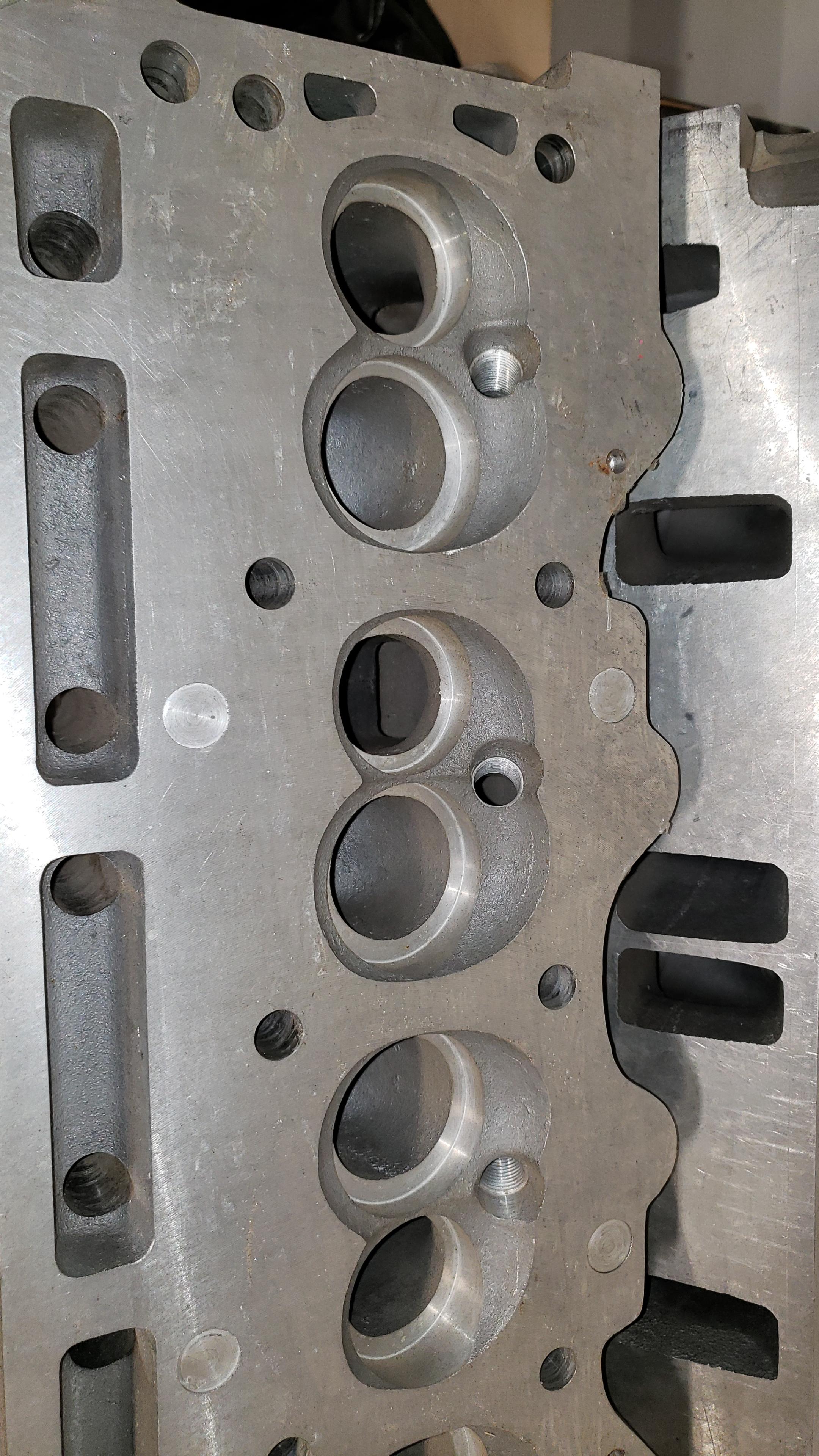

Mine are early Ian Stage 1 heads. the valves appear to be sized as yours. I have the old valve covers as well. That info really helped. I was deciding should I sell or finish these heads but after researching them they appear to provide great performance. Probably going forward with final machining and build up. Thanks for the info!!
gp56
Posts: 6
Post by gp56 »
Here are my heads
