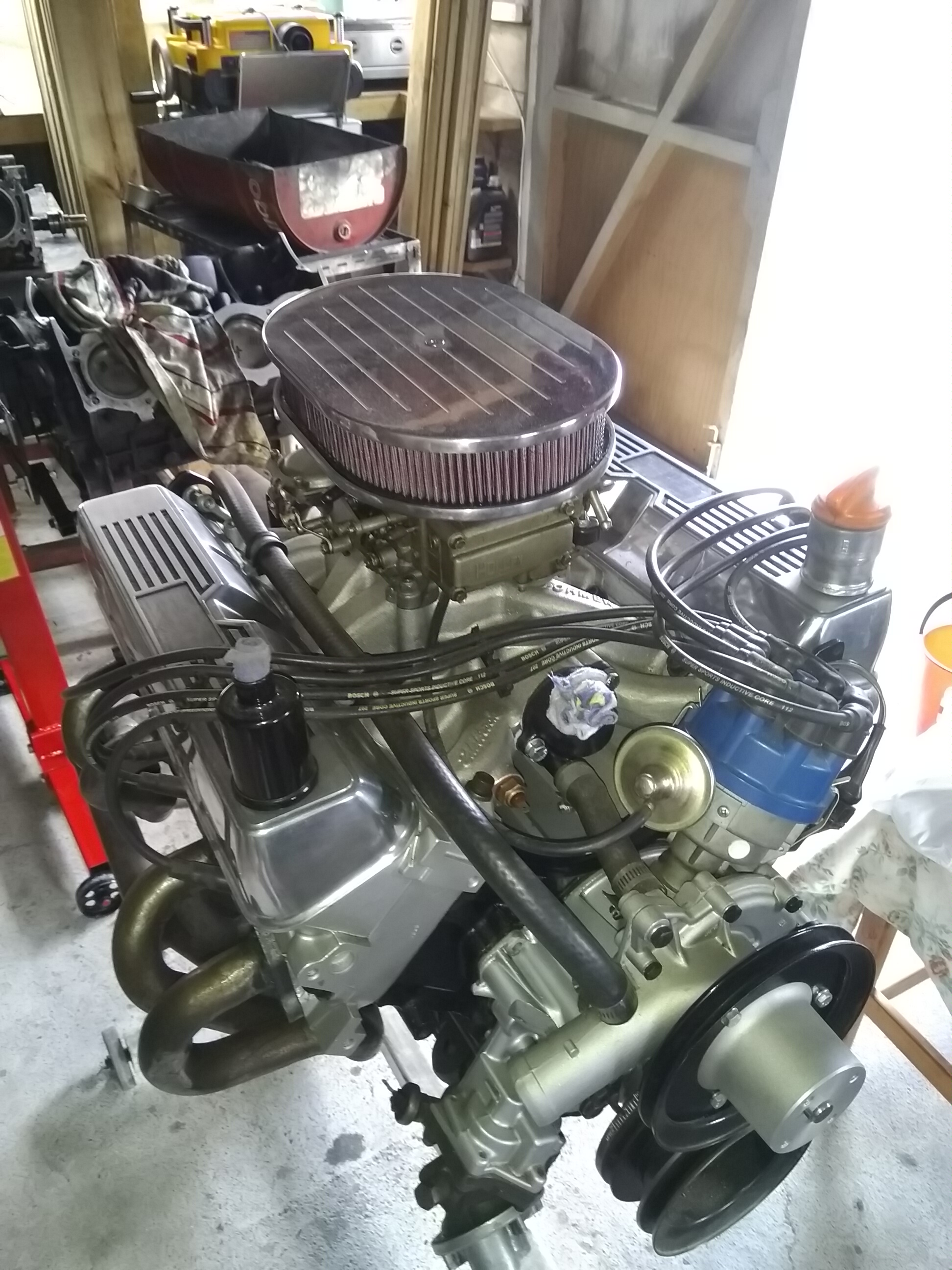

Makes me think tho ,not so good pic of the exhausts (engine is a 3.5 I have parked in favour of the 3.9 serp motor ) but I had decided to discard these because the primaries are to small but they are ,at a rough measure up , bigger cross section than the cast stock ones , they are def bigger that the port opening on the heads . But the cast ones are tidier... :)
